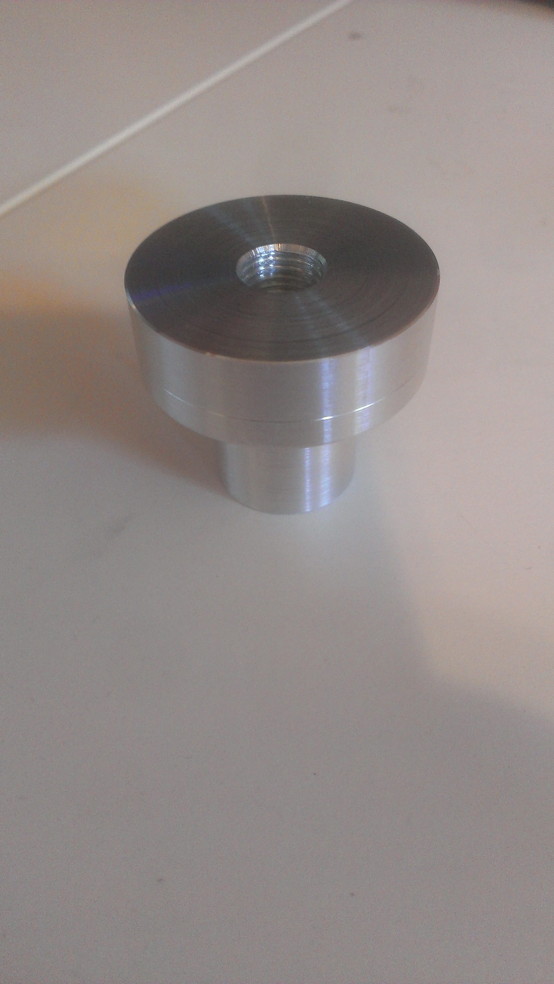

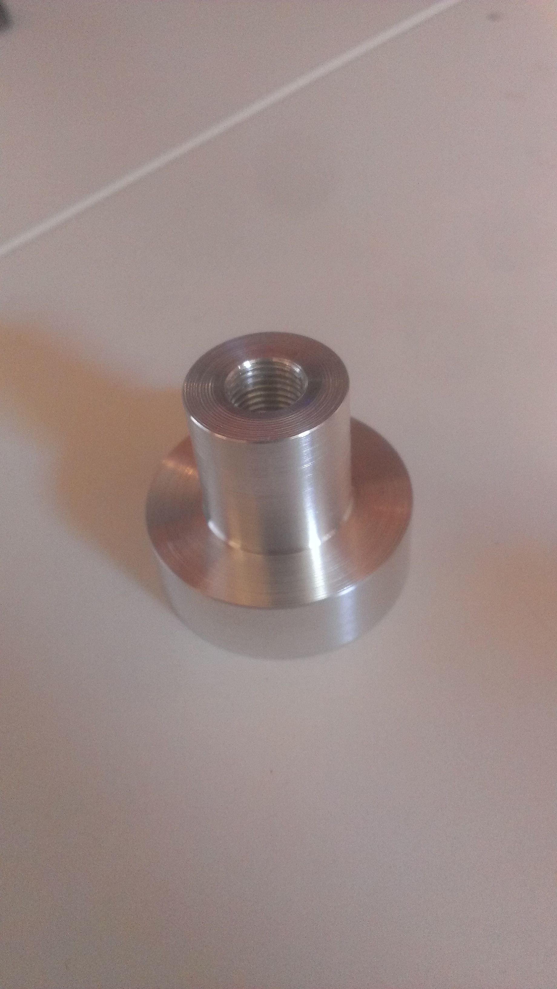

So FINALLY after so much searching on the internet I found a shop that could make the part and I now have the finished prop hub. I went to the machine shop this morning and the guy who works there said that he could easily make one. So I showed him the 3D model I maid and he sketched a quick drawing and then went to work. He actually let me watch him make it and talked me through what he was doing since it's the first time I went to a machine shop. So I was standing there for about 1 1/2 hours and I got to see him using the manual lathe and I have to say it's pretty cool getting to see the guy get a solid piece of 2025 aluminum that he got from a scrap metal bin and turn it into the hub. So I can now get some more work done on the motor like taking the muffler to a welding shop so someone could weld in the outlet tubes.
I took a photo of the finished hub.
-Sam

Good job - congrats. But, you could have the machinist add some flats on the smaller shank so you can use a wrench to tighten it on. It would be a shame to use vise-grips on that nice surface.
Also some knurling added to the prop surface face will help keep the prop from slipping. Just practical hints offered in great sincerity.

What I often do is make a hole clear through the large diameter part of the prop hub, and then use a Phillips screwdriver through the hole to tighten the prop hub. And yes, knurling the face of the prop mounting surface is almost a must. At this point, you could just glue some # 220 sandpaper to that face to help keep the prop from slipping. That will work too.
I strongly recommend using Loctite both on the threads where you thread the prop hub on the engine, and on the stud you will use to hold the prop on. Loctite is not needed on the prop nut itself, and not desired.

Good thought on the cross hole like a safety prop hub for tightening the hub to the engine. But sometimes it is nice to be able to keep the hub from turning while you tighten the prop nut. And good you mentioned using a STUD with Loctite for the prop rather than a bolt. Studs are available from auto rebuilding shops. A disc of drywall sanding mesh between the prop and the hub will keep it from slipping. The mesh having grit on both sides negates having to glue it on the hub and makes t easily replaceable. JMTCW.
Sincerely, Richard

The flats are a good idea but I kinda wanted the smooth hub look since the engine is going to be exposed. I asked the guy if he could knurl the top but he said he needed a special machine but he didn't have one. I cant really complain to much since he made me the part for free.

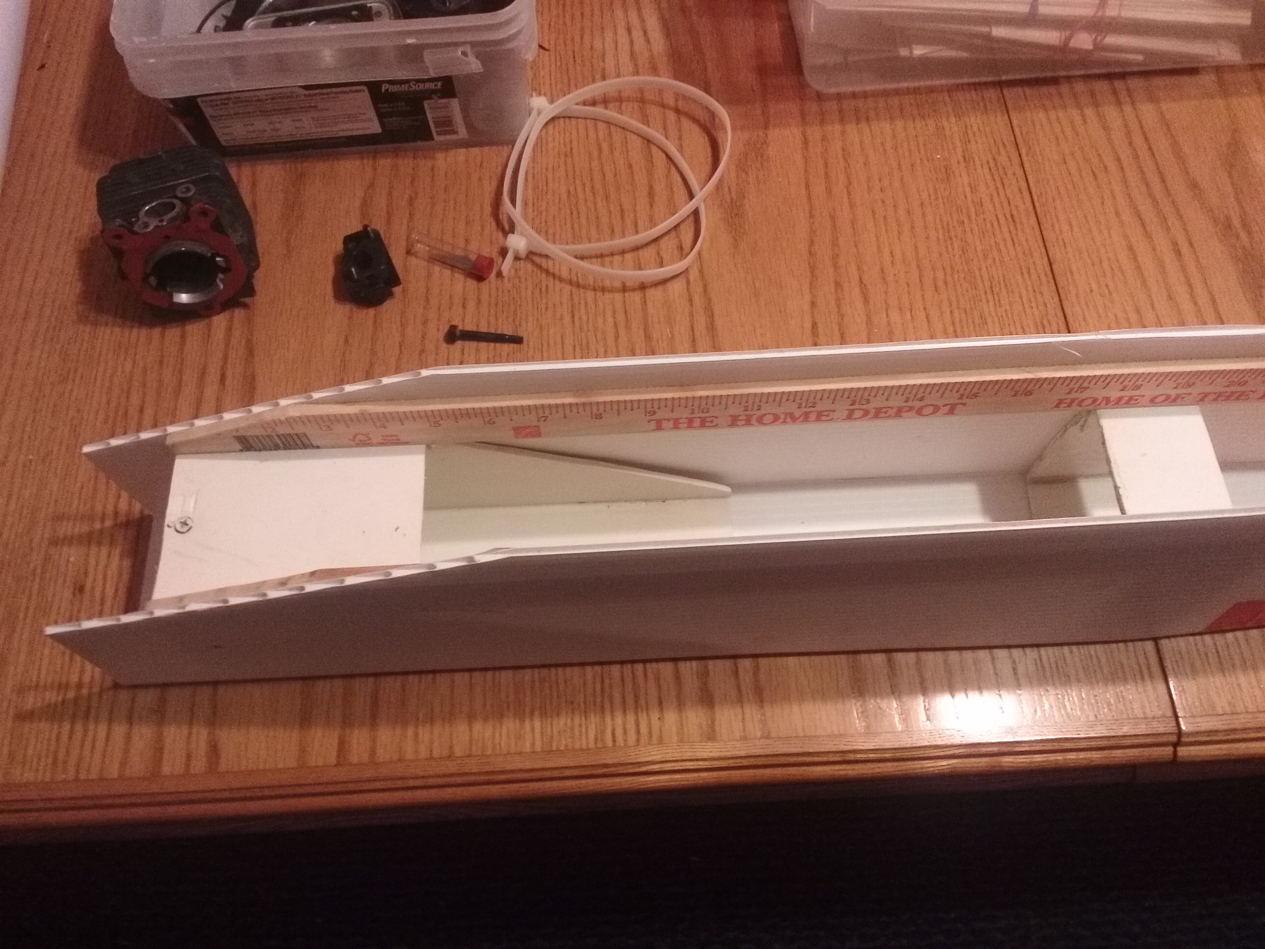

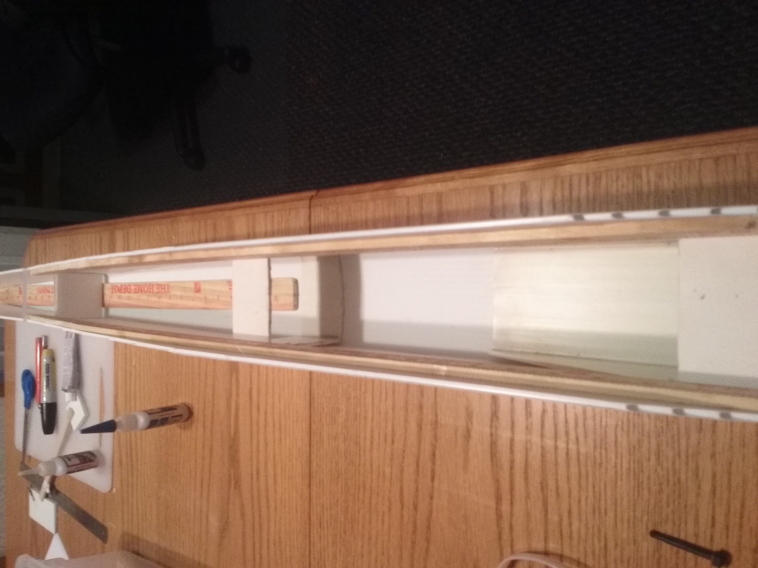

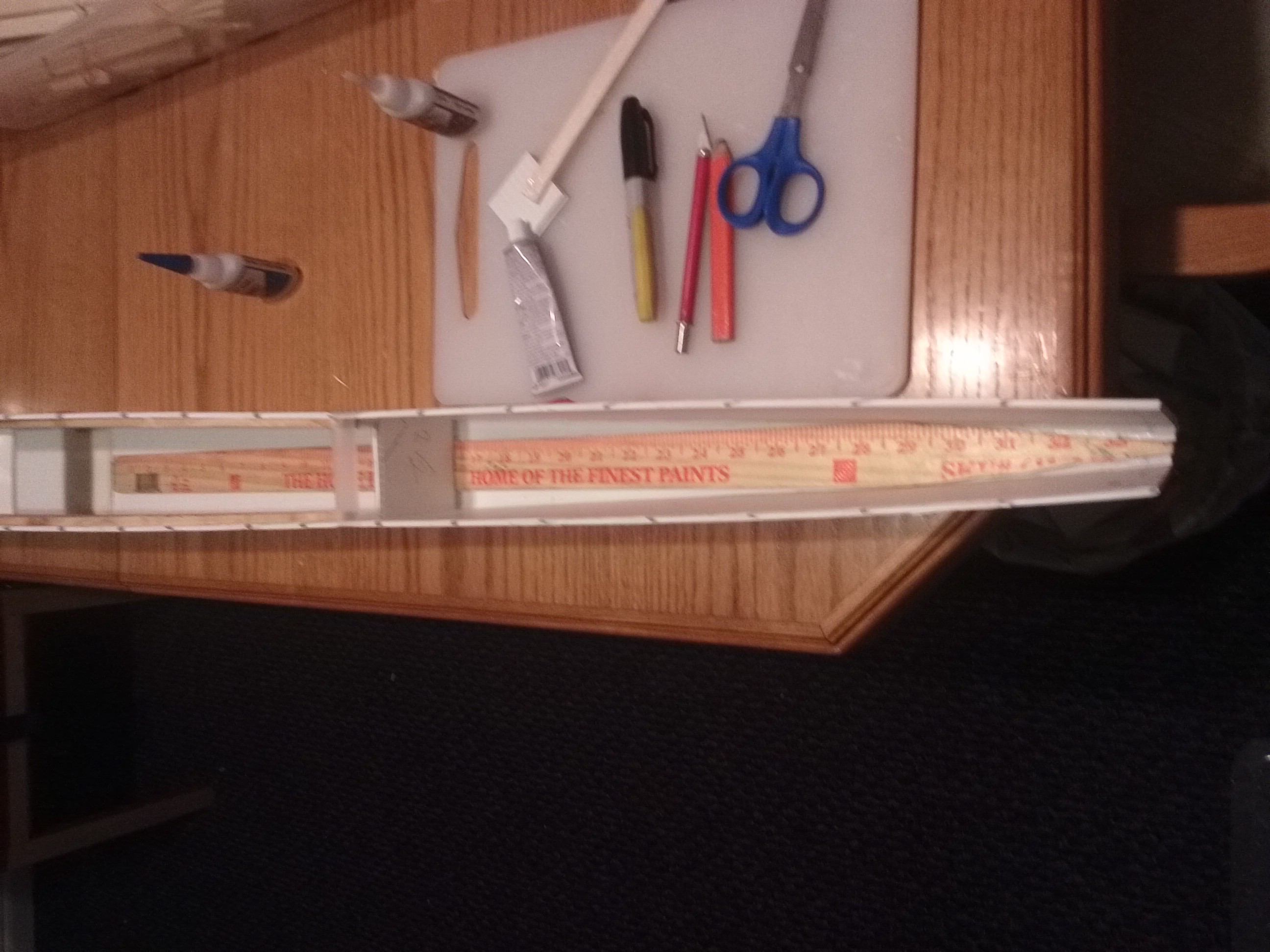

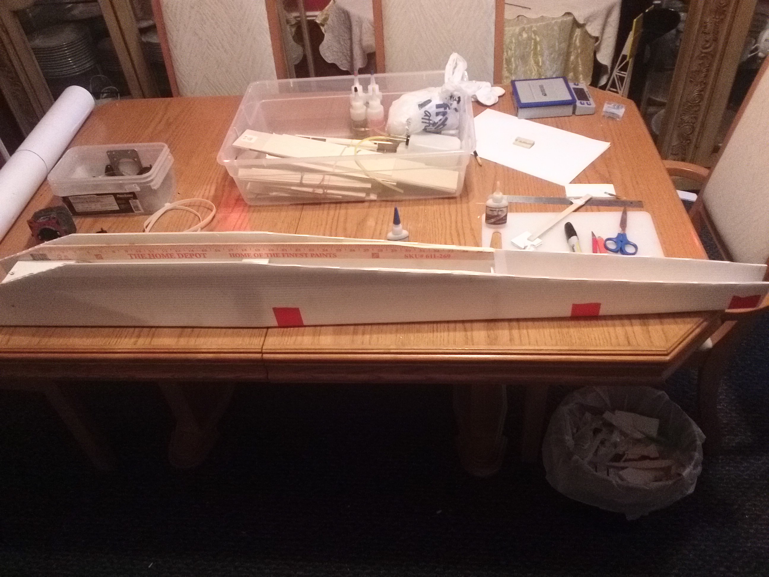

I got a bit more done on the fuselage. I glued in the gutter pipe fuselage frame and glued in the yard stick on both sides and the tail. I had to go to a dollar general to pick up some goop to glue the rudder to the fuselage but I ran out of time to actually glue it in so I'll do that tomorrow. I also have to get the homelite crank shaft removed so does anyone have any tips on how to do that.
thanks
-Sam

He should be able to cut and thread it by only taking off the magneto flywheel and not disassembling the entire engine, which is what I highly recommend. Be sure it gets cut far enough beyond the magneto to have plenty of threads (but not too many) to engage your new prop hub securely.
(A good way to keep the engine from turning over while you are threading the crankshaft is to put the piston near the bottom of its stroke, and then insert soft cotton rope in through the spark plug hole. Then when the piston goes up, it hits and compresses the rope and the crank stops turning, allowing you to thread the shaft.)
AV8TOR

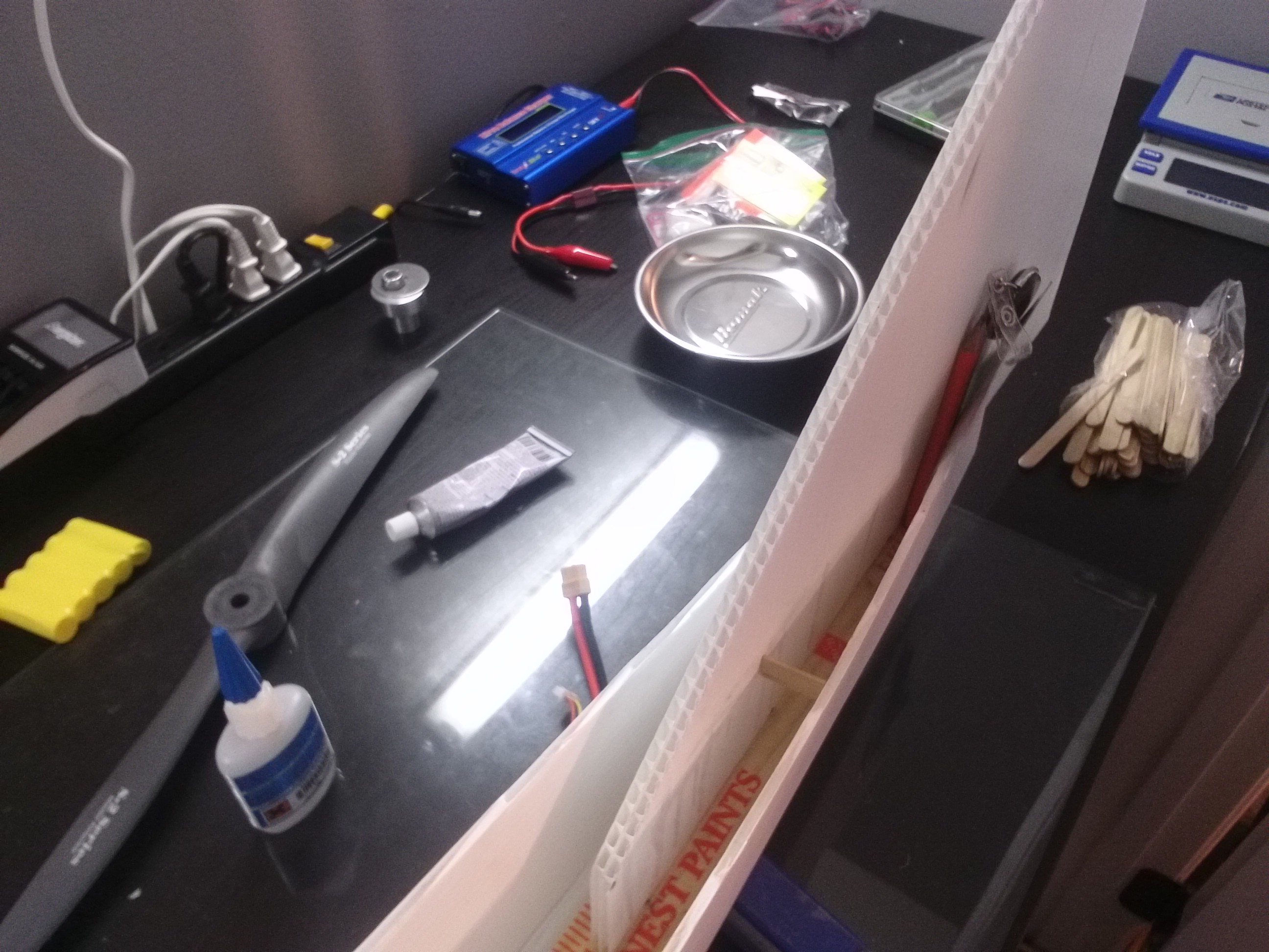

Next time I go to a hobby shop i'll pick up the starter cone and insert and use a makita drill. Also what do you mean by "prepare yourself for starting the engine". Getting comfortable flipping the prop quickly and being able to quickly move my hand( or the chicken stick) away from the prop. I called the machine shop but no one picked up so I'll just call them in the morning to see if I could go. I think in the afternoon they leave the shop because both times I called after 6pm no one answers but when I call before 10am someone always picks up. I got the rudder glued in but the glue is still wet but it should be dry by tomorrow morning and it looks like the servos arrive tomorrow. Lots of progress being made.
-Sam
