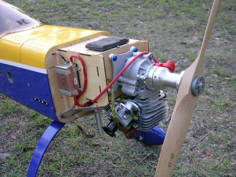

This is my latest conversion engine. 45cc chainsaw, Chinese No Name Brand. Paid $130AU + postage. Not bad really.
Was a bit of a gamble as I had no idea if it was going to be any good. It was a bit sad chopping up a brand new chainsaw
that had never been started. Plane is an ESM Katana 2m and weights around 14-15lbs.
These are some early shots of the the engine install before muffler and carby manifold was made and fitted.
Cheers KMM

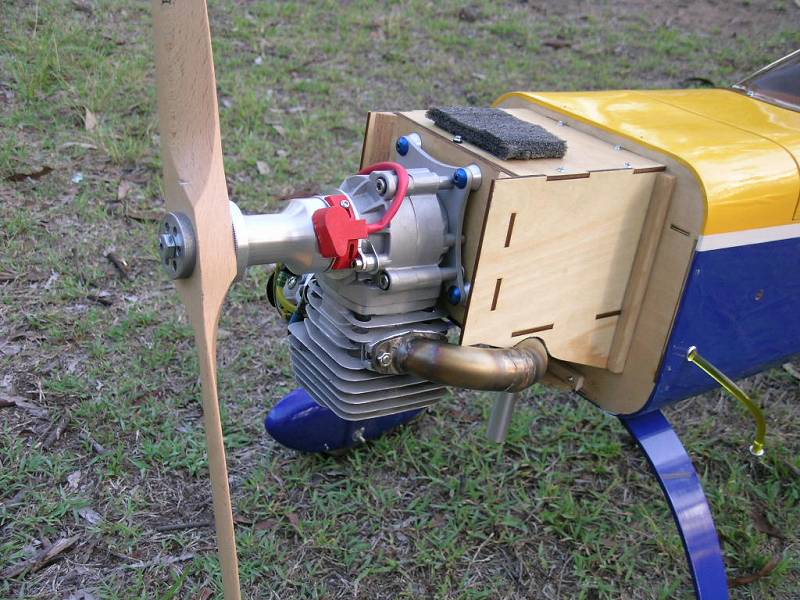

Ok, here she is, install completed and ready to run. I'm pretty happy with it. Made up my own carby adaptor out of
aluminium as the carby mounts are lost when cutting the cases up. Decided to put a canister muffler, with header
pipe on it as the fuse is made for this setup. Bought a KS canister and a header pipe kit as they were easily obtained.
Header pipe kit comes with 3 90 deg bends and a couple of straight pieces so you can braze or weld it to almost any shape.
After running it a few times, had to beef up the engine box as it nearly tore it off the firewall. I didn't know whether to
take that as a good sign or bad one. Was it the super engine pull or was it a S%#ty ARF. After beefing up the engine
box I gave it a few more runs and the pull felt very strong. I have a 20 x 10 Bambula wooden prop on it turning @ around
7000. Not too shabby. So I stuck it on my fish scale and she pulled 21lbs. Should fly it very nicely but until I fly it for
real I won't get too excited.
Cheers KMM

Thats niiiiice dude. Where did you get the exhaust kit and prop adapter from......and cost?. I really need the exhaust to adapt mine before I can fly it.
Cheers, Wiz

you know that cylinder looks A LOT like a crrc cylinder. and its 45cc too.....what do you think wiz??. im STILL working on my new muffler system....got the basics sorted but now the fun bit is trying to get it all together lol.
will post the pix when im done

It certainly has that look about it. crankcase is pretty different though. has the same velocity stack as the V2 as well.

ive noticed there is 2 switches on the same side as your ignition module. im wondering if one of them is for your radio gear and the other for your ignition system.
if this is the case then you will more than likely have the ignition cut through your radio gear. keep your radio gear as far away from ANYTHING related to your ignition system to avoid problems.
cheers
craig

I think one of those looks like a charging jack to me..

Spot on cdale03 the second is a charging jack.
Wiz, the canister and header kit I got from Ian Howard at Desert Aircraft Australia. Really nice guy.
Check out his Website and go to the DA Shop for all the gear. Here's the link
http://www.desertaircraft.com.au/Contents.htm
As for the prop hub, engine mount, carby manifold, pickup ring, I make all that gear myself.
I'm a Toolmaker / Fitter and Turner by trade. Have my own Lathe.
Also, the stack on the motor I just got from Tower Hobbies but I do admit the cylinder does look very
CRRCish.
Hardtop, thanks for the headsup on the ignition interference but as cdale03 picked out it a charging
jack. Never can be too careful though. Hey Hardtop, I don't think you fly at all, I don't think I've
ever seen you logged out of RCU LOL. Your just saying you're a flyer.
Cheers guys KMM[8D]

Nice work, and that looks like a nice, lightweight 45cc engine. Where did you source the engine?
That intake manifold is really nice looking, but you might encounter problems with hot starts with it. If so, just let the engine cool down for about 10 or 15 minutes and then restart. If you have room under the cowl, you might think of making a phenolic, or delrin spacer to isolate the carb from the heat conducted from the engine.
Let us know how it flies!!
AV8TOR

It may also help too on hot re-starts is to let the engine idle and cool down after landing. In cool weather heat soak shoud not be a issue. A thick gasket on each side of aluminum manifold should help also. Capt,nl

ive got the exact same manifold on my 45cc engine. i dont have aproblem with heat soak at i use methanol fuel lol
cheers
craig
