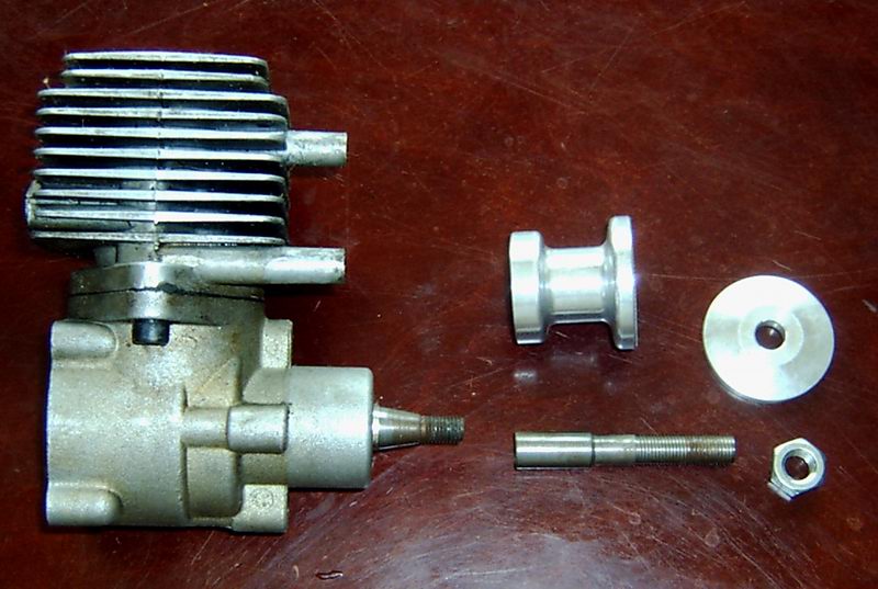

#696
#697

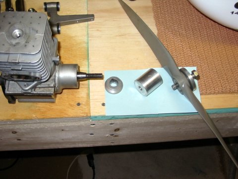

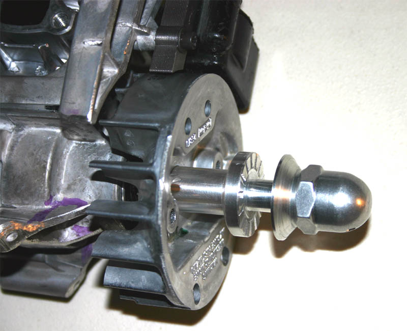

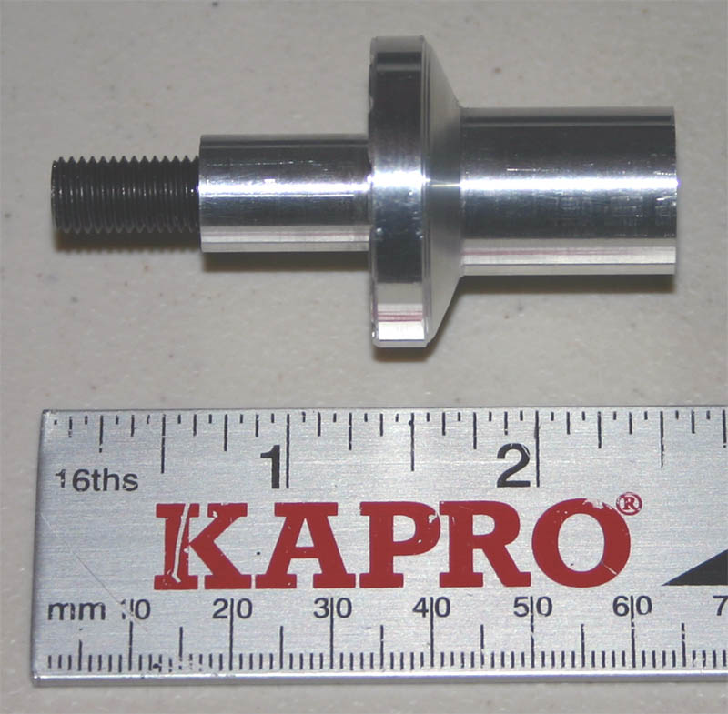

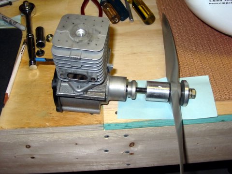

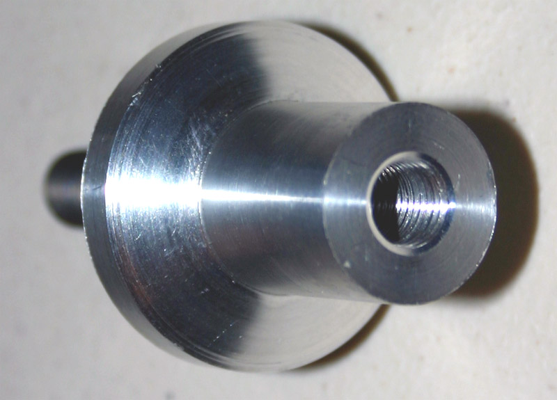

cal.45acp, I think I have your answer. At least if the taper on your crank is the same as a Ryobi. If so, what you want is a prop adapter from CH Ignitions for a short shaft Ryobi. It has a unique tubular through stud that goes through the prop adapter. The aluminum prop adapter itself floats on this stud, and is held against the the crankshaft taper by the propellor and propellor nut. It's a slick system for a very short shaft engine.
See pics.
I would like to add however, that I have used the same method as Capn John on many engines and it works fine. Just use a hole saw to cut out the center of the magneto, chuck it up and dress it round, and use it behind a prop adaptor designed for engines with magnetos.
Good luck,
AV8TOR
See pics.
Good luck,

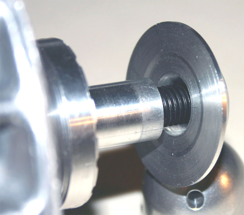

#699
Joined: Apr 2003
Posts: 1,490
From: Elk Grove, CA

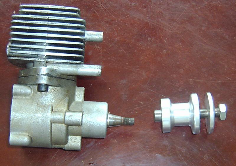

ORIGINAL: cal.45acp
I think I like the CH type prop adapter, steel to steel threads less chance of stripping out, I have a couple of ryobis that I am using weed whacker prop adapters on ( all aluminium) and they work just fine , but one has to be careful to not over tighten hub for fear of stripping aluminim threads
The hubs I made have steel machine screw that is mounted permamently on to the hub. Then I use steel nut for tightening the prop. Steel to steel, and I don't have a problem with thread. The obly drawback is that the hole in the prop must be 12mm
Here is my prop adapter (without taper, as this one was mounted to the flywheel)
#700
RysiuM: Very nice work. Also a nice set of photos to show the details. A picture is worth a thousand words they say!!
Best Regards Capt,n
