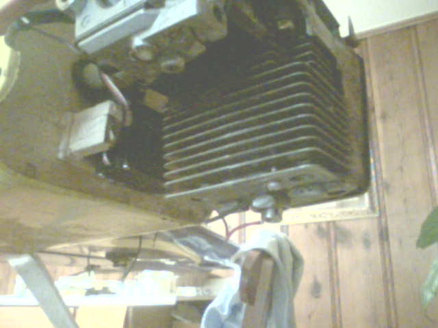

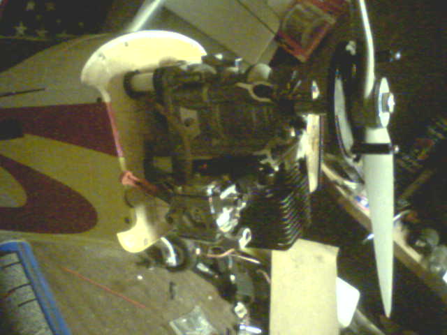

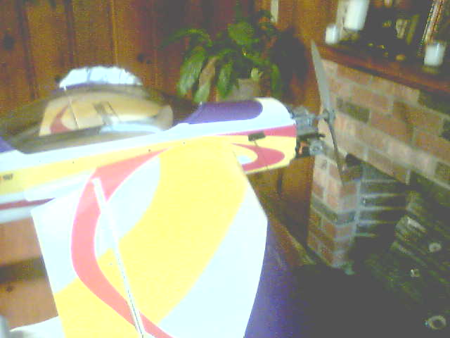

I just wanted to show all of you guy's pics of my H9 Showtime. I put a Stihl 26cc converted to GAS/Glow with a 15-4 prop. The engine has alot of power. I havn't flown it yet do to wheather[&o]. But when I do I will post a video of it. I wish I had a tach to give you more info on performance. I figure the engine is turning around 8500 or more rpms. Thanks for all of your input and knowledge you guy's share!
