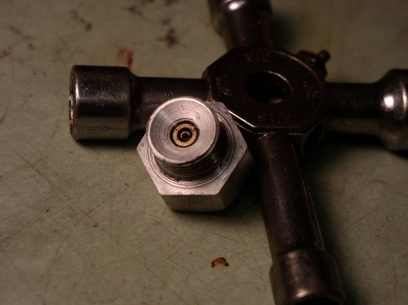

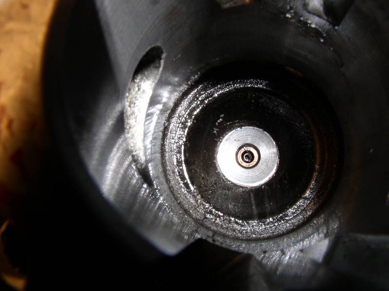

Hi, I have seen the glow plug adaptor pics. but how far does the glow plug protrude from the bottom of the adaptor? Does anyone have a pic of this. Just woundering how far the plug goes down into the cyl. Thanks
#1008
Posts: 242
From: altoona,
PA
Thanks for the pics. It looks like it is flush with the adaptor end, and the spark plug was protruding further into the cyl. Has anyone tried to do the same with the glow plug, thinking this may help with the running problems.
#1009
Yes it is flush, but compression seems about the same as the spark plug. I don't know a lot about this subject but I do know that you don't want sharp edges such as exposed threads in a combustion chamber that could cause detination. The one I'm using works great.

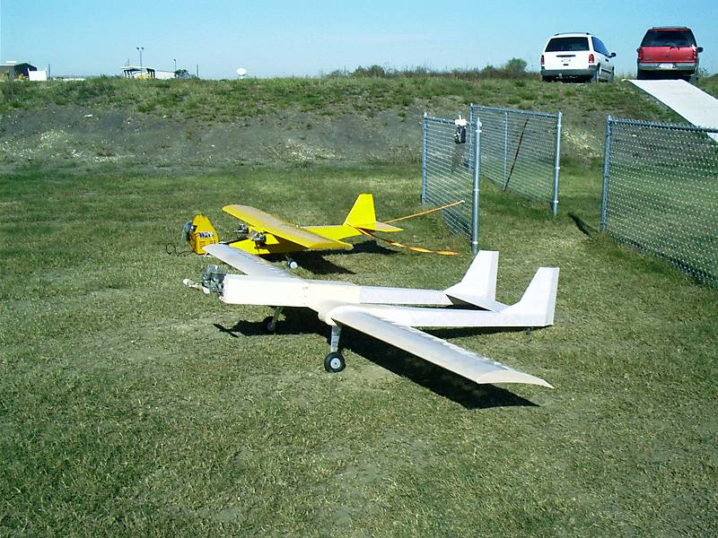

Hi, I have to coment on your plane. I love that look! Did you buy those plans or make them yourself? Looks like something I'd like to try for a engine testbed platform. Were could I get plans for it? Chris
#1024
Posts: 245
From: O\'fallon,
MO
Chris,
Glad you like it, thanks. The plane is of my own design. I have the plans on AutoCad and would be glad to send you the file. I'll have to warn you though, the plans are not in any kind of finished form. I usually don't try to finish plans for publication so many details are not included. Once I get basic structure and dimensions I do a lot of changing and modifying as I build. Anyway. you are welcome to the file if you want it.
Will
Will
#1025
wvarn1957: That is a interesting airplane. Can you post a couple more views. If you can include a view from above it. Thanks Capt,n
