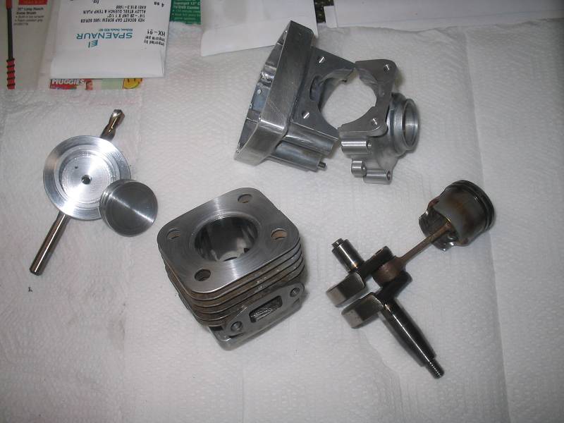

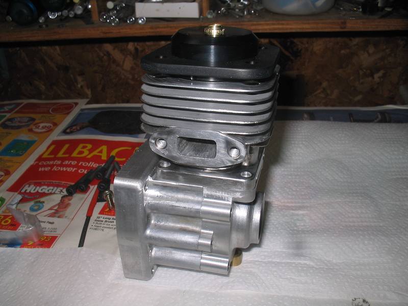

Yes, I'm in the middle of doing that now.
Another thought. Way back before glow, purpose built ignition engines as in O&R and the like had a very small spark plug not unlike glow plugs of today. What if the heads on our conversions used that sort of spark plug? Increased efficiencies due to smaller threads exposed to the combustion chamber? We may find out.

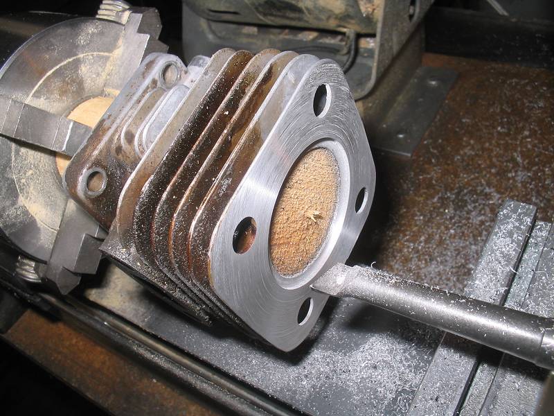

OK, that makes four heads to make. Got to stock up on some large diameter aluminum bar. [X(]

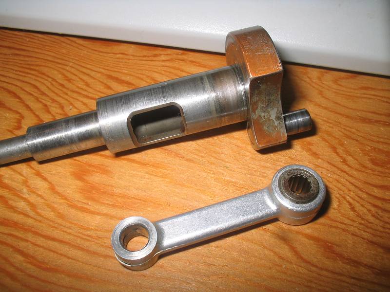

Have you guys discussed or thought about adding needle bearings to a glow motor so it will run with a much lower oil content in the fuel mix? Say 40 or 50:1.
This would allow for a simple methanol/oil mix compatible with the existing engine's parts/fuel lines etc and would alleviate the need for plug conversions, presumably timing issues would not exist and there would be no need for 'exotic' fuel mixes.

Air Hobbies offers conversion services for installing needle bearings on the ST and Moke connecting rods. If I recall correctly, Ralph Cunningham (rcignition) has performed this on the ST in the past, but does not any more. I believe the reason given, at least for the ST is that the crankshaft metal is too soft to run needle bearings directly on the crank pin. I also have read that some have ground down the crankpin and pressed on a hardened sleeve for the needle bearings to run on. I don't know how successful this approach has been.

Yes, here,
http://www.rcuniverse.com/forum/m_45...page_23/tm.htm
We have discussion about running diesel engines on a no ether based fuel. Later posts include various oils and low oil mixes. The issue is the plain bushed rod. The bushed rod at the crank is not so much an issue maybe because this end gets LOTS of fresh fuel/lube and the pin rotates through 360 degrees for effective distribution of lubrication. the pin at the piston end only oscillates through a shallow angle and does not get a lot of fresh lube circulating. This is really where we need a needle bearing. Illustrated is a rod from the old Webra .60 Blackhead. Note the needle bearing at the piston and not at the crank. This worked very well for many, many gallons of fuel. The piston pin wear is non-existent but note that there is ALSO no wear at the crank end. And the crank end is plain, brass bushed.
So the solution to a 50:1 mix, glow, gas or diesel seems to be in getting that piston pin a bearing of some sort. Here, http://store.microgroup.com/catalog/...talog_5-16.pdf you can get very small, thin wall tubing. The idea is to use the right size as the outer race along with needles made from .015 piano wire running directly on the pin. This would be full complement, without a cage and free floating. Maximum number of needles in a compact space. As such, we can make up a needle bearing for an engine as small as the Norvel .15 as discussed. But the problem is getting the tubing. An attempt to do so was met with minimum quantities, minimum billing etc. Am looking for another source.
But the Tanaka, with bearings all over, will be dieselized and 50:1 diesel fuel mixes will be tried along with exotic gas and glow fuels. I've even had luck in running an all Biofuel mix in the small .15. That's with NO added lubrication, only 100% Biodiesel acting both as fuel AND as lubrication. Sure enough though, the rod wore out at the piston end but there was no wear whatever at the crank end.

Hello Andy,
Micro Needle Bearings:
I don’t doubt you skills to be able to create a needle bearing, but I think you’ll find that it is much nicer to buy this product.
There are many sources for these bearing and I have attached a PDF showing a listing of micro needle bearings.
Micro Needle Bearing PDF: http://www.impactbearing.com/brochurepg30.pdf
Store Front: http://www.impactbearing.com/needlebearings.html
Note the smallest on this PDF is for a 0.118 shaft and the outer dimension is 0.256. It would be extremely unlikely that you could make such a precision bearing without complex grinding equipment to create these various components. This bearing is rated a 46,000 RPM.
You can look here for more Micro Bearing store locations: http://www.thomasnet.com/nsearch.htm...sec=prodsearch
I completely agree with you on the need for a needle bearing on the piston end of the rod. This will allow for the use of low cost fuels and much reduced oil content.
