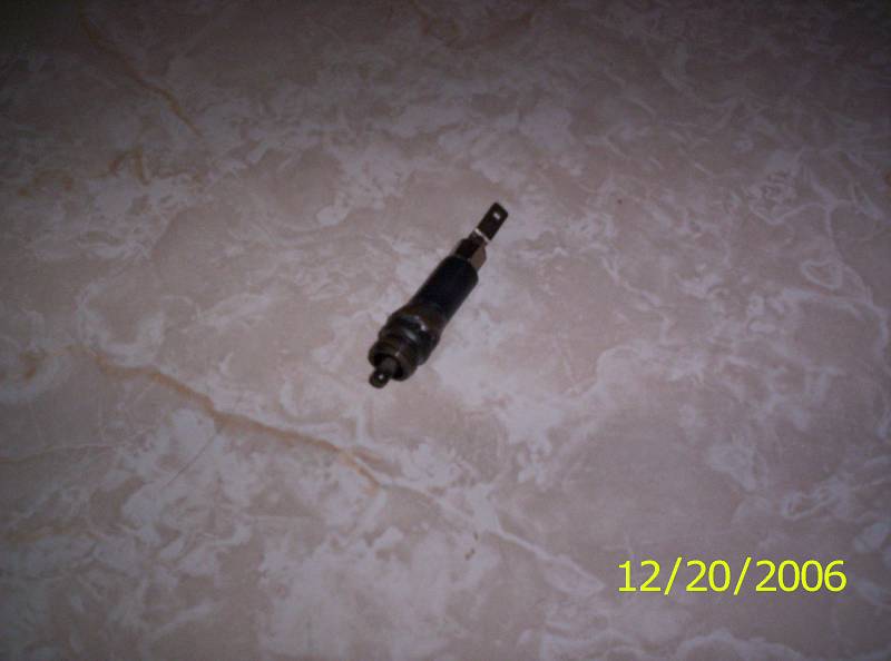

Ok, I made my glow plug but I used a auto glow plug instead of a model plug. on straight 2 cycle mix the motor would run but not good. On haft 2 cycle and haft 15% nitro, motor ran good except it seemed like it would lean out after 3 seconds at full throttle, tried adjusting carb I"ll try some of your brews next.
ID:	580712   Click image for larger version
