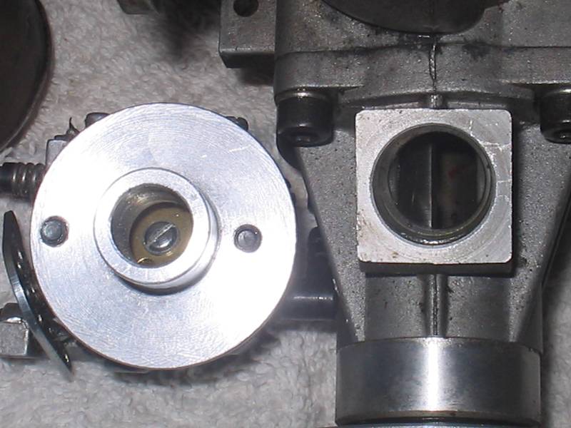

I had the adapter made to use a Walbro carb on my ST-3250.
The throat is the same size as the stock Super Tigre carb.
But is a lot smaller than a 32cc carb's throat.
Is this going to be an issue?
The throat is big enough to run the ST on glow fuel it should be big enough to run it on Gas-Glow.
Aero Nut what carb are you using on your Moki 1.8? I was thinking HDB 6B, I have a few of these.
What is the throat size of your adapter?

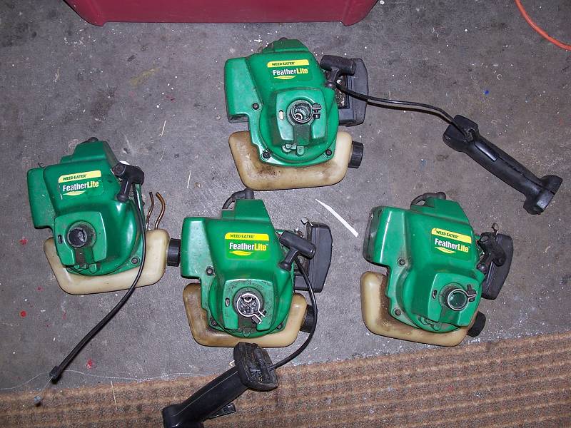

Hey guys, im really interested in this gas/glow stuff. I read to page 12 and gave up. Could one of you guys give a summary of what seems to be the best fuel mix for weedies on glow. I just came across 7 weedeater powerheads, 4 18cc 2 25cc and an unknown i think 21cc. The 2- 25cc are toast the cylinde3rs piston and ring have bad scoring should have checked before converting the crankcase. So im going to be converting the 21cc looks to be in good shape.
Maybe somebody wants to trade for a good 25cc piston and cylinder for a whole 18cc power head ?
The picture with 2 engines one is a 25cc and the other on the left is unknown can anybody identify it?
If i can do away with the flywheel, do i need anything besides the prop adapter for the taper on the crankshaft end as shown in one of the pics?
