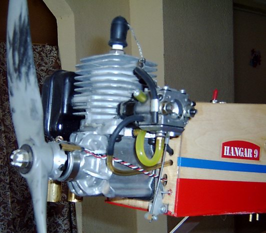

The engine responds well to a larger carb such as one with an 11mm venturi. But you have to open up the throat in the plastic carb adapter manifold to match the carb throat. Often times, before you get to the point where it is open to the same diameter as the carb throat, you are either very close, or slightly into the carb pulse hole in the manifold. You will also get very close to the "relief" provided in the manifold for one of it's mounting screws. I fill the pulse hole with JB Weld, and I make a little dam and fill the area near the bolt hole relief somewhat and use a smaller headed bolt in that position. You can then bore out the manifold as far as needed without problems. Don't try to bore the manifold out with a drill, as it will catch in the soft material and probably ruin the manifold. I use a sanding drum in a Dremel.
If you look at the fuel pump cover on the carburetor, it has a couple of little raised round spots or bosses. These bosses are there for the installation of a fitting for a hose to run to any convenient spot on the crankcase for the pulse for the fuel pump. Some carbs come from Walbro with a fitting; the ones for applications using the manifold pulse hole don't. All you have to do is drill and tap the boss for a hose fitting and run a line to another fitting installed on the crankcase for the pump to operate. The fitting on the crankcase can be anywhere that is convenient, just make sure you don't leave any chips in the engine from drilling and tapping the hole.
This is a good modification whether the engine is run on regular ignition or Gas/Glow.

Another great modification for the Homelite 25 is to send the piston to Frank Bowman and have him install a pin in the ring land and make you a ring for pinned use. Then you can grind out the bridge in the exhaust port for MUCH better flow because the ring won't be able to turn and get caught in the port.
A Homelite 25cc I did for a friend has the 11mm carb, a free flowing muffler, the base gasket left out to raise compression, and the above modification. With no porting or other hop ups it turns a 15 x 8 APC prop at 9400 rpms. It will turn a 16 x 8 at around 8700.
AV8TOR

Thank you for explain the pulse line system. I've seen these in the back of glow engines and didn't know what they were. What increase in RPM do you think could be had from this type of modification?
With this modification, how do you know what tolerances there are in line diamiter so as not run the motor out of fuel?
What Do you have a phone number or address for the man with the rings? So I could call him? Could a second ring be installed with a pin to further increase compression?
What is the fastest RPM you have seen for yourself a Homelite 25 run? I've had guys tell me 11,000 RPM turning a 18x6 prop? I thought they were just BSing me.

Chicks5 -
IT'S AN ENTIRELY DIFFERENT DEAL WHEN YOU SEE ONE ON A GLOW ENGINE. WHEN YOU SEE A PRESSURE TAP ON A NORMAL GLOW ENGINE, IT IS TO PRESSURIZE A FUEL OR SMOKE OIL TANK; NOT OPERATE A PULSE TYPE FUEL PUMP. (IN MOST CASES.) AS FOR RPM INCREASE, I HAVE NEVER DONE A "ONE AT A TIME" MODIFICATION PROGRAM SO I CAN'T TELL YOU WHAT EACH AND EVERY MOD WILL DO BY ITSELF. AN ENGINE HOP UP PROGRAM SHOULD BE A COMBINATION OF THINGS THAT WORK TOGETHER/COMPLIMENT EACH OTHER.
With this modification, how do you know what tolerances there are in line diameter so as not run the motor out of fuel?
FUEL DOES NOT FLOW THROUGH THIS ADDED ON TUBE. THE TUBE IS FOR THE PULSE THAT OPERATES THE FUEL PUMP. AS FAR AS FUEL FLOW ITSELF, NO WORRIES, THE CARB CAN SUPPLY PLENTY OF FUEL.
HIS NAME IS FRANK BOWMAN. I DO NOT HAVE HIS CURRENT E-MAIL OR PHONE NUMBER. POST AGAIN AND SOMEONE HERE WILL PROVIDE IT.
I'M SURE IT COULD, BUT I REALLY DON'T THINK IT IS WORTH IT.

The reason Gas-Glow works is that the methanol reacts to the platinum wire in the glow fuel.
You need right at 1/3 methanol a little less and it will quit working.
Larger quanities of oil should only be used in test batches.
The lower the compression the more nitro you need to use.
When you remove power to the glow plug and the idle drops more than a little bit
You need:
1) More Nitro
2) To raise the compression
a) new rings... If you are dealing with an older engine this may take care of a lot of problems.
b) remove material off the flange on the bottom of the cylinder.
You need about .020 clearance between the piston and the head, this is called the Squish Band.

shaunmichaeljohnson - These conversion engines tend to be fairly low compression and like the nitro for the most part. But that is true; if the compression were high enough the nitro wouldn't be necessary. However, a slightly lower compression ratio used with nitro makes more power, and has a nicer idle and transition to higher rpms than an engine without nitro.
AV8TOR
AV8TOR
