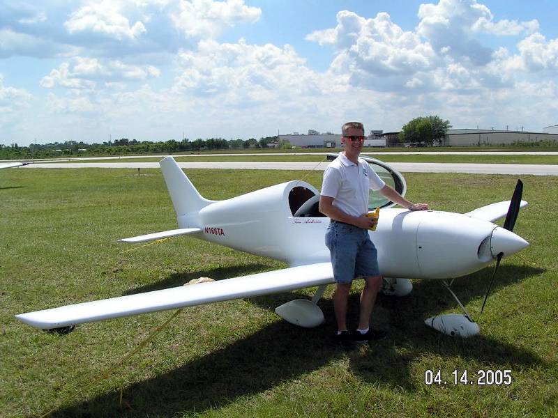

I like this photo too! Man that must be a fun little airplane!!!!!!!!! Capt,n

You know it John, it's a blast to fly. It's just like being inside a large model airplane. Empty weight is 282lbs, top speed is 160mph, cruise 125mph. With a roll rate of about 100deg/sec it rolls well and glides at 13:1. The fuel is 50:1 premix of 87 autogas and mineral oil and engine is a Rotax 447 with 40hp. It burns 2.5gph in cruise yielding about 50mpg on cross-countries. In aviation dollars, that's just about free. There's a video of me flying it on Youtube: [link=http://www.youtube.com/watch?v=k3-3nZ6sXkI]My Private Rollercoaster[/link]

Wow!!!! That Video was neat. I do not think you want to try that airplane on Gas/glow. Speaking of gas/glow or gas fuel with glow plug no ignition...I got to post a photo of a Homelite 25cc I worked on and maybe messed up the squish band area. It viabrated bad on glow for some reason. I never did try the same engine on strait gas to see if it was smoother. I may try that too. Regards Capt,n
