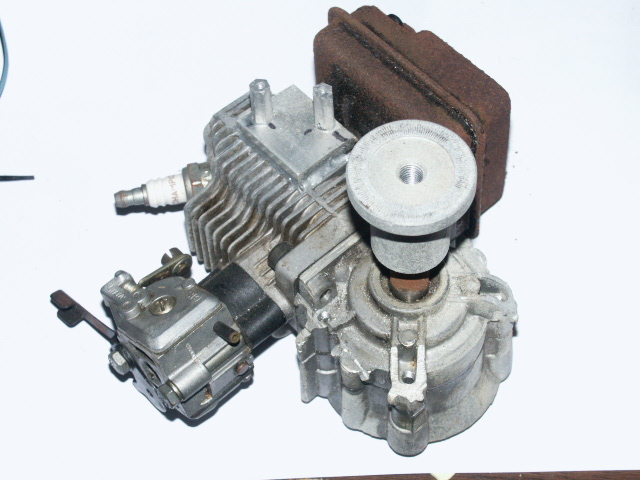

This is old 18cc I was playing with.
I used Alumiweld to weld plate to the fins. Then drillled an tapped for some standoffs.
Worked fine, but this engine is too small to do anyting interesting with. So it sat out im my garage and is now all corroded.
