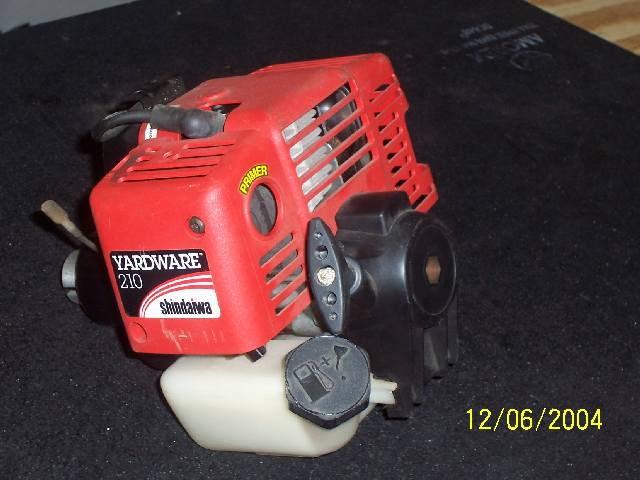

I have a new shindaiwa weedeater power head. I got it from a friend of mine that owns a small engines shop. Its new only test run he bought a few of them cheap and he sold this one to me for $27. Well the name on the weedy is Shindaiwa Yardware 210 that is all thats on it. Can someone tell me what cc it is? I would also like to know what type of bearings are on the crank?

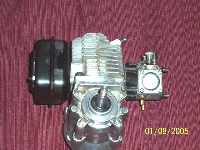

I'm going to get a EI to go on it. If someone has one they would like to sell email me with pic and price. I have two pics of the weedy one just like i got it and one with it ready for ignition.
Let me know something.
Ivan

Ok i know that its a 21.2cc . Does anyone know what would be a good prop? I want to put this on a super stick 60 can it be done? Motor weight 2 lbs 5 ozs with out prop hub and EI. How do this motors do as conversion engines?

I think they might be the same motor. But i'm not sure. I still need to know what prop i should start with.

Start with a 16-8. Your goal is to have a static rpm of 7-8000.

So you guys think i should start with a 16-6 - 16-8 prop. Ok thanks. The carb on this motor is very restricted on the intake hole in the carb(.312 dia. on the outside .500 on motor side). Do you think if i bore the hole out to the same as the back side of the carb that it will give me more power? I know i will have to take the brass flap in the carb out to bore it. Let me know.

oslim Thanks. I bought several to use on variety of Homie and Ryobis. A search of muffler sites indicated that the exterior dimensions were very similar. I used two holes 1/2" .197si each x 2 = .395 si Exhaust port is .48 x .78" or .3744 si NO restriction. No pipes. Longer endplate screw & JB Weld to secure them and seal. Alum tube would make nice light compression tubes but none on hand
smallplanes I'm using a Wallbro 167-A 11.11 venturi. You need an I.D. difference on interior of carb. Take a close look near the throttle butterfly and notice a number of small holes , they are fuel jets and rely on a 'venturi effect'

Hi mikenlapaz, Are you saying i need the outside on the venturi a little smaller than the motor side of the carb? Like 11.11 mm on outside and 12.7mm on motor side of carb? Will it give more power?
