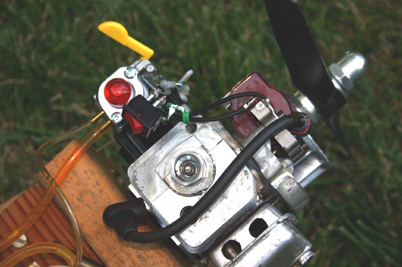

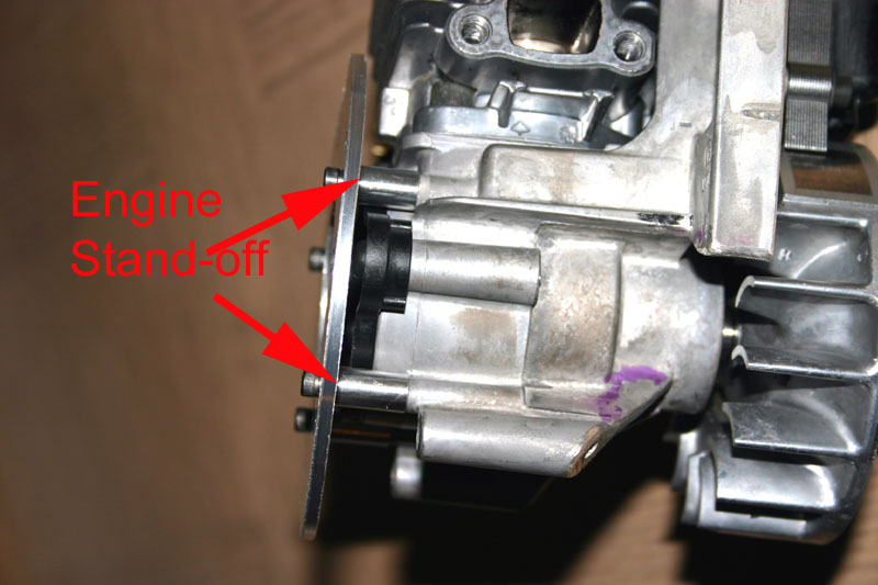

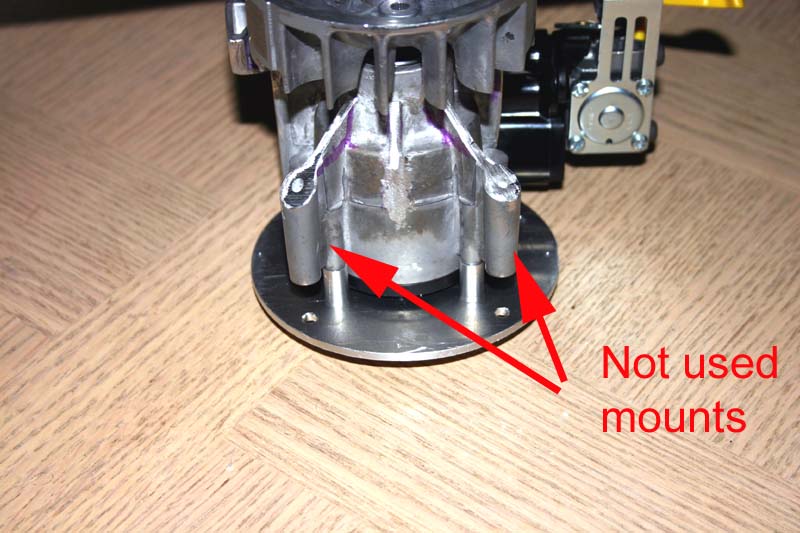

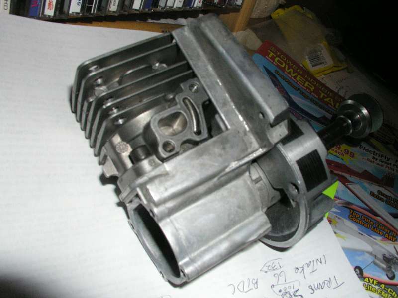

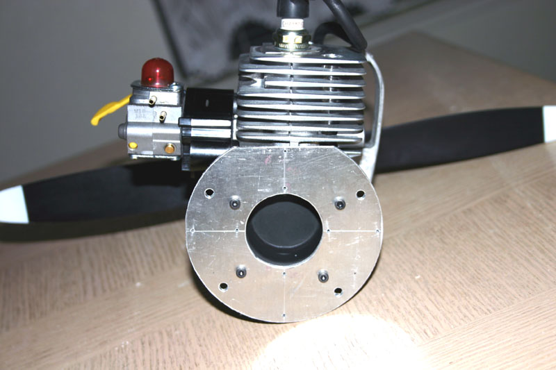

16 inch is just fine. I'm sure it will have more than enough power than I will ever need. It is scale model of the plane that can't even make loop or roll. The narrow wing and slotted flaps shuld make stall speed low. I'm sure it will fly. I was thinking about bigger prop just because of the scale look, but if I have to live with 16 inch - I will.
I just weighted the engine again this time without the prop (and no muffler - should arrive any time). Exactly 3 lb 4 oz. Muffler weights 4 oz, so my setup is the same as other guys have. I still can cut off the old fuel tank mount and save 1 oz.
Here are the pictures of the mount. You can see I didn't use the old fuel tank mounts. I still keep them just in case. But when I see my mount doing fine while engine is running, I will remove them.

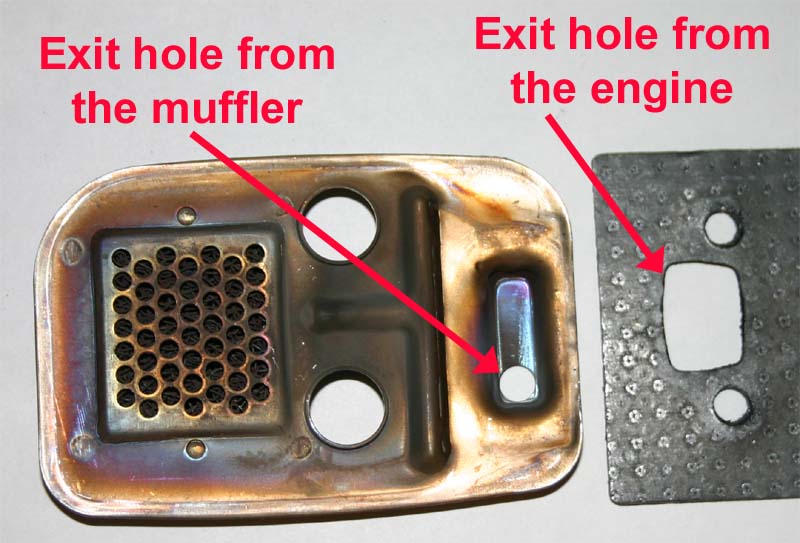

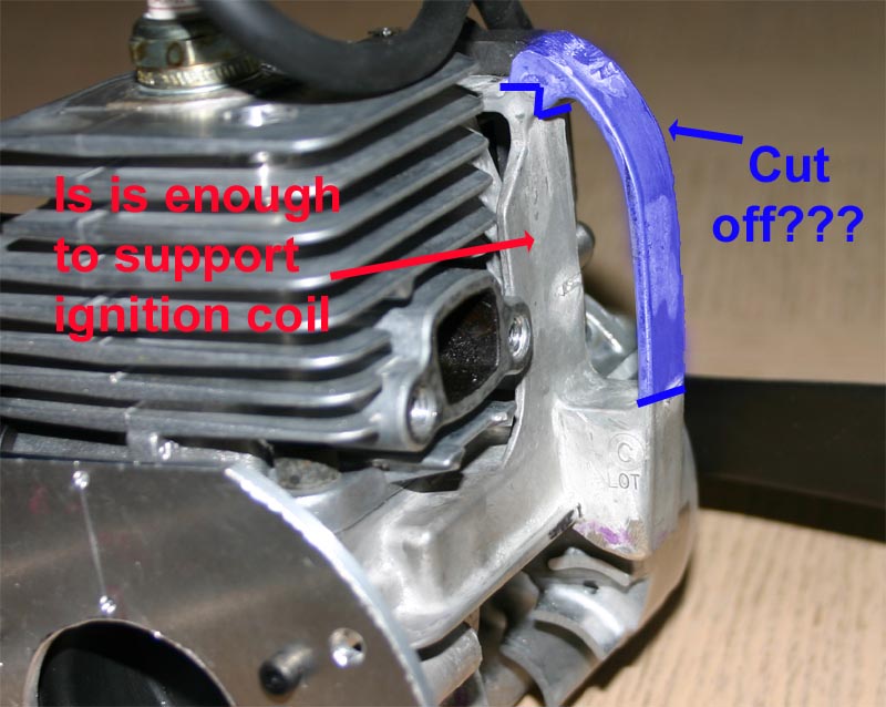

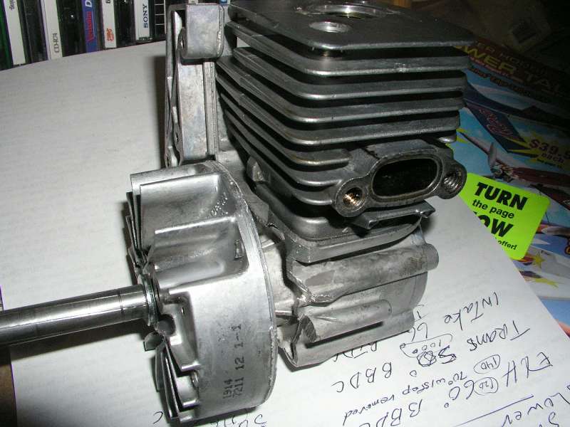

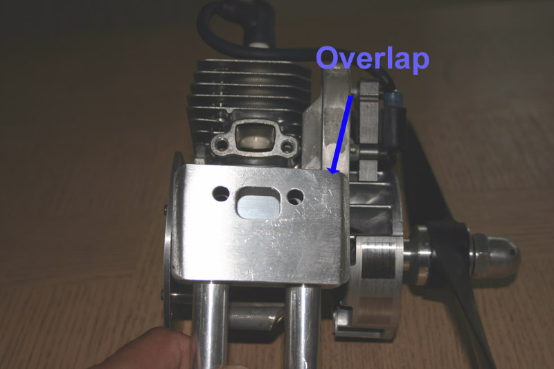

ORIGINAL: RysiuM
The muffler from [link=http://wackerengines.com/]http://wackerengines.com/[/link] arrived today.

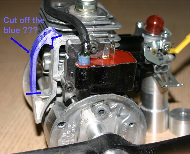

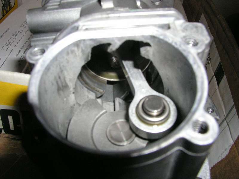

I have a little problem. The muffler doesn't fit. I mean it is a perfect good muffler but it sticks fo much to front so it interferes with the magneto support. Pater (wackerengines) wrote me that some peolpe cut off the part of the ignition coil support and then muffler fits. But if I don't wnat to cut it off, he will replace the muffler for the smaller one. It was my fault, as I never showed him that part of my engine (and as a matter of fact it's difficult to see it on my pictures posted here). I wrote him back, that this is good option. I really like that muffler so much, that additionlly I ordered one more.
Now when I got back home I looked at the engine again and maybe he is right about cutting off this additional piece of metal. What do you think guys. It is my first conversion so any tip is more than welcome.
See the pictures below. I showed with the blue color the piece of metal I was writting about. Also blue lines show where the cut might be. The red arrow shows the pice of metal that would carry the whole load after the cut.
Help me guys. I really wanted to run this engine this weekend, but I don't want to do this without muffler.
RysiuM

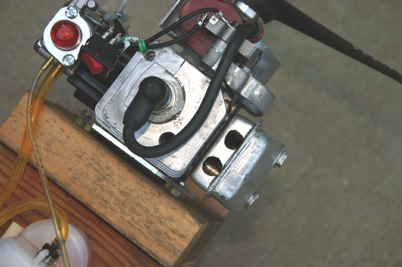

Waiting for the real muffler from wackerengines I decided to mount the stock muffler. I heard it is restrictive so I opened and then I removed the internal wall. STOCK IS RESTRICTIVE. See on the picture below. Exhoust gasses must go through the hole shown on the picture. For comparison here is the exhaust port shim.
When I closed muffler back (without this internal wall) I drilled two 10mm holes in the muffler case. I didn't put any tubes - just the holes. Now my engine is ready for test run.

Default RE: Poulan 25 from FL trimmer
Hi Rysiu,
Cutting the brace not your only option, but if you did the web in back of the coil support should give the need rigidity. Another idea is to reverse the cylinder putting the muffler on the oposite side. Also the piston would be reversed so the pinned ring would retain its orientation. The Cylinder will bolt up fine. The big issue with this idea is making that the transfer ports in the crankcase are not blocked and removing any material so the ports are a close match. I tried this on my 18cc featherlite, but didn't do it because the lower rear transfer was molded into the back plate. I am looking at my 25cc weedeater blower motor now and it will work fine with it. It would have no blockage tranfer port blockage. I would remove the center web in the top of the crankcase, because it is going the wrong way with the cylinder reversed. See my pictures below. Another bonus is that the hot exhust side of the cylinder will now be exposed to prop blast for better cooling. I didn't have to cut anyting on my 25cc to reverse the cylinder. Just remove the back plate. unbolt the cylinder. With the piston at the bottom of the stroke slip the con rod off of the crank pin and reverse the cylinder, being careful not to dislodge the piston from the cylinder. Slip the con rod over the crank pin and bolt down the cylinder. Check to insure that the transfer ports are unobstructed and the engine turns over freely. Replace the back plate. Slight trimming of the cil support wab may be required. Of course I am not resonsible for any problems that may ocurre since I am not performing the proceedure. Either way the larger muffler is better. Good luck.
Dave

ORIGINAL: davewallace

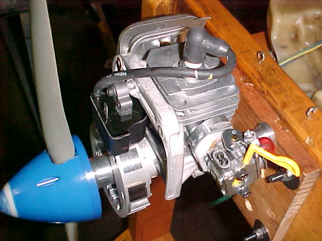

I decided to run it as it is - with modified stock muffler (the inner baffle plate removed and drilled two 10mm exhaust holes). The gap between magneto wheel and ignition coil was setup using credit card.
I tried to start it by hand but no luck. The engine fired up from time to time but didn't continue to run. So I grab my Sullivan starter and the engine started after first turn. I let it run a little but when I advanced the throttle suddenly I heard a metal noise. I killed the engine and checked it out. The piece of magneto wheel was scraped. Under the vibration it just stroke the ignition coil. So even I had the original support, it still can flex under vibration. I will not weaken it even more.
I adjusted the gap using two credit cards. This time it didn't even fire then I was flipping the prop. However with starter it run after the first turn. I will not be able to start it by flipping the prop but at least my standard starter works. I can live with that.
I noticed first that the high end was way too lean. I had to unscrew it one full turn. I guess without restriction on the muffler the engine wants more fuel. After letting it warm up for 30 seconds I opened choke and run it a little.
I was able to get steady idle about 1800-2200 rpm (it is difficult to set it using flex linkage held by hand, and reading the rpm with the other).
Full throttle is 7200 rpm on Master Airscrew 16x8 Classic Series. Not bad for 1:30 with Motul oil. It my fuel I use to break in MVVS and Brison. I may get a little more rpm on 1:40 with Motul (my running mixture on MVVS and Brison).
I think these are good number for stock 25 dollars motor. The sound of the engine was also cool. It will be even better with Wacker's muffler (when I get it).
RysiuM

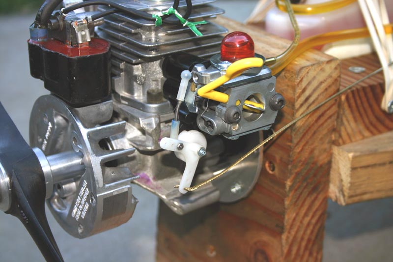

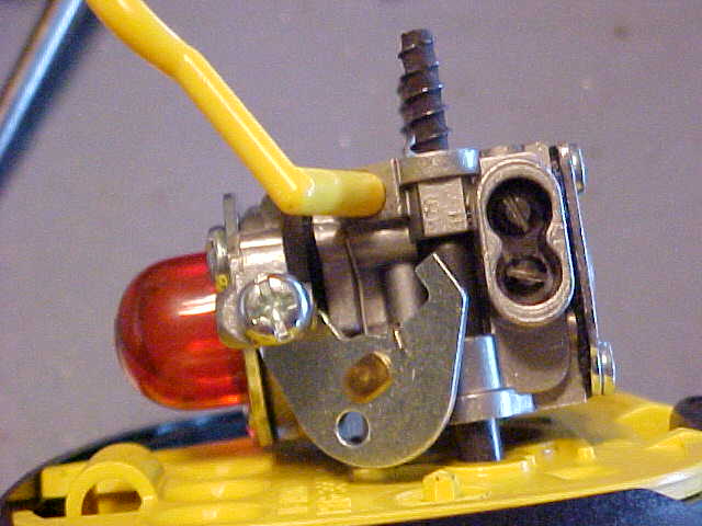

ORIGINAL: flipflop
How did you modify the stock carb to adjust the needles?

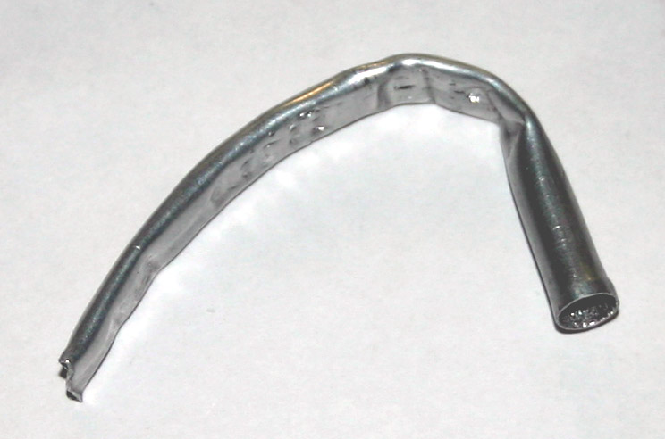

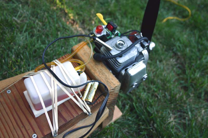

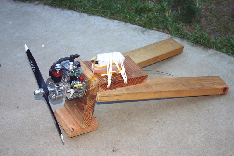

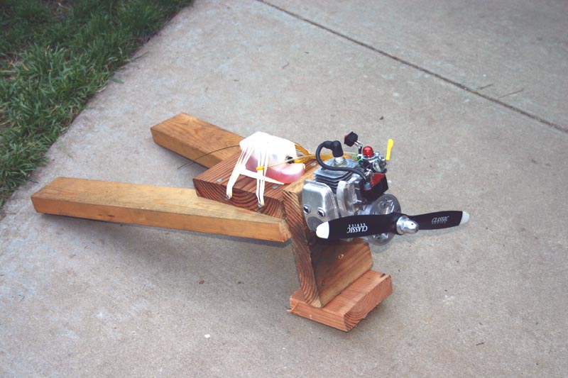

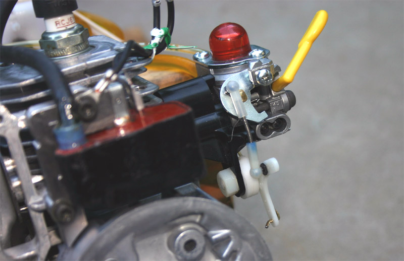

I didn't. I cut the plate under the needles (the original guide, that helps adjust the needles on weed whacker) as it interfered with throttle linkage. This was the only mod to the carburetor.
For adjusting needles while engine is running I made a simple tool: U-bent 7/32 aluminum tube, that the end I pressed to the mixture adjusting screws to shape the 'grabbing' part. It was not a rocket science
See pictures below of the tool and the engine. My home made test stand works OK as long as someone holds it from the back. I also show throttle linkage - easy and clean solution. Details of modified muffler and finally the magneto strike.
Enjoy
RysiuM

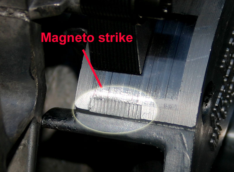

I bolted the magneto brace to the muffler to prevent flexing
Obviously this precludes changing the muffler
You can see the bolt just above the magneto bolt, just behind the sparkplug wire [link=http://www.rcuniverse.com/forum/upfiles/29406/Bw73581.jpg]Here[/link]

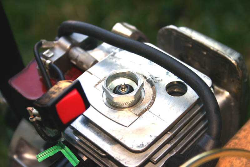

ORIGINAL: carlosponti
RysiuM nice work on the video. i liked what i saw there.
Did you? so how do you take this. I made glow plug adapter for that engine and I run it on glow. The plug was powered all the time from 2 AA 1.2V 1800mAh NiMh batteries. THE SAME FUEL: Motul oil 1:30 with gasoline 93oct (Chevron). Engine run the same like on ignition - even better. I got steady idling at 1600 rpm and 7400rpm at WOT (it is 200rpm more than I got on ignition). I didn't even adjust the needles.
If I decide to keep it like that the engine will be over 1 lb lighter (flywheel and ignition coil with support will be gone). Yes, it was hard to believe. I couldn't believe myself. But it works.
RysiuM

in essence you made a single cylinder desiel well maybe not but the concepts are the same.
Just running on the high octane fuel and the glow plug is lid all the time. I was wondering if I can hand start it. I got luck one time. Other than that when it popped it turned one way and than back and then forth again. Just didn't have enought momentum to go through the second compression. But with starter it goes easy.
Then I checked how does it run when I cut the power from the glow plug. I rune very uneven like on self igniting from exhaust gasses. Then I connected glow again and it started to run without any hasitation again. When I cut the glow power in idling it just died.
RysiuM
