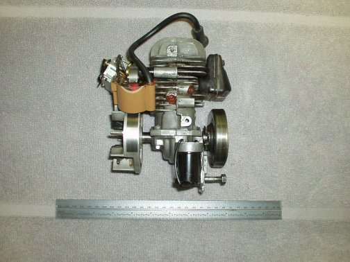

Hi,
The most common trimmer engines are the 28 and 32cc which have the size cast into the cylinder mounting flange just below the exhust port. Here are pictures of two trimmer types and a saw engine.

Hi Mike,
Does it look like any of the three engines in my last post? The one on the left is a saw engine. The one in the middle is a standard trimmer engine. The one on the right is a Roadrunner trimmer with a Echo style engine. It is hard to answer questions without knowing what you have or exactly what you are describing. You may have an old engine with points. Engines produced in the last few years just have a flywheel and coil. The flywheel is keyed to the shaft and the coil is mounted in a fixed position above the flywheel. All you di is set the clearance between the coil and flywheel. Since you do have internet access, just do some searching for McCulloch on the net. When you find a picture of an engine that looks like yours, save the picture to your harddrive. You can upload it in a post so we can see what you have.

Hi Mike,
The 21cc Mac was the engine on the right in my post above. It is a Echo style engine with dual counter weights and built in mount. The shaft stud should be 8x1.25mm. I am converting one now from a Mac Roadrunner trimmer. The flywheel is heavy and the ports are small. I plan on triming the flywheel and advancing the port timing. It will weight about 3 and 1/2 pounds ready to fly with magnito ignition. It will swing a 15 or 16" prop close to 8,00rpm with a 9 or 10mm carb. In glow terms it will have the power of a good .75ci with the weight of a 1.8ci. You can figure a gas engine willproduce about 2/3 the power of a glow engine at about double or more the weight.
