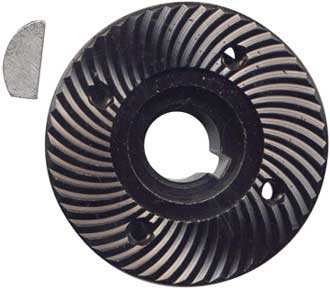

Rupurt: Is this non tapered shaft a part of the crank or what? What kind of engine are you working on? Can you post a photo...I am wondering just what you got there? Thanks Capt,n
Old 09-20-2005 | 01:16 AM
Rupurt's Avatar
Joined: Apr 2004
Posts: 694
From: Cape TownN/A, SOUTH AFRICA
Default RE: Cutting prop driver key-way
Hey Captin, The engine is a ASP 160twin. The shaft is not tapered and I am going to make a prop hub to convert to CDI. Here is a pic of the part I am drawing inspiration from. And a pic of the crank both are from global hobby's site

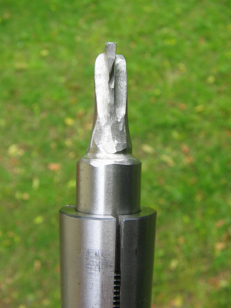

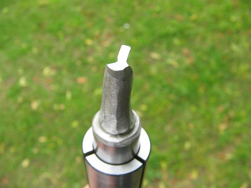

Thanks I think that seems like the best way to go, I may use the mill though it just seems like it would be easier to set up. I was thinking of grinding an old endmill for the job, do you guys think a collet will hold it tight enough, the one I have in mind has a 16mm shank, would it be safe to put a piece of aluminium behind it in the collet to stop it sliding back
Crusty should I use a twin turbo setup or should I put both exhaust through one turbo
Old 09-20-2005 | 03:57 AM
Rupurt's Avatar
Joined: Apr 2004
Posts: 694

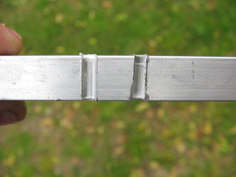

I tried it out on the mill works great only takes a couple of minutes to cut a slot, I now need to come up with a plan to lock the spindle. The collet had no problem holding the tool. Thanks for your help guys, I will post a pic sometime soon[8D]

Well it's not pretty but here it is. The practice runs where promising with some refinement I think This could produce some professional looking key-ways.
