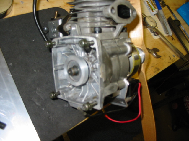

RCIGN1: Please take a look at photo of engine in post 204. I found out the mag is not going to work that well. The amount of stock holding the magnetic coil part is not going to support it good. On the engine you done like this one did you use setup on back of engine for timing or is there a better way. Also will this engine start and run on fixed 28 degree ignition timing? Thanks Capt,n

28 degrees is good, all my conversions are timed at 28...Small ones don't kick back hard enough to bother with spark retard for starting...
The ones I did like that were a long time ago, the BC260, 340, and 430 Brushcutter engines...the case looks the same but the magneto setup was different...I cut the crank off in the rear and put my ignition circuit in there, with the spark coil from a G62 on the front like the new G26....Now that you have a lathe there IS a better way...
Check out the front of this G26...See the ring on the case behind the hub ? The hall sensor is epoxied in it, a slot in the bottom..You can see the wire coming out...The front of the case can be machined for an aluminum ring..That one is 1 3/4 diameter and about 1/4 inch thick..Make the hub with the taper in it to the same 1 3/4 diameter at the bottom, and whatever you want the rest of the way, a little longer than the bottom of the thread on the end of the crank..You want enough of the thread sticking out for the nut to hold it on the crank...

Another one, a little easier to see how it works...The prop hub on this one screws on the threads on the end of the crank...

RCIGN1: For now I think I will try your more easy version. I may even leave the stub on the back. The stub is very short and my ignition will not fit in where the recoil was attached. Thanks for the reply and the photos. Best Regards to one of the Best.....Capt,n MERRY CHRISTMAS!

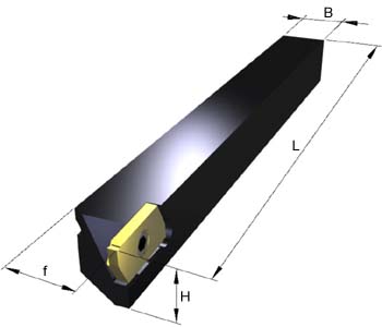

Guys: Have any of you tried this style of cutting tool and holder? Thanks Capt,n

Capt'n, they are great tool holders and bits, but not for you. The carbide puts to much strain on a small lathe. It needs twice the surface speed and a lot deeper cut than HSS tools. IE lots of Horse Power. It also has a second issue in that the carbide is very brittle. One screwup setting the feed and speed and you have carbide flying. At $5 a pop or close for good carbide bits, it can be a very expensive learning process. Having gone down this path, I highly recommend HSS bits that you grind to shape yourself. Just grind the ends to the general shapes of the chart, and for $5 to $10, you have the full range and if you dull a bit, you can re-sharpen it.

Campgems...thanks for explaining about that type of tool holder and inserts. Believe me I am going to do just what you say. The High speed steel bits are working good for me so far. I bought 2 from Grizz that is already shaped and ready to go. They do work nice...now that I have them on center. I am looking to purchase a dial indicator that will work good without breaking the bank. Is .001 good enough for the conversion work? I see a few in the $15-$20 range. It might be best to buy one with magnetic base included...to save a little. Boy this stuff sure does add up quick! Best Regards, Capt,n
