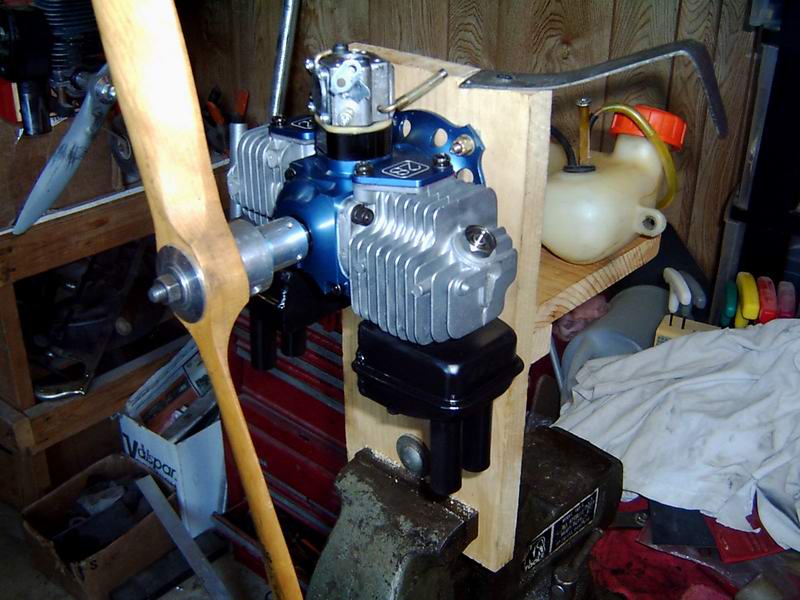

This is a little off topic but I just got my 62cc Echo twin running.
http://www.rcuvideos.com/item/80HMB3SYWNYB42GR
I just wanted to share it with the group.

Nice Ralph. You make me want to get after mine... One of these days... How about some nice close up pics??
Nice job on your twin too jlew. What rpms do you get with that prop?
AV8TOR

I've started off with a 22x8 APC and she is still pretty rich on the top end.
I now have about 1 1/2 quarts through it and will put another quart in it before I adjust the high side.
If I just idle it it hardly gets warm to the touch.
It like a few drops of fuel to start when cold, but hand starts much easier than my G-62.
I'll have some numbers soon.
Ralph at rcignitions is selling ignitions for these for $75.00 with a lifetime guarenty, that includes crashes.
Gas-Glow is pretty cool stuff but I've never had an engine idle like this does.
You can count the rpm by the exhaust.
I purchased 2 more ignitions for my other twins and hope to sell off a couple of running engins to recoupe
