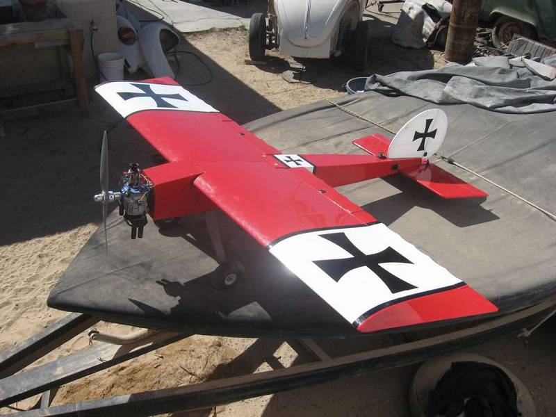

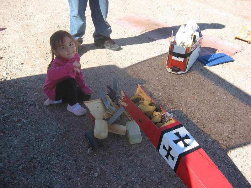

My Giant Stik "died"....
Ran out of fuel and hit a telephone wire trying to make it back to the field.
The engine wasn't hurt.
AV8TOR

But then I fixed it....

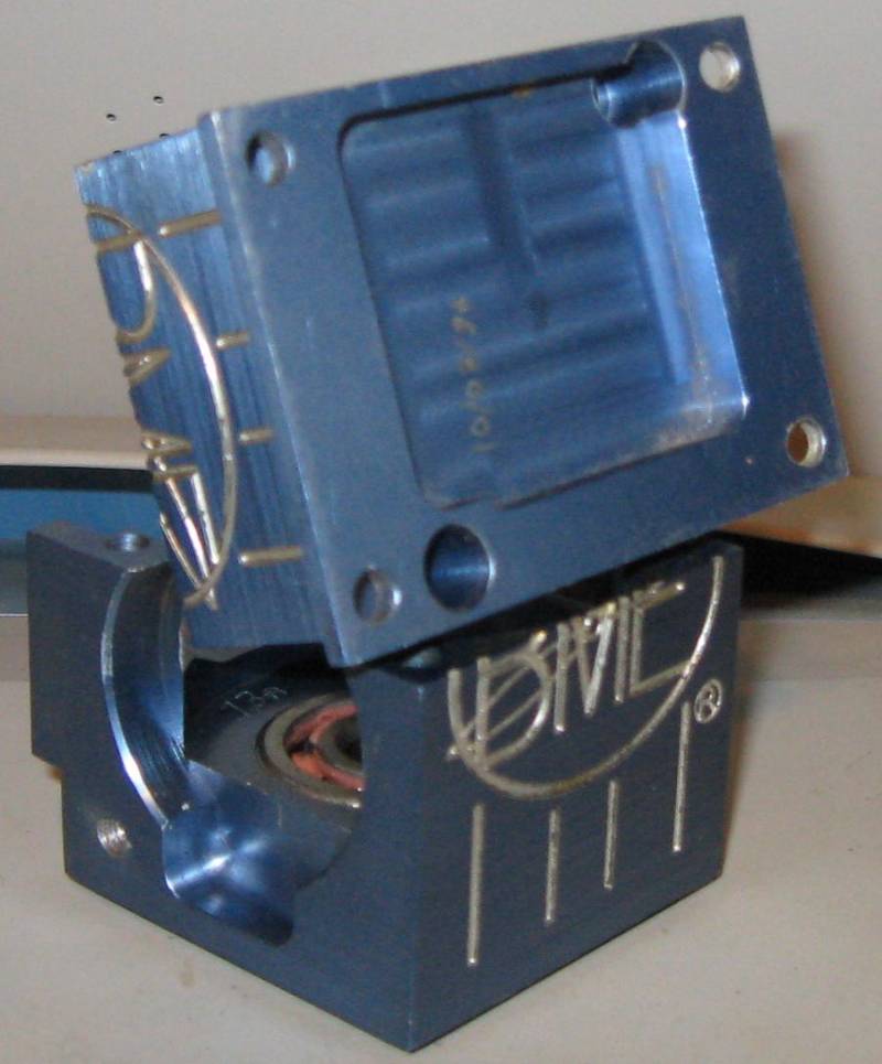

While I was at it, I decided to work on the BME twin. I didn't do any mods when I built the engine; I just assembled it stock. I decided to see what could be done to improve it.
I found that Keith had designed the block so that the cylinder sat lower, and therefore the squish area, at least on my engine, was fine with a normal gasket at the cylinder base. However, this causes a problem. The piston never uncovers the exhaust port completely. Also, once again at least on mine, the exhaust timing was a very low 122 degrees. I chamfered the edge of the piston at the port to allow the port to open completely. This also raised the timing somewhat, but not enough. So I raised the exhaust port until I got 150 degrees exhaust timing. I then assembled the engine, and installed a 15mm venturi carb in place of the 13.5 I had been running.
Wow, what a difference!! It had been turning an APC 18 x 8 at 8000 rpms. Now it turns the same prop at 8700. That is a really big power gain. I don't have a 19 or 20 x 8 to try, but when I get one I'll let you know the rpms on that. My other twin that I have been (slowly) working on uses 25cc crankshafts, and doesn't have the problem with the piston not opening the exhaust port completely, but you have to make spacers to raise the cylinders to accomodate the longer stroke. It will be interesting to see how that one runs....
AV8TOR

Bad for the plane but good to hear about the engine coming through.
