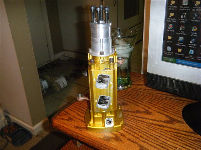

Is anybody still working on these? Im looking for some 23 cc cylinders and piston for a for cylinder im building.. if so please send me a pm
Thanks Joe

Well that's pretty interesting looking. Please keep us posted. Sorry, don't have any extra cylinders. The 21cc cylinders are much easier to find. You might scrounge up a couple of those to use for now, then you could switch to 23.6 cc cylinders later once the engine is proven. (Same bolt pattern, stroke, etc.)

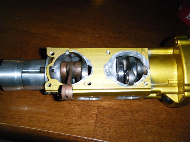

Does each opposing cylinder set use a sealed crankcase half, or is the crankcase open to both cylinders? How did you do the crankshaft interface/connection, and is it a permanent or break down connection?

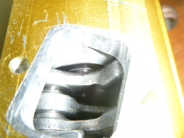

The crankcase is sealed in the middle with two sealed bearings. The front set is on one set of reeds and the rear set on another. The crankshaft is done like the 2.8 but the two are joined by a 5 degree taper and threaded, I also put a set screw. They had to be installed in two half’s to get in the case..I still can’t find any 21 or 23 cc
any suggestions on where to look on line?

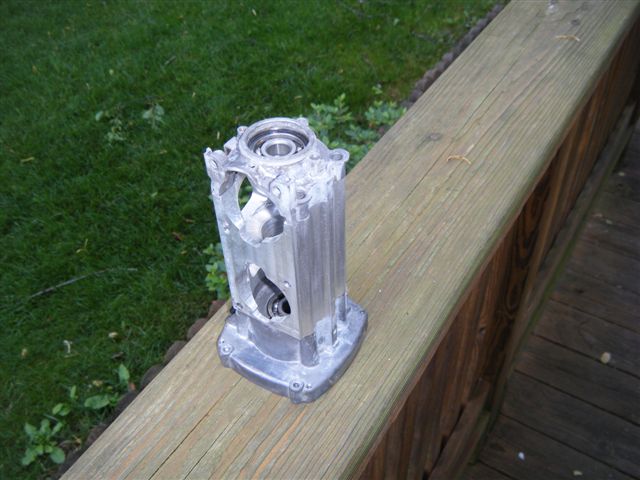

I saw some posts of someone using what appeared to be a modified weed waker case.
would like to make a twin, have machines but not big enough to mill out a case in any reasonable amount of time.

It has me thinking. If I use two of my Ryobi clones won't I have to split the case down the middle to allow assembly? If so wouldn't I be better off to just scratch make a case than trying to figure out how to marry two of the Ryobi cases? Or are you all using con rods with split bearing saddles?

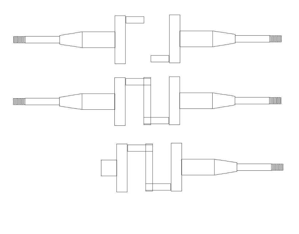

The Echo engines we are using for twins, and now this amazing four cylinder job have a full crankshaft with bearings on each end. The Ryobi engines have a cantilever crank with bearings only on the front. I don't know how one would connect two Ryobi crankshafts and make it work, even if you solved the crankcase problem.

Cranks, see pic.
Case? Square bar stock with a round hole. Make the ends with the bearings seperate and to fit the round hole. Machine all necessary holes, dowels, threads, and such. Remove all unecessary metal?
Assembly, Is there enough room to slip the crank with con rods on it into the case from the front or rear? Then the pistons are attached after?
