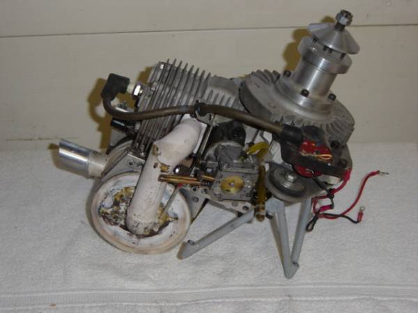

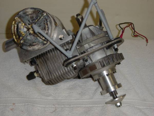

I did it! the lightest 56cc engine around

my 5.5 or 91cc engine will be going in my 1/3 staudacher and it only weighs 4.25 lb.I just dont think the 56cc will give me the power I want,the 91cc is only 1.25 lbs heavier but holly cow alot more power.

Current Numbers for the BME50 and Da 50 are the Mejzlik 22-10 in the 7100-7200 range. With 12% more displacement, it would be logical to expect at least 3-500 rpm over those two engines.

OK here are the actual #'s not inflated or exaderated for ego purposes just the real #'s
menz 22-10 6500
pro zinger 22-8 7300
I have really been looking at real #'s and have come to the conclusion that I have another 200 rpm on the da and zdz 50
and for those only interested in #'s the da is rated at 7000 rpm but only with there tuned exhaust and same with the zdz my #'s are without a muffler so if any one has the same prop an there 50cc post your #'s without muffler so I can see where I am really at.please post real #'s without muffler, I see so many people post unreal #'s trying boast about there engine but we only want those who can post real world #'s please.

Hate to break it to you. . the BME and DA BOTH turn in excess of 6900-7000 with the Menz-s 22-10. Getting RPM figures with any Zinger is like using a flat prop. they flex so much that an 8 or 10 pitch loses 1-2 inches of pitch at max rpm.
Get a menz or Mejzlik and its a good RPM reading.
BME and DA are still ahead, if the Menz is your benchmark.

I guess the cost depends on if you have access to a mill, heavy duty grinder and a few metal-removal tools that cost a good bit. . .then if you buy an Echo 50cc motor brand new, you have to factor that cost in also. conversion "kits" (such as those from Carr and B&B) go for about $60-125, depending on options, and adding a C&H ignition is another $100 or so.
Soo. . with a "kit" and ignition, and the cost of the motor itself. . how much do you have invested? 100+125+125 (or so, for the motor) is $350.
Now, if you just happen to have the motor laying around (where DID it come from???).. and an ignition falls out of a tree at your feet, AND you happen to work at, or have access to, a machine shop (where your time costs very little to YOU), I'm sure you can build one pretty cheaply, although I doubt anyone would buy this 56cc engine for its apearance, and if comparing it to a Da, BME, Brison, or Taurus for power, its a bit short in that category. Soo. . is it a marketable commodity? Could you sell it for $150 profit if you had to buy a bunch of them and modify them?
Not really a very accurate comparison of cost, is it?

please note. . didn't BUY the motor to convert it (or DID he. . ) and made all the parts in a machine shop instead of purchasing them.
Lets comapre apples and apples. .
lets see. . buy a new 56cc motor. . $125??
PAY to have it machined and weight removed $75???
and add parts necessary to make it fit our planes . .$75???
and igniton $125. . .
There's 400, easy.
contact your local yokel machinist for prices for his work and for fabricating the things you need for the motor. . .You see. .. not everyone has a 56cc motor just "laying around"
Now. . granted. . this is not a bad little conversion of a weedy/chainsaw motor. But everyone wants it to be something it's not. . It's NOT a DA.
It may be a few ounces lighter. . it may be less expensive. . it does not make the same amount of power, though, at 12% larger displacement. And, most important, it does not have a warranty or free repair if you break it.
How much is a warranty and future support and repair worth? I'd say. . every penny of th price difference in the two engines.

Look again at post #3. He picked up the engine for ten bucks, and I bet you could find that engine for sub-$50 if you look.
As far as everyone wanting this to be a DA, I believe you have been the only person trying to compare performance figures. Read post#1. This engine was converted to show it could be built light, not necessarily more powerful than the current $500+ BME engines. I'd call it a major success, not a failure because it turns a few hundred less RPM than the latest and greatest engine of equal weight.

I think its an achievement in American ingenuity, do we have to be enslaved to buy an already made engine, thats identical to hundreds of others? Is it so wrong to challenge those that are supposedly at their very best? If we didn't we wouldn't be advancing technology. Its the free spirited tinkerers like us that make advancements, big corporations do it only to stay competitive and thats USUALLY when they are challenged by different, better, cheaper designs.

I just found this thread today and read thru the whole thing at once. Being as Kris^ seems to be in such a hurry to pick this effort apart that he's missing out on the facts, I would suggest that he also re-read the whole thing.
As Ryan pointed out, bn120 did buy the engine ( connected to a saw) for $10. Those who are familiar with gas engines understand that they don't experience much wear compared to nitro engines. In fact, an engine that has seen a life as a well used chainsaw is probably still in the prime of it's life. If you are insisting on comparing this to a "new" engine, you are begging the question wrt why someone would do this.
Now, as for the power comparison, bn120 is looking to compare numbers without mufflers. Are the numbers Kris^ is using also from a bench run without muffler? I doubt it. That wouldn't be an accurate comparison.
Looks like a machine shop was used to make the prop adapter - could that be bought somewhere - in a conversion kit or?? Otherwise, it looks to be a job for a bench grinder. bn120 - can you fill us in on the general processes used in this modification process. What was done on general use tools like a bench grinder and what takes big $$ tools?
Warranty: Since you do have to buy the electronic ignition ( if just for comparison purposes) that part will of course be covered by warranty. As for the warranty on the rest of the engine being worth the price difference of $100-150 on an engine that you know inside & out, and can get a whole other parts engine for $10-50, I don't see the point.
Now, if the real price difference is not worth your time - that's a reasonable concern. But, it is a hobby ( something to waste your time on

I found a 5+ cubic inch Husqvarna chainsaw short block (no carb or mag coil) in the Goodwill store in Flagstaff for $4.95..Excellent condition...A hub made on my Enco lathe will cost me about $2.00 for some 2" diameter 2024 aluminum bar stock..The mount will be made from 4" diameter 6061 round bar stock, about $5.00 worth, bored on the same Enco lathe...I make ignition, so that will cost me **** ( I could tell ya but I'd have to kill ya) dollars, with a coil bought from C&H, about $20.00....A new Walbro SDC 80 carb is about $41.00..The carb insulator block is made from G10 epoxyboard, about $22.00 a square foot, so about $.75 worth for that....
Lets see, $4.95 +$2.00 + $5.00 +$20.00 + $41.00 + $.75 is $73.75 and a few hours labor.Weight ? 5 lbs more or less,,,.....Warranty ? Lifetime on the ignition, chainsaws never wear out, not needed on the carb...Cheap enough ? It CAN be done....
$500 + dollars for a 50 cc ? NEVER.......
