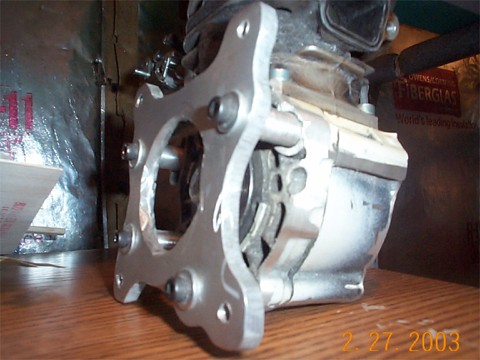

BME 50 3.3 lbs.
DA 50 3.0 lbs.
my stihl conversion 2.8 lbs and it is 56cc
I will have #'s by tuesday.
I wanted to build a engine as light as the bme ,then when I knew I could get there I wanted to beat the da by 10% and came really close ,I could save a little more but I am really satisfied with my engine as is. I hope I have even more braging rights come tuesday.
I know someone will chime in about the BME 55x but I belive I have one of the lightest engines around available today.
I built this engine to prove a point that conversions are not always heavy. :boxing:
Darin

Old 03-01-2003 | 05:28 AM
Joined: Dec 2002
Posts: 715
From: Gaston, OR,
Default I did it! the lightest 56cc engine around
Here is my stihl 91cc mount it is just longer case bolts through standoffs,I will do the 56cc the same way,ps the mount on the 91 is 5 oz so the 56 should be under 4oz. for even 2 oz. less than the h9 mounts needed for the bme 50 so the bme ready to mount is 3.4 lbs.mine is almost half poud lighter ,way cool is it not
Darin

Darin,
Did you do the machining of the prop adaptor yourself? Looks great! With the ignition system and mount installed, it will probably weigh just a bit more than the DA or BME 50, but for the price you paid and the power of the Stihl engine, it can't be beat!
Lynn
I will try a 22x10 and see where we are at and I made the prop adapter myself and all of the stihl I have are a different taper so I have to custom make each one.
