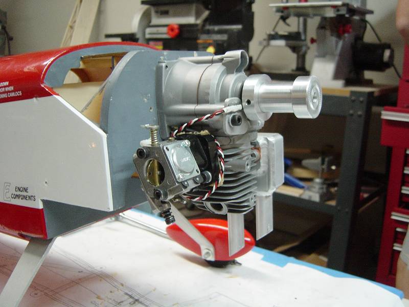

Personally I don't like the idea of turning down the flywheel or coring them. Reason being that unless you have a mandrel, which in this case would be a crankshaft with the mating taper you will have a very difficult time truing it. One way you could would be to core it then mount it on the crank of the assembled engine then mount the engine in a rotary table. You would need to indicate the crank in then move over and slowly turn the flywheel to true it with the crankshaft. Make sense? An easier way by far because you don't need as many setups is like I do in the attached photo. You make a prop hub and a timing ring, the timing ring is adjustable 360 degrees so the sensor can mount anywhere. Like anything in machining there are many ways to skin the cat. I tend to look for the simple way as well as the shortest way to the end. Hope this helps.

You could mount it there but then you need a new mount or standoffs. You are right in that there are so many possibilities. That is the fun part, the challenge.

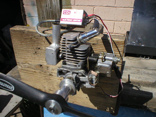

heres a pic of my 24cc echo wich i cut the center out of the flywheel,the large ring at the back of the prop hub wich holds the magnet.then the prop hub is screwed onto the flywheel cut off.Tim is right,i have 2-3 cutoff cranks that i use as mandrels to hold my flywheel sensor.And after looking at my hubs i have an extra one that would fit your threads but you will need a flywheel center to mount it if ya wanted to go with EI.if ya wanted to just use the mag then youd just screw this onto the flywheel as is.your only going to loose about 8oz with EI.ill send ya a PM.the hub i have xtra looks just like the one in the pic.

The only difference in the plug ir the R means resistor. You want that to cut the RF interference with the EI.
