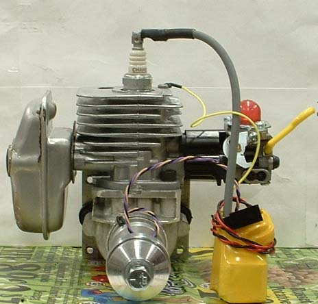

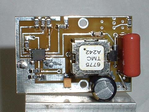

#208
Joined: Jan 2004
Posts: 12
From: Fayette, OH
It's the one I designed using the PIC micro controller. The unit pictured with the WE25 has a CH coil in it. I also use D&B coils. I originally used CH ignitions when I started converting the Echo engines. I would like to thank Bill and the gang at CH as they were very helpful and do build a great ignition system. I have the parts but not the time right now to add electronic fuel control to my ignition system, that is one of the main reasons I developed the system I did. Right now the HV coil is the primary cost of building an ignition system. What are your thoughts on using a 12 volt battery for an ignition system. I also looked at an inductive system which uses less parts and at 12 volts doesn't need a DC-DC converter. The HV coil becomes more critical, as far as turns ratio, and maybe the new Li-Poly cells would work. I'll try to post a picture of just an assembled board. So far the email from my post (150) sounds like most would rather buy a complete system as opposed to one in kit form.
Roy
Roy
