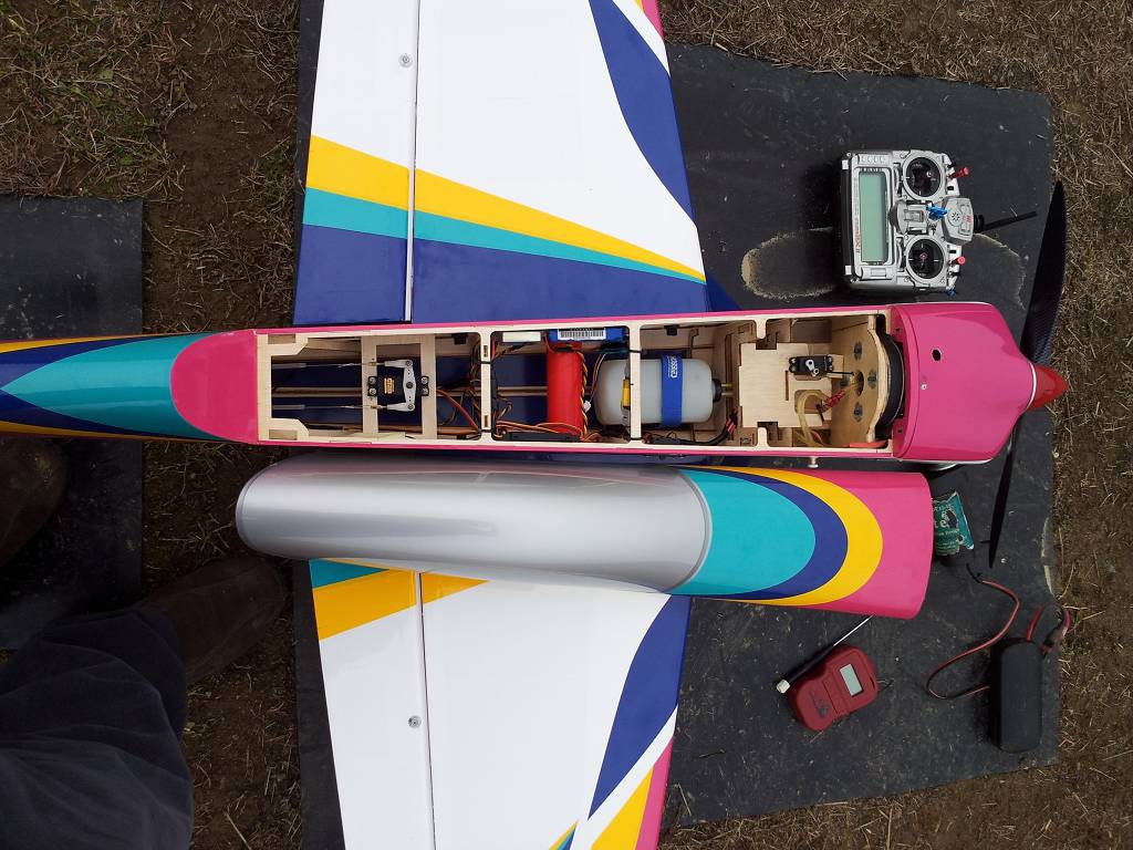

It is amazing, it works.
My dead DLE 20 gas engine is revived with gas/glow conversion. This DLE 20 engine fall down with signal loss. I guess the signal loss is due to the ignition noise even though this plane has been flown for many hours. The ignition power is supplied from Hitec Optima receiver. Many, that time, said that 2.4 GHz receivers are safe from a ignition noise. After signal loss, I conclude that the cause is ignition noise which affected the receive malfunctioned. During flight, throttle channel did not work, but all other channels were working, then I lost whole channels. The plane with high speed running engine crushed fortunately onto soft mud. The plane fuselage, receiver, fuel tank, ignition, spark plug and servos were scattered away, but the engine apparently looks fine. I took out it from deep mud and cleaned. Now I am testing with OS F plug on CM6/OS F plug conversion kit, and fueld with Gas/Glow mixture. Thanks a lot for fujiman who supplied the conversion kit to me, and all other developers in this forum.
Seeing is beleaving: http://youtu.be/N3Aspe8Tbe0
Regards to all gas/glow conversoners

Hi, Gas/Glow conversioners;
It is Spring.
It is good season to fly, now I have taken a video for my gas/glow converted DLE 20 on a F3A plane, Accipiter 90, which I choose because of only available here in the time.
To mount a China made DLE engine on Accipiter, four American-made parts were ordered from USA; a plug adapter from Fujiman, a back-plate from seaplanesupply, a wrap-around muffler from Jtechrc and a soft Hyde mount from centralhobbies. Thanks again to these four suppliers.
The Accipiter has short-engine room, so I attached another back-firewall for Hyde mount and stand-off mount (photo attached). And I installed a auto-booster for OS F plug and programmed to operate in low idle speed.
The engine and muffler were taken from the crashed plane which I mentioned above, so muffler is distorted and no ignition system. The Acippiter is good and very light for DLE 20.
For easy starting, easy management, very powerful and economical for fuel expenses I am very delighted for gas/glow converted gas engine. I am enjoying to fly the Accipiter in these windy days. http://youtu.be/Cyquiy6UTDo
Thanks for your reading
