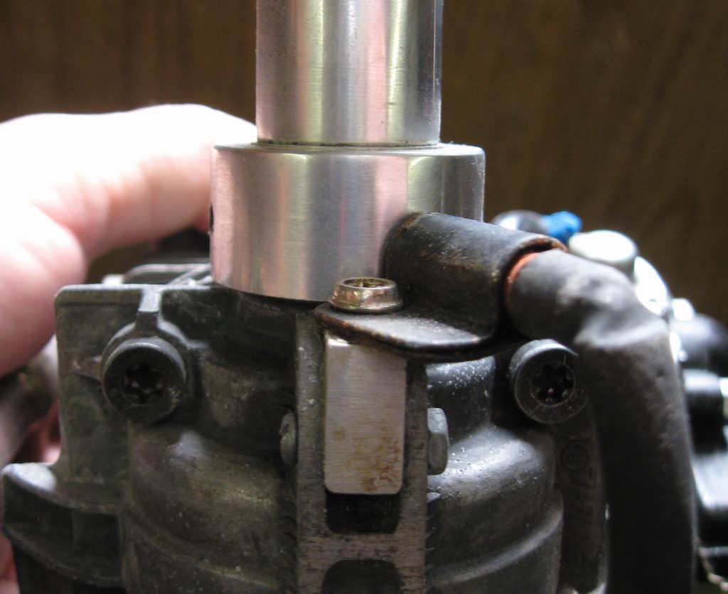

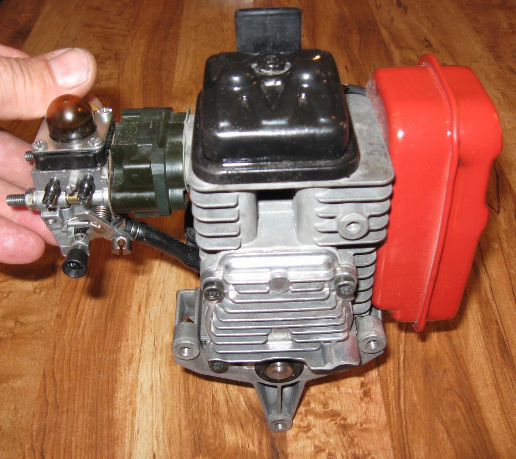

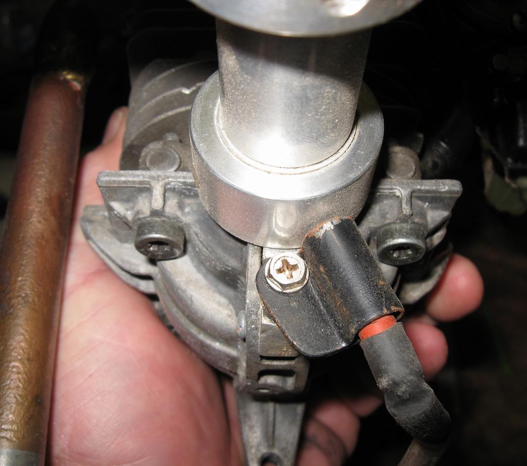

#523
ORIGINAL: SkyPilot101
Av8tor, did you use CDI on your 36cc fourmix? If so, it would be great to see a pic of the conversion. I'd like to do my 32cc and am guessing your 36 is very simular. Thank you
One could probably just mount an angle bracket of some type off the crankcase screw, but I think my way looks better. I made that piece of aluminum block to go in between two crankcase webs, bolted it there, and then drilled and tapped that block to hold a home made sensor tube bracket.
The pics embarrass me a bit because of the rust. I live near the beach and the salt air here is like "acid"!!!
AV8TOR
