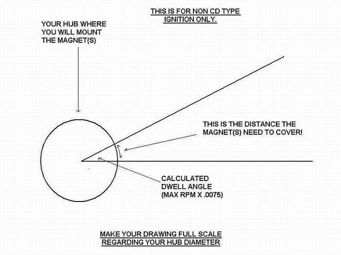

Sounds like you have a classic case of not enough dwell, about the only "downfall" you can get into with this system. You will find you will need to install more than one magnet. I have gone over this thoroughly with Jerry. With the one magnet, you do not have the coil "turned on" long enough for it to charge properly at higher rpm's. Here is a picture of how to easily figure it out.

I bought some magnets from Radio Shack.
They are .200 dia. by .060 thick.
I turned the flywheel down to 1 inch, and drilled for two magnets.
This increased the dwell to about 51 degrees.
I have yet to try it on the stand.

Sure, it will work fine. Just be sure you set it up correctly. See my drawing/explanation about dwell above. On a 42cc engine, be careful about kickback when starting with this system, as it has no automatic retard. But other than that it will work fine.
The only problem is that by the time you buy the system and the coil, you aren't too far off from being able to buy the basic CH Electronic ignition system dollar wise.
