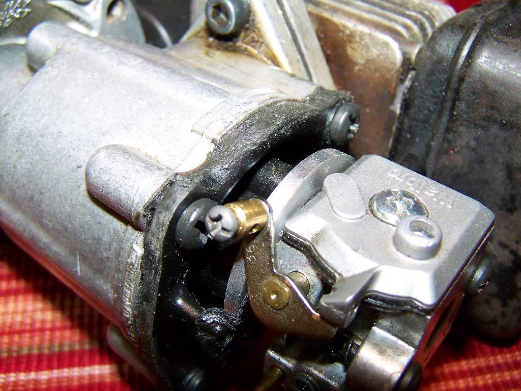

The HS check valve is a little brass spud sticking up out of the venturi right where the high speed fuel nozzle should be.
The accelerator pump can be spotted by looking at the throttle arm shaft. There will appear to be a device riding against a flat place on the throttle shaft.
There's another device on some Walbro's called a governor that is a brass spud (3) near the throttle arm(2). This is undesireable and is usually removed and the hole filled with a lead plug.

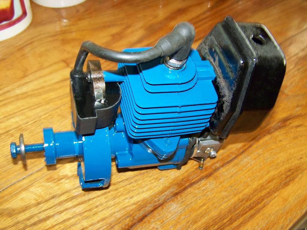

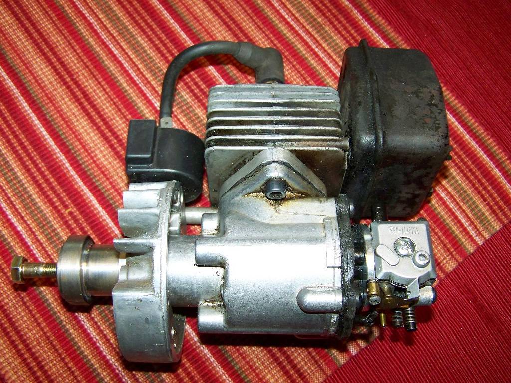

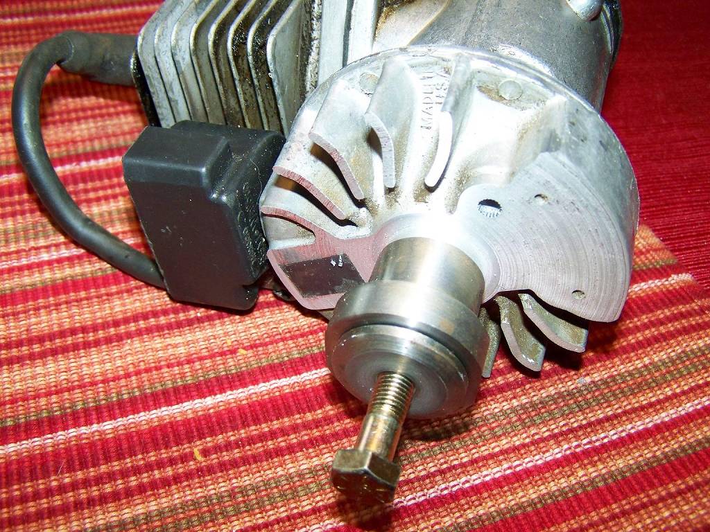

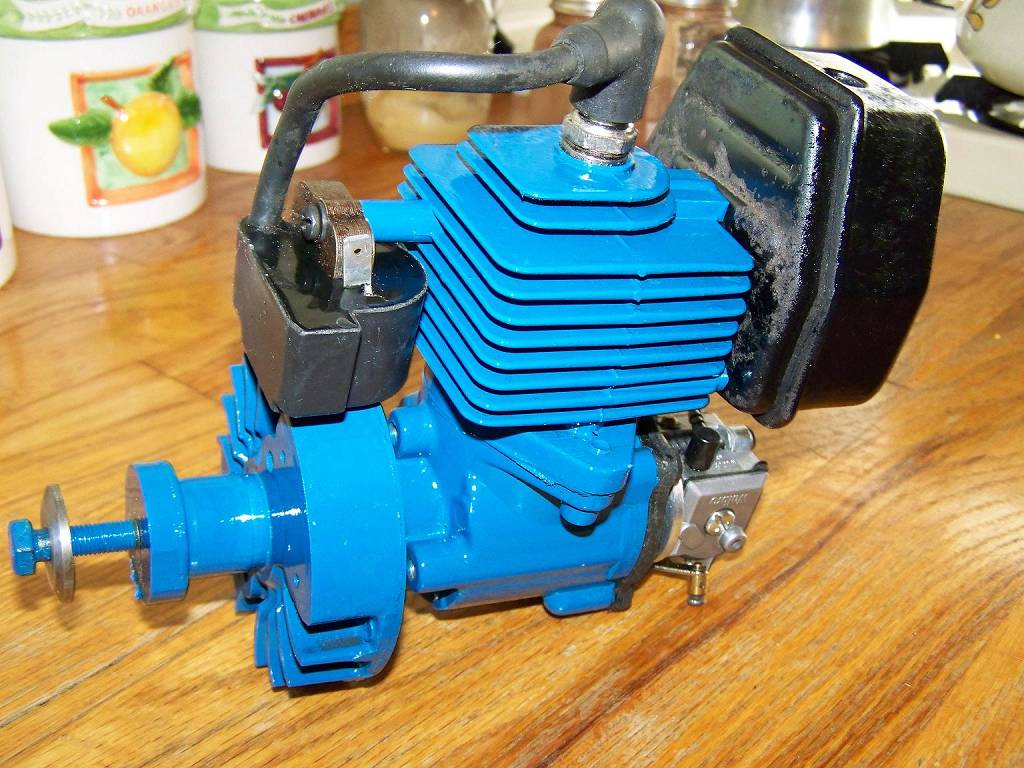

After running my long shaft Ryobi 31 in my Rascal 110 quite a bit in 2009......I decided I was quite happy with the way the ZAMA carb performed. The engine ran smooth as silk all year and produced some respectable power considering the engine is all stock. I earlier thought I might swap out the carb with a Warlbro, but I think I will leave well enough alone on that engine. I have another short shaft Ryobi project I am still working on, and this Ryobi has the Warlbro carb. So be interesting to compare the two. This engine is either going in a large profile plane or a 120 size Super Sportster I am scratch building.

Looks like a nice combo. I have a Ryobi on a 76" wingspan Tiger Moth, and also like the fact that the engine is entirely cowled. A Ryobi might work out nice on a 120/140 size Mustang as well....
