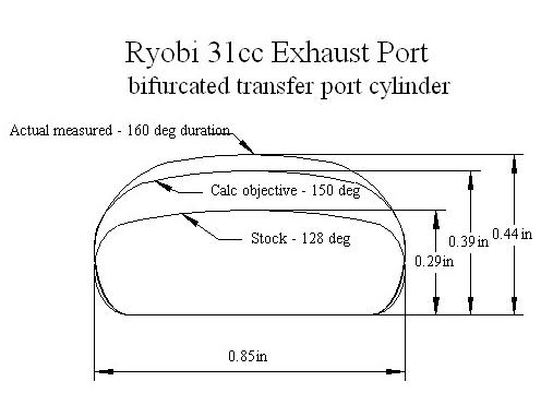

Ok I got my new test stand done today and here it with engine running on it.
I tried to test the exhaust timming mod today to. the best i could get was 7380 rpm which is down from the 7440 that I had been getting.
I had a static thrust of 13lbs 10 oz.
I dont know how acurate all this is as i discovered some problems.
1st my engine would not hold a steady top end rpm. it kept kind of searching and you could hear it do it to.
2nd I dont know how accurate my tach is after droping and repairing it. I have one of them laser tachs on the way to check against.
I am of the opinion that these hobby tachs suk pretty bad and are very general and not very accurate at all.
3rd I could not get a steady idle and it changes every time i run it. I discovered here that when i chenged the throttle shaft out from the old carb it lets it vibrate around and wear some slots into the edge of the butterfly valve. as you can imagine the larger they get the worse the idle. now i know why it changes ever time i run it also.
4th when i was dissasembling my engine again i discovered my spark plug was loose. what can i say but DUHHH!!!
I need to get thses four things ironed out before I am willing to make a good determination on the exhaust timming change test.
Ok also when looking at my rings it has spots in it that are shinney and other spots that are not and have a good coat of varnish on them. It seems to me if the rings are contacting all the way around the ring face should be shiney all the way around where it is in good contact with the cylinder wall.
This really makes me wonder how good of a seal i have with this ring cylinder combo.
Aviator1977 said it well in another post that this is a very basic important starting point. Its got me thinking on how do we figure how good a seal we are getting? I then remebered my airplane training and i havent had to do this for years but i think we could build some leakdown testers and check it that way. If you are unfamiliar with a leakdown test i will have this procedure later and we can all know where e are at cylinder seal wise. you can see how it works here to http://en.wikipedia.org/wiki/Leak-down_tester
At this point I have what i feel to be to many inconsistencies in the testing procedure that I am contemplating stopping this thread and starting all over on a new one. I guess the best way to look at this thread is it was a good education on getting a good consistent testing set up. I also need to purchase a new carburetor to. I think i will get a couplke just to have some on hand to.

BTW I've just completed an analysis, using Gordon Jennings two stroke tuning book, and discovered that for the bifurcated transfer port cylinder, the transfer ports are plenty big enough to give peak power at 7500 rpm but the exhaust port is not. I further determined that the duration number of 150 deg for the exhaust port, that's been mentioned by several, is just right if obtained by raising the top of the port 0.11 inches. This not only gives greater duration but larger area also. In so doing Jennings suggests an elipsoidal shaped port and proper radiusing and chamferring of the edges of the port. I'm looking forward to see what the performance gain really is. Even if one doesn't use the calculations in the book, his general comments on what makes two stroke motors work is very good reading.

Pitch can make a pretty big difference on static rpms. This is because when a higher pitch prop is not moving through the air, a good portion of the blade is stalled and causing a ton of drag. This is also why lower pitch props are used for 3D flying, as lower pitches are more efficient at lower, or zero, airspeeds. As an aside, this is also why high performance full size airplanes use variable pitch props.
I keep telling you guys, a Frank Bowman ring is the first mod to do after you have a free flowing muffler and an 11mm carb on a Ryobi. The second thing to do is raise the exhaust timing to 150 degrees.
Take a good used cylinder, sand it carefully with 400 to 600 grit sandpaper, and put a Frank Bowman ring in it. If your engine isn't sealing well, all the mods in the world won't help as they should. It is just basic good hot rod practice to overhaul a used engine before modifying it. Bearings, seals, and ring should be perfect first, then start modifying. An aftermarket muffler costs 30 to 40 bucks, a carb retails for around 40 bucks, an ignition system is 80 bucks plus, a lowly prop is at least 15 bucks. A Bowman ring at $12.00 shipped is a cheap investment, and they flat work.....
Once again, I have many times seen engines with moderately worn stock rings gain 600 to 800 rpms with a Bowman ring. The recommended ring gap for engines of these sizes is around .003", and I'm betting all of yours are significantly more than that.
AV8TOR

diceco said: BTW I've just completed an analysis, using the methods outlined in Gordon Jennings two stroke tuning book, and discovered that for the bifurcated transfer port cylinder, the transfer ports are plenty big enough to give peak power at 7500 rpm but the exhaust port is not. I further determined that the duration number of 150 deg for the exhaust port, that's been mentioned by several, is just right if obtained by raising the top of the port 0.11 inches. This not only gives greater duration but larger area also. In so doing Jennings suggests an ellipsoidal shaped port and proper radiusing and chamferring of the edges of the port. I'm looking forward to see what the performance gain really is. Even if one doesn't use the calculations in the book, his general comments on what makes two stroke motors work is very good reading.
I put the Ryobi back together after re-working the exhaust port and ran it up. It gained 255 rpm prop speed and 1.0 lb thrust; a significant amount to be sure! In the current condition the APC 18x8W turns 7630rpm and it pulls 15.0lbs thrust. These numbers are corrected to 59 deg F ambient temperature and 29.9 in Hg barometric pressure. The raw numbers, for those of you who don't believe in normalized data, were 7600rpm and 15.2lbs thrust. These were obtained by averaging three data points taken within about 3 minutes of each other.
The attachment shows a drawing of the exhaust port measurements; stock, objective (150 deg duration), and actual (160 deg). Unfortunately the port ended up being larger than I intended. A hand file is NOT a precision machining tool, at least in my hands!
A note of caution about porting the Ryobi. Gordon Jennings recommends cutting a shallow ramp leading away from the edge of the port, the purpose of which is to guide the piston ring(s) back into the cylinder wall from the bulging condition that a wide port might cause. I am certain he is speaking of doing this in an iron cylinder liner This should not be attempted on the Ryobi because of it's AC (aluminum chrome) construction. The chrome lining is very thin and no attempt should be made to cut a "ramp" in it. One should be sure there are no sharp edges in the chrome lining at the port lip, and do create an ellipsoidal port shape as suggested by Jennings. The bottom of the stock port is pretty much straight across. I very slightly cut the bottom of the port to make a slight curve in it's edge but this was only for the benefit of getting the ring(s) back into the cylinder for the last bit of travel before BDC. This will do nothing to the effective port area because the piston doesn't go below the bottom of the stock port at BDC. The slight cut to the bottom of the exhaust port is not shown in the drawing.
I also measured the cylinder head volume and found it to be 2.5cc. I then added the deck height 0.12cm and used the bore 3.5cm and stroke 3.25cm to calculate a compression ratio of about 9.5:1. Better than I thought it might be after hearing so often of those "low compression" weedie motors! Yeah it would be nice to raise the CR and get more torque but there is no practical way I can think of to do this. First off, the deck would have to be machined, then the cylinder base, but now you've messed up the port timing, so they would have to be reworked! Not worth the effort IMHO.
And one last test: After running up the motor on the APC 18x8W I switched to the Master Airscrew 18x8 Classic and got 260rpm more prop speed but 1.2lbs LESS thrust. NOT ALL PROPS MARKED WITH THE SAME DIAMETER AND PITCH PERFORM THE SAME!!
When I get a chance I intend to go back in my records and track the performance history and modifications of this motor from new-cut-out-of-weed-wacker configuration to the current configuration, which is about as far as I think I can go with this motor. The only other thing I might try is a free-er flowing exhaust system.

Pretty nice numbers. I only get 7360 rpm with a Top Flight 18X6 Power Point prop. Only mod is a larger bore carb. I'm using a Walbro WT-324 which is 11.1mm. I did open up the inside of the stock muffler some and put a 1/2" outlet on it. I've never had the cylinder off it so I don't know how the ports are in it. I would say it is one of the newer style low emission type engines so I may not get much more from it. What is the best gap for the spark plug when using EI? I've got mine about .020" gap. Any thoughts how to get a little more power out of this thing. I may need to get a new ring(s) from Frank Bowman. I've heard this will help as it has stock ring(s). I don't know if it has one or two rings.

Wow im suprrised you got that much of a gain. I didnt get anything like that in fact it didnt seem to make a difference at all. I dont think i raised the exhaust roof anywhere near the .110. It just didnt take that much to get it from 140 deg to 150 degree. I didnt do the eliptical port but stayed mainly with the original port shape. Did you remove the center bar? Its hard to tell as im having such trouble with my test equipment and am not gona make any more tests till my new tach gets here. I have some more cylinders so i should be able to do side by side performance comparisons. Thats a good idea on taking the average of three testing points. One thing that seems to be common on these engines is they lose a couple hundred rpm after running full speed a while and get hot. after cooling at idle and run back up it will produse the same results time and time over. I try to take my readings after it gets hot and the numbers stabilize.

jack how did you cc the head. I been wondering what the best way to do this is.
My muffler is stock except for a 1/2" piece of EMT electrical metal conduit welded into the original opening.
As for spark plug gap I'm not even sure what it is but .020" sounds about right. I don't think the gap is super critical.
Although I haven't tried a 11.1mm bore carb, mine is 12.7mm, I bet it's fine. av8tor1977 is using a 11.1mm carb to good effect.
If, in fact, you have the same set up as me, I would try the exhaust porting mod next, if you're up to it! The effect on my engine of the exhaust port mod was significant and if you want more power I'd try that first.
If you've got a different version of the Ryobi motor I have no experience and couldn't say what would be the best mod to try first. combatpilot has done a lot of work with the older style motor and might be able to give some input. If you read all the posts in this thread you might be able to glean some info on what mods work best and which ones are not a big pay off.
I noticed too that the engine sagged a bit for sustained WOT. On my runs I did let the motor stabilize but the time from pushing the throttle up to WOT and when I took data was probably only about 20 to 30 seconds. This is not a terribly unrealistic time to take data as the amount of time WOT is used in actual flight is only about that much too.
To get head volume I filled a small medical style cup that has cc graduations, with total capacity of only 10cc, with water and pored it into the cylinder, with spark plug installed of course, until it was just at the level of the deck. Then I looked to see how much was left in the cup. A real syringe would be even better. For the deck height I put a piece of bailing wire bent into and L shape that would reach to the side of the cylinder into the spark plug hole of the assembled motor and rotated it through TDC and adjusted the thickness of the wire until it would just barely rotate through with out binding up. The volume then is the area of the cylinder bore times the deck height. The total volume at TDC is then the head volume plus the deck volume, of course.

My motor is the newer style with the integral fan shroud, which I've cut off completely. It has the bifurcated (two runners per side) transfer ports and an exhaust port with no bar, and also a 2 ring piston. If you take off the muffler and rotate the engine you can see if the piston has two or one ring and also if the exhaust port has a vertical bar separating the port. The two ring pistons are good. The ring end gaps are very small (I haven't actually measured it) and seals very well. If you then take out the spark plug and shine a light into the cylinder and rotate the crank until the piston is at the bottom of it's stroke you can see the transfer ports and determine if there are one or two on each side. The only complaint I have with the bifurcated transfer ports is the large blunt forward facing edge at the opening to the ports. I made substantial modification to this area in attempt to smooth the flow going into the transfer ports from the crank case. Unfortunately I did not get back to back performance data for that mod. See posts #134 and #145.

Did you remove the base gasket or just leave it in? I'm not real keen on messing with the exhaust port. I might screw it up and I don't have another cylinder if I booger it up.
