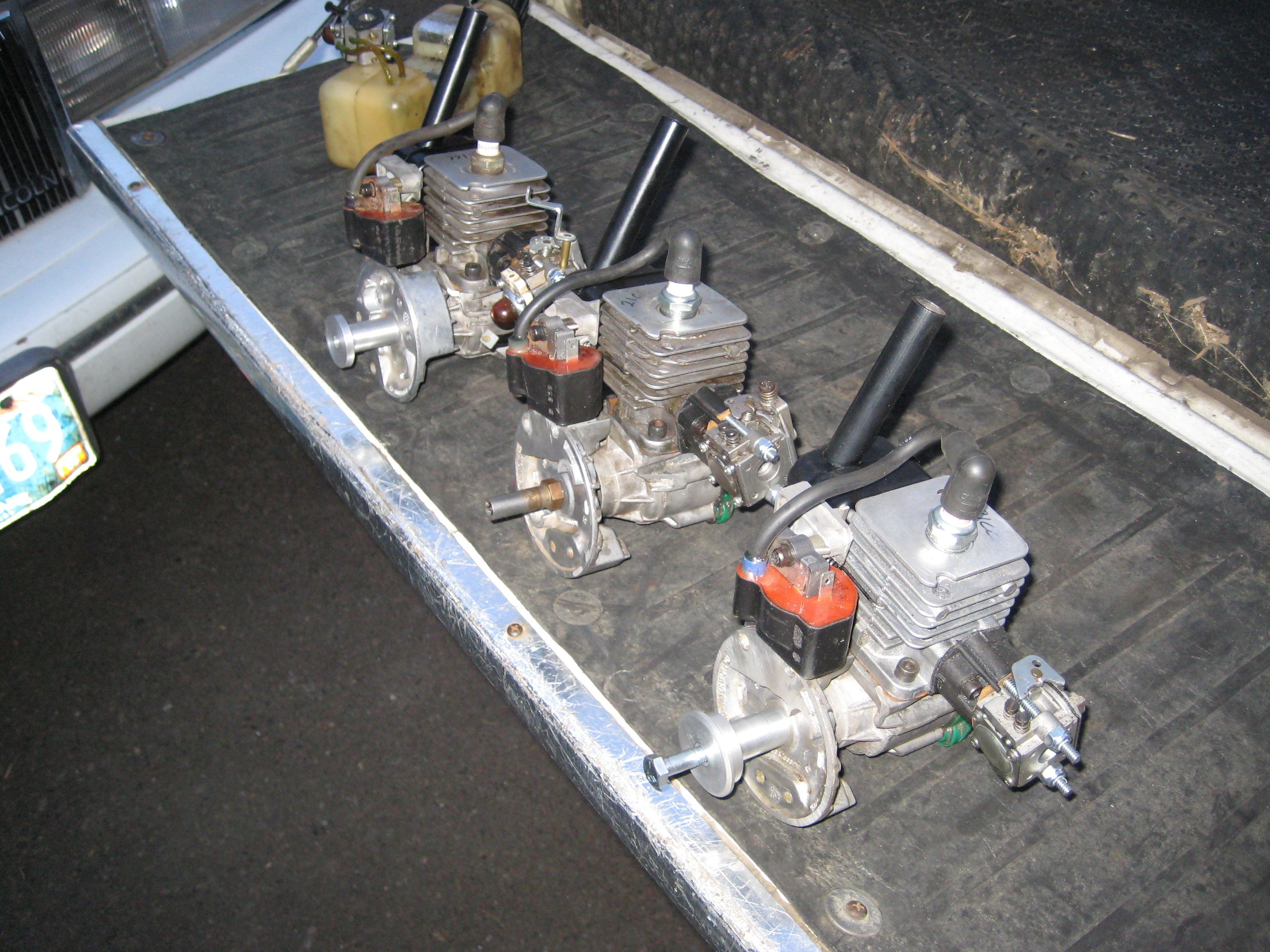

just turning the flywheels down in a lathe doesn't remove that much weight (a handful of grams I would guess), a better bet is to take some pliers and bust off the full fins that oppose each other, I leave the base of them (1/32") as to not weaken the support they give. I try to do it as even as possible, they end up coming out close to balanced. I recently got a Dubro balancer to even them out, works pretty good with some work to get the hub to center.
zoom in on the attached image (if it worked, haven't used the new upload thing yet) and you can kinda see what I do on the poulans, would be easier to see if they didn't use backwards flywheels...

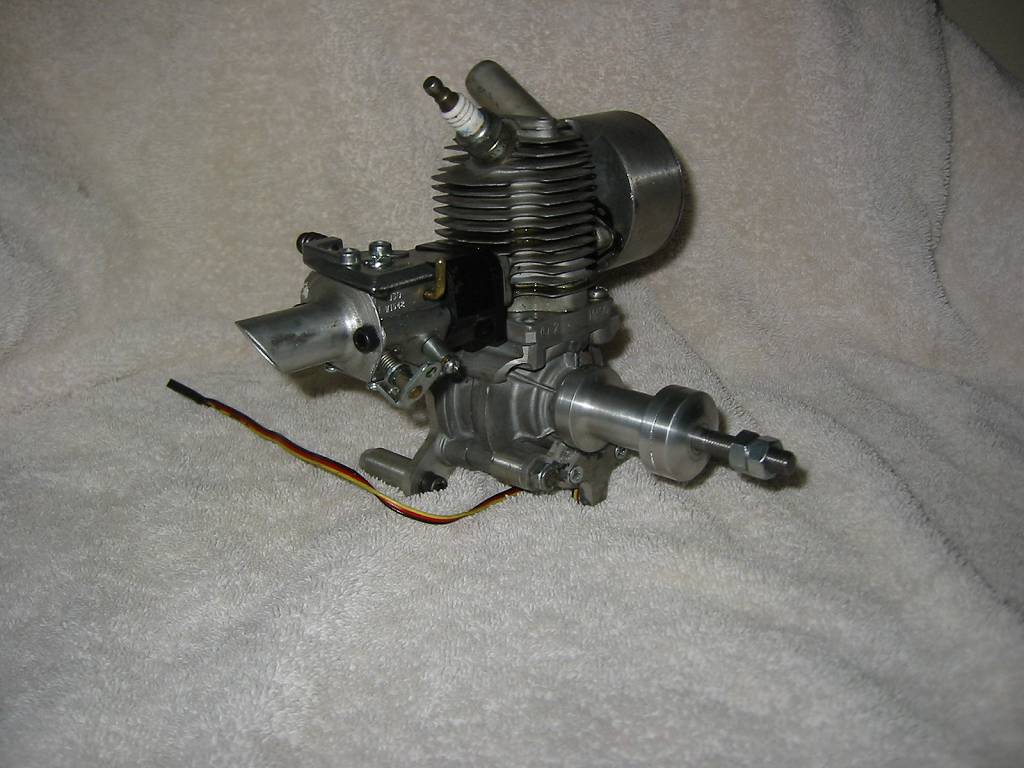

Heres a couple of shots of the flywheel after I surfaced it down on my sander and a shot of the engine with the motor mount hanging off the firewall. I have to order a prop balancer to balance the flywheel. I hope the muffler being that close to the firewall does not start a fire. I used a piece of 2 1/2 inch aluminum fence post to make the mount.
Old 05-16-2010 | 10:02 PM

The only thing I see with your flywheel, that may be a concern. It appears that you buffed the center of the flywheel. Thats the area that your prop adapter will ride. If that area is not true it may cause your prop adapter to not run true and vibration may result.
