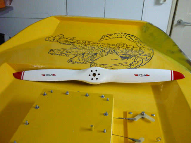

Maybe some-one can help me, I need a fiber propellor for the airboat.
It's hard to get one into the Netherlands of this format 20x8 or 20x10
I need a address or maybe somebody can buy it for me (I pay back !!)

Thats 4" less......I don't know how this lookslike into the cage.
The cage is made for a 22" propellor, now using a 22x10
I think a tiny propellor is given the boat a Mikey Mouse look (?)

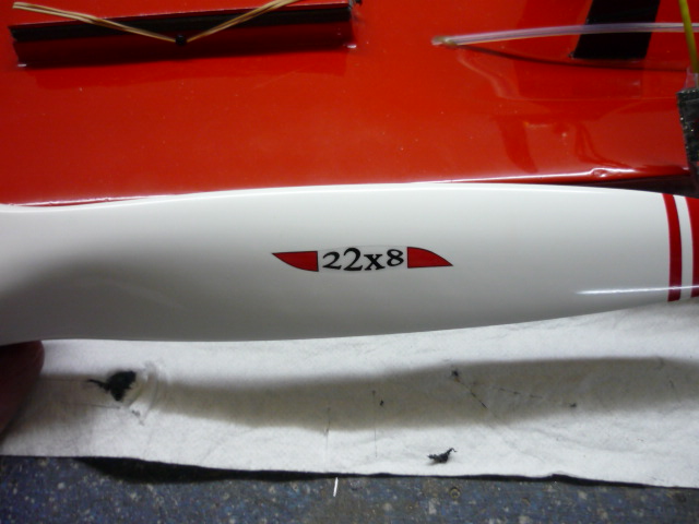

This prop is a little to big for the cage, I've only 1/2" on the tip of the prop befor it hit the cage.
@ i7x58,
They will send the props to Holland but it cost to much, almost twice the cost of the prop.
Handling, shipping, pakkage, tax, aso.
Others notice me for Hobbyking but I can't find the right size.
(I can't resize the pics....)
