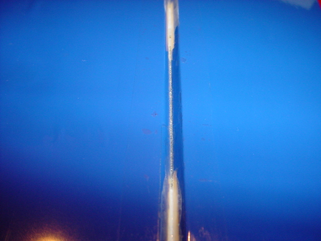

I use CA hinges on most planes....but I use twice as many....keep the gap
real tight, and use clear mono-Kote on the hinge lines. Works for me.
The mono-Kote is all but invisible.
FBD.
