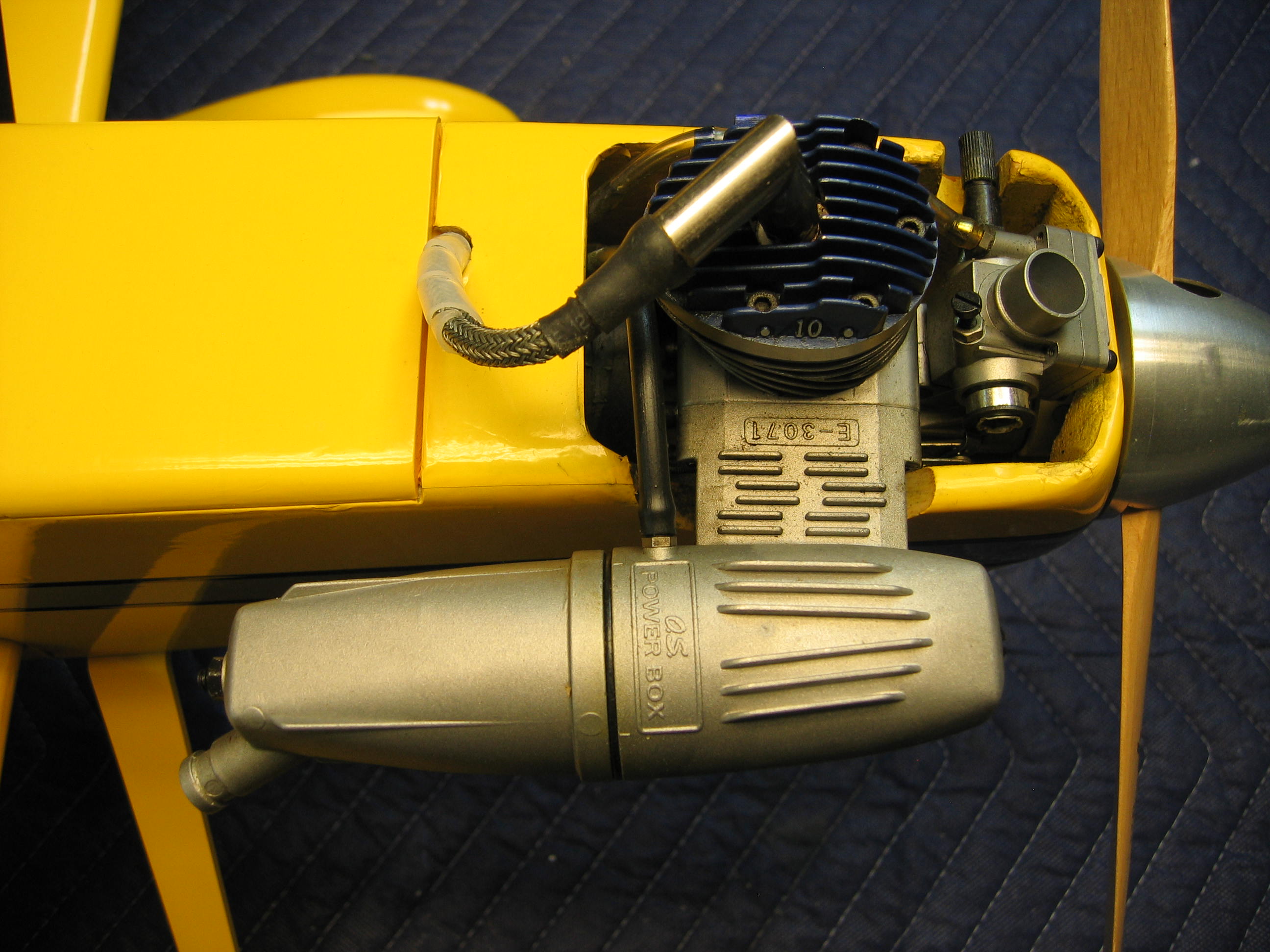

A black carbon/oil mixture leaks from every muffler joint including the center section at both ends, main central bolt head and rear nut. The leaks make a mess which is hard to clean - plus it looks like crud. I wanted to weld it solid but the center section is SS so that won't work. Tried steel epoxy. Tried high tem silicon gasket seal. Tried small "O" rings in the center SS joints. Maybe there's tricks that make one of those work? Any ideas?
A friend said there's OS muffler that will fit. Any info there?
Question. Is the center section of the muffler designed to "tune" the exhaust system?
Is anybody making a replacement part that can be welded to the body sealing it for sure?

My muffler actually came with two orings, one for each side of the center section. My center section is made of aluminum. I cut it down to fit my plane. Havent ran the engine yet to tell if it is going to leak. it was posted earlier in this thread that removing the center section would reduce performance. The guy I work for said as soon as he looked at it that it would not stay tight. Seems the different types of metal will expand differently causing the main through bolt to come loose.

Good. Thanks! Did you by chance check top RPM with the different mufflers? I believe that the stock muffler center section was put there to "Tune" the exhaust for higher RPM. That's the reason for the question. Do you know if the OS 55 or 61 will fit also? Ken

Good idea pope. McMaster Carr is a super supply house for that kind of stuff and I have calipers to measure the tube. It's SS and I hope there's a alum equivalent and I don't have to buy 100 feet to get 1.3 inches of the stuff. Hi!

I just bought my engine less then a month ago and it came with 2 orange o-rings for each side of the extension. I cut the extension in half and had to put it in the lathe to machine in the stepped down section and it was aluminum. No you have to wonder which metal is the improved version?

Generally things workout cheaper if you can get stuff off the rack . I couldnt see evolution getting stuff made especially when there's something thats going to do the job thats nearly the right size . I have one of these engines with the macs muffler on it and dont know where the oem one is to measure ( always a option for you and may even be cheaper if you need to buy the tube and get someone to weld it . Most fabricators and welding shops have a minimum charge to keep time wasters away . When I was doing this for a living I would always say that I may fix it or f@#ck it just in case the stuff wont weld properly which maybe the case in this instance .If it was me I would get the macs muffler and leave all your troubles behind . Good luck with what ever path you choose from the pope

Plus they want $49 and shipping. Thanks for the idea and it's a good one. I'll call them to see what the problem might be in using one on a gas motor. But you had success so will see. I understand the welding situation.
Does you motor still have black goop exhaust? I've been using a "blend" oil. Will all synthetic help there do you know? Ken

The OS mufflers are better and don't leak. One thing i noticed is that the OS through bolt is 2-3 sizes bigger in diameter. I would drill out the POS evolution and try a larger diameter bolt if i couldn't find an OS muffler. Once you get a muffler that doesnt leak it runs so much better. Come on Horizon fix the problem....
