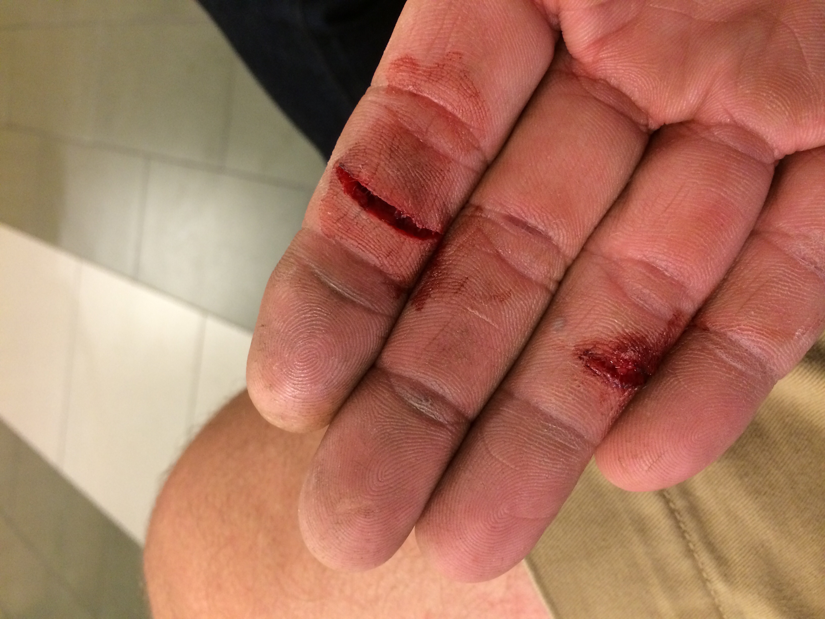

Yes, I changed the plugs, twice actually. Sat in the ER for 6 hours and the gunshot victims kept piling in, so I never got checked out. Here's a pic.
Know that feeling well, but only once, got me a starter after my first prop bite. Hope that cut don't hold you back much.

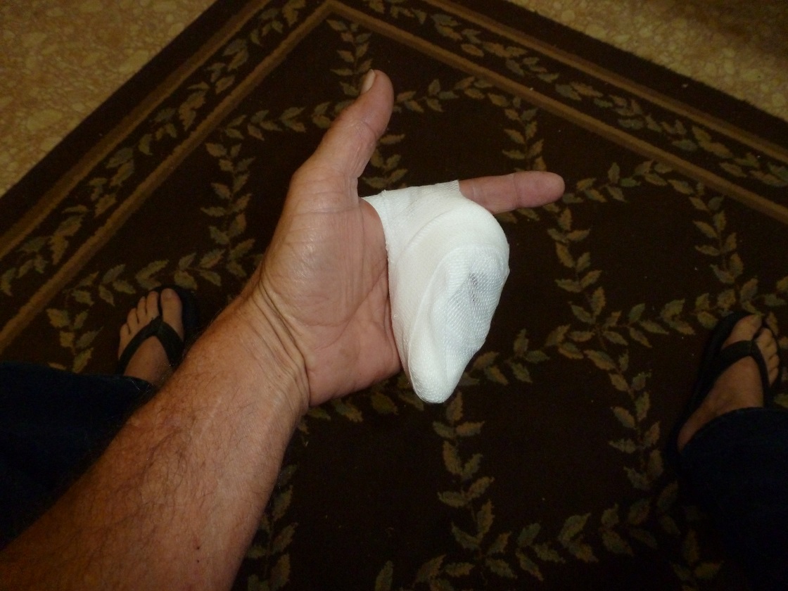

Know that feeling well, but only once, went and got me a starter after it. But the prop is not the only thing that can bite, aluminum around the cockpit can hurt real well also. Sliced three down to the bone.
