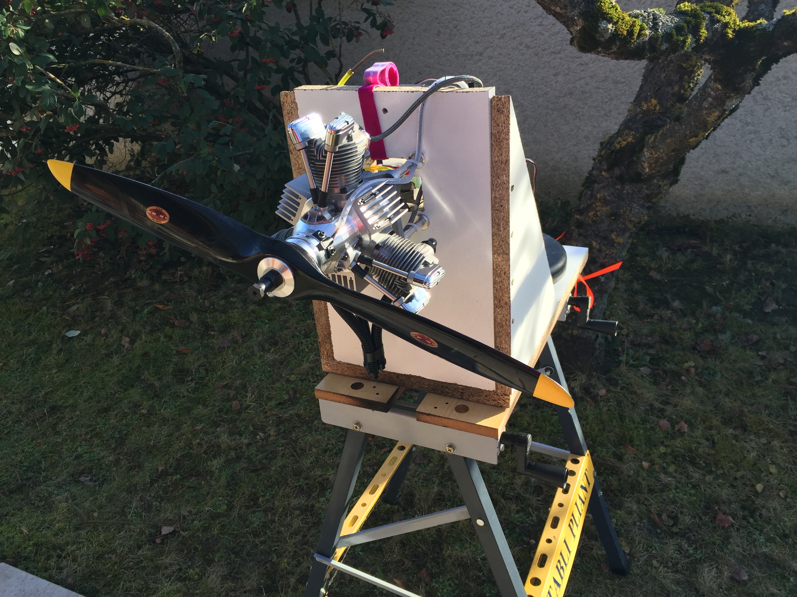

Hi,
I have already started the break-in of my FG90.
It seems to be a long story !
The 3 cylinders do not run evenly from the beginning and also each temperature of
the 3 cylinders do not rise evenly.
The third cylinder stays almost cold and spits out white smoke erratically.
https://goo.gl/photos/bcMpTK2AqFpDD78c9 https://goo.gl/photos/wdaHKDFonHcNfvFm7 Any idea or comments ?
Best regards,
Alain
ID:	2198813   Click image for larger version
Old 01-29-2017 | 10:46 PM
  #46
Joined: Apr 2009
Posts: 30
From: Taipei, TAIWAN
https://youtu.be/-RTwzPTGRRE
Try it this way, it will help your entire break in procedure
more evenly for every cylinder.
jeep36 (02-26-2021)
Old 01-30-2017 | 03:07 AM
  #47
Joined: Jan 2017
Posts: 18
Hello,
I do not understand what do you mean, how your way is different ?
The fitting of your engine is not so common in my part of the world
I am following the break-in process explained by Saito, no more no less.
Alain
Old 01-30-2017 | 10:24 AM
  #48
My Feedback: (8)
Joined: Sep 2004
Posts: 3,821
Received 41 Likes on 37 Posts
From: Springdale, AR
Nice idea....how did the cylinder temps compare?
Old 01-30-2017 | 10:25 AM
  #49
My Feedback: (8)
Joined: Sep 2004
Posts: 3,821
Originally Posted by raptormasque
Hello,
Alain
It's all about gravity my man
Old 01-30-2017 | 11:53 AM
  #50
jws_aces's Avatar
My Feedback: (33)
Posts: 1,048
From: Salem, Va
Hi,
Best regards,
Alain
I have the 84cc motor and love it. I did have the Ray Mod motor but it broke. Please don't ask or go read the 84cc thread for details. If the 90cc is like it. I found that you have to break it in just the manual said. Real Rich so it doesn't rev many rpms at full throttle. Burn 2 tanks like this. I set my needles based on the highest temps on the ground with no cowl. It runs real nice with a little bit of popping during transition. But it now has over 20 flights and it is living.
FYI it likes fuel. My needles came out to 6 high and 4.5 on the low needle.
https://www.youtube.com/watch?v=C7kIlT71QW8 Make sure you baffle it on a plane with a cowl. Keleo has the baffles cheap pre cut.
