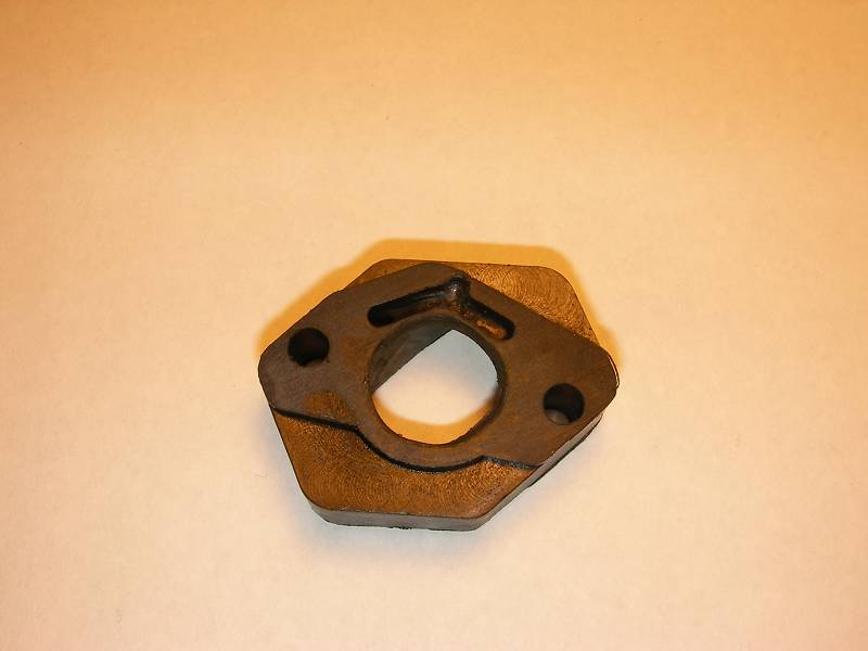

Well, I used the same gaskets for the new carb that was on the old carb. Must be blocking the pump hole some how. I can’t wait to get home and tear it apart to check. The suspense is killing me. I have the GP Extra 300S and am lacking just a little power for hover. This plane weighs a ton. I am going to replacing the ignition once I get the money. She ran great with the stock carb, but I am always looking for more power. I am also getting a MA 20x8 Scimitar wood prop and a carbon fiber landing gear and wing tube for less weight. Every ounce counts. I am currently running a 3W 19X8. I will post what happens tonight after I check it out. Thanks again.

Ok, got home and checked the carb. Sure enough the gasket was turned around and blocking the hole. Bolted it back up and wouldn’t you know it, I stripped out a thread on the block. So after I cooled down, I took the double lock washers I was using off and bolted it on with one. Fired right up and tuned in pretty well. Still doesn’t sound right to me so I will be buying a tack this weekend. Throttle response is super fast, but holding it at full throttle, the RPM's seem to slightly change every so often. I will run some more gas threw it this weekend at the field in the air. Didn’t have much time to run it more tonight, but has a lot more power, wow. This is my first gasser so I am a little new to these. Thanks again Pianori for your help.
#32
This is what the plastic intermediate connector looks like. The pump hole is not lining up with the opening on the plastic piece that is why you are getting non consistent rpm at high throttle. Look at the picture so that you can see how I have modified the rail so that it can match with the whole at the carburetor. [img][/img]
