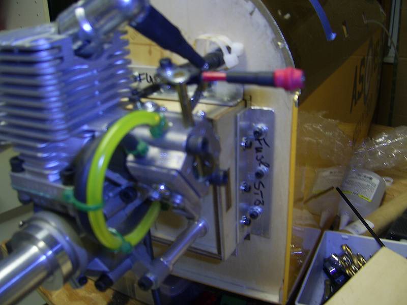

Have you got any pics of your fuel line setup? What system are you running?
I am looking at a 2 line system with a "T" connectors, but what stops the fuel running into the carb and flooding it during top ups?
I was going to use a valve as thats what I have on my glow planes but was told not to on gas planes. (of course I'd buy the valve gasoline fuel)

I use three lines. top line is vent. comes out the front, clockwise around the tank and back to the front then through the firewall and out the bottom of the cowling. this is so if your plane is nose down the fuel will not run out the vent and cause a fire or mess. the second port on the tank is a single line out to a fueler. make sure it is gas rated(red). this line has a klunk inside to defuel if you choose to. the third line is klunk to line through the firewall, inline filter and direct to the carb. attached is a pic of the carb and fuel lines. the one is from the tank and the other is on a blind nipple and goes to the fueler. in an emergency I can switch the two carb lines and I am back in business. such as the main ckunk plugging up or filter plugged. fly the rest of the day and go home and fix it.

I'll stick to the 2 line system for simplicity as just spoke to a guy at Desert Aircraft, who are just around the corner from my house. So Line from tank to T connector and and to a fuel dot with filter in the carb line and the other line as a breather.
BTW something I didn't know was the Desert Aircraft ignition systems are made here in Brisbane Australia! Mmmm, wonder if they work on SPE engines
Will post some pics when done.

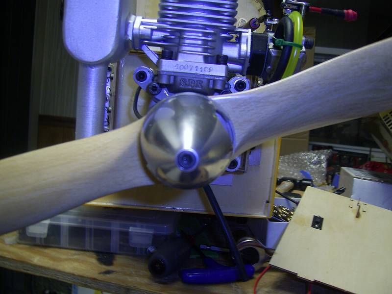

How did you go with the velocity stack? I noticed Eric has on his GP Extra. I bought one as well and had to use the same bolts as the ones supplied by GP are the wrong thread, plus I used different spring washers.
I have noticed the choke doesnt close 100%, maybe 95% due to the velocity stack. I dont think its going to be a problem as the half choke setting is fine and the full choke setting will aslo be fine to prime the engine. I thinks [&:]
Should finish up the tank and plumbing today and going to the LHS to buy an APC 18x10 to run the motor in (with about 4lts of fuel)
Got my elevator servos but still waiting on aileron, rudder and throttle servos.
