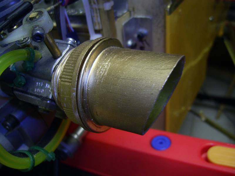

here is a velocith stack I made so it could be installed AFTER the cowling was installed. they come in various sizes with screw threads. they are usually free. you can paint to match like I did for my gold colored cowling
ID:	758391   Click image for larger version
ID:	758392   Click image for larger version
