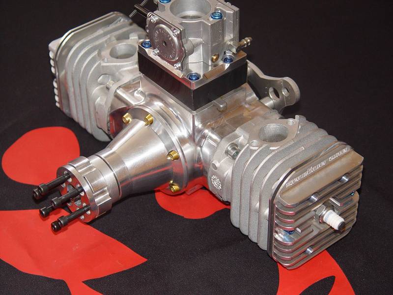

Hey I feel left out.. How about the Evo 150
and not evolution, two different animals.
Roger
