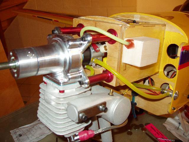

The problem I am trying to avoid is a DA 50 (any gas engine) running poorly at less than ¾ throttle to idle. I have seen a DR 50 dead stick in an inverted harrier, low throttle and not many “G†at that point at my home field. I still don’t believe what I saw. I am also trying to achieve no RPM changes at any attitude. My other gas planes have a tube running into the fuselage to prevent this from happening but the fuselage is sealed. This trick goes back to when gas chain saw engines were used in RC. Nothing new here at all. The balsa box is a cool idea and I wish I came up with it first. I do not have problems with G’s on any on my planes. Gas engines should not stop in the air and are the most forgiving engine you could install in a RC plane. If you are hearing a slight change in RPM during upright to inverted you need to install this tube. If you are always messing with the HI and LOW needel setting like it's a glow engine then you need to try this. Set you engine up with out a cowl and then install the cowl and it runs different...you need this tube. Some pilots do not here or care about this. Maybe only 5% care? It is worse when most of the flight is a reduced throttle. The cost of a diaphragm is cheap compared to the cost of dead sticking a plane off the field. The diaphragm moves with every stroke and if I am running at less than ½ throttle I should have longer life.
srm99, what is with the ALL CAPS and I watched you video of your WH Extra on a DA 50 dead sticking in level flight what’s with that??? OH ya you might want to edit out kicking little kids on the flight line from your videos. We need pilots to keep this sport going.
http://media.putfile.com/Extras-Lucky-Escape

Food for thought My Evolution 58 comes with a fitting on the carb plate from the factory you run a line into the fuse.

All I know is my own experience and running the diaphragm cover atmospheric pressure hole to inside the fuse made my engine run the same in the air as on the ground, perfect idle, smooth transition with no burble all the way to WOT. Mine DA50r used to go lean inverted and I was always concerned it was going to quit. Now no matter what attitude, what maneuver the engine now runs perfectly. A simple thing to try IMO. Good luck.

srm99, I realize you are sincere in your belief that turbulence around the carb doesn't matter, however, I don't agree. I have on two different planes had to run a static line from the carb to the fuse. You mentioned trying without a cowl to see what happens....I did that and my plane ran as well in the air as on the ground but put the cowl back on and it just sputtered in the air. I ran the static line and solved the problem...easy.

Well guys I just got back from the flying field and the DA ran great out of the box. I used the needle settings the way DA set them for the first flight. It ran a little rich as I would expect. It ran exactly the same in the air as on the ground. I did only one tail slide at idle and no problem going back up on the throttle. Knife edge left or right and in down lines no change in RPM. I had instant response to the throttle stick with even the rich settings. Did an upright somewhat flat spin at idle with no problem. Far as I am concerned the balsa box works great. Only 10 minute flight and how I am going to set the needles and that is the end of that.
Thanks jongurley great tip

I was so happy it ran good I forgot to tach it but it was not moving on the ground and it was set lower than my G 62 with electronic ignition runs at (sounds slower) Once I get the card set I will tach it. Hay if the plate works just go fly. I did not advance the trim on the TX to up the RPM in flight. I had good breaking when I went to idle in the air. Sounded very very slow. I would guess the box is helping that low RPM. ROCK solid. I removed the tube to the box (on the ground) and the engine ran the same when the cowl was off. I was at a higher idle at the time so I did not test it for how low I could go. I just put the cowl on and started again. Very smooth motor at idle.
I have been reading the Walbro Service manual from "srm99", this is a must read guys.
So far the only thing I get out of it is that the carb is very sensitive to the inernal adjustments and if I read it correctly also the diaphragm. There may be a spring tension that will work in your cowl set up but I see no way to get a good running engine with out alot of different springs and flying to check it out. Everyones plane would be different depending on cowl cutouts. I do have a older plane I can test this on.
Side note: I used contest grade balsa 1/16 inch. I did not seal the balsa. I am at 550 feet above sea level I would think the balsa will act like a filter and will slowley adjust to changes.
