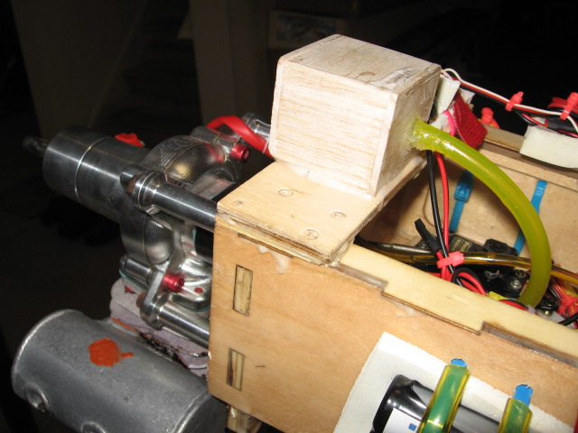

Ok so I was bored today and decided to join the balsa-box club..I had a spare backplate so I did the mod..my engine runs good now but I figure it cant hurt to try it..maybe it will run even better

I will report back..The only issue I have is when doing an inverted elevator, when I throttle up there is definitely some loading up but not enough to put out the plug..my idle is about 14-1500..the same thing happens when exiting a knife edge but its very minor..Ive never had or came close to a deadstick..Im wondering if the box will make any difference in regular flight?

Well Im happy to report another balsa-box success! Works excellent! The carb plate worked pretty good but there was still the occasional loading up while inverted but with the box its completely gone..no loading up at all inverted..in fact you cant tell ANY difference between upright and inverted flight..I tried to get it to load up by doing long inverted elevators and rolling from inverted to upright and it never missed a beat! If anyone is having those issues..the box works!!!

What about when you are at a constant throttle setting (engine running fine in the air level) and you start to knife edge or roll inverted and your engine goes rich and starts to 4 stroking when it did not just before at the same throttle setting???? Not pop off pressure, adverse cowl pressure.
This is what I experienced and so have many other people. In this scenario you would have to raise the pop off and some of the 50's are hard enough to get rich on the high end anyway.

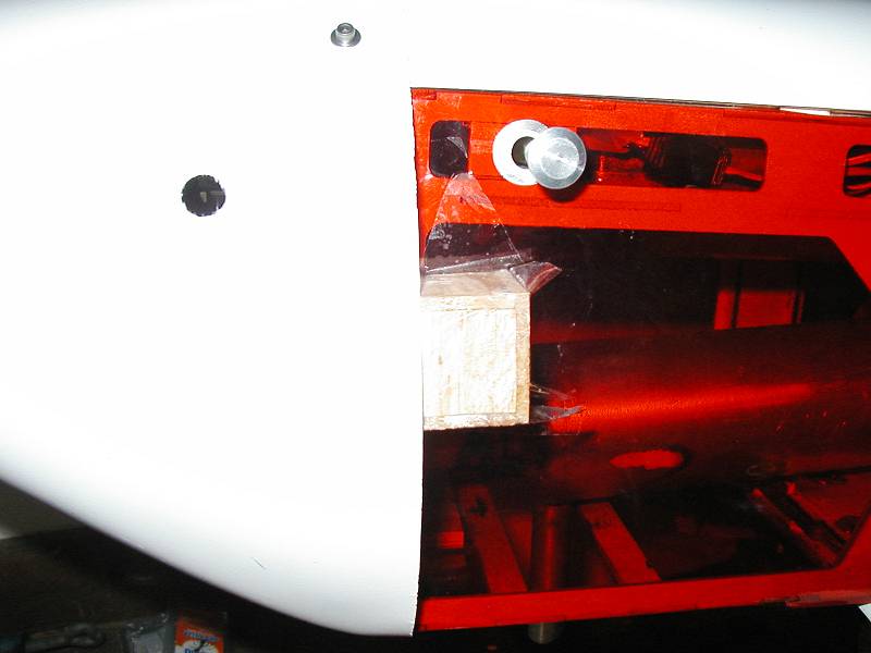

I did have that problem with a 3W rear carbed engine. When I first tried this experiment I just taped the BOX to the side of the fuse to try it and it worked. I could not find a non pressurized area in the air frame.
People have been trying this since I suggested it over a year ago here on RCU. There were a few threads before and I do have witnesses that can corroborate my claims.
