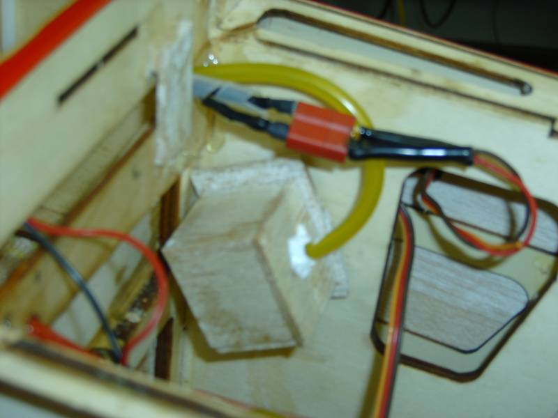

Someone here on RCU had a 3W that was loading up on knife edge, he made a small 1" square box out of balsa and ran the carb plate vent line into it. Solved all his problems. That's what I would try with the DA50.

Thanks for the suggestions DICKHANSON and nonstoprc,, O.K. since it is storming and raining like crazy here in North Carolina I took and did the carb mod just a minute ago, don't laugh at my mountain of solder I was by myself so I had to get buy, I soldered over the side hole in the cover and drilled out a middle hole in which you can make out(poor quality pics) the brass tube, then I built a small 1-1/2 ??? balsa box and mounted it in the fuse,,, I took and sealed the fuel hose into it,, anyway pic one is my mountain of solder and the brass tube, pic 2 is the box mounted in the fuse,, tell me if I did something right or wrong I think i is par everyone elses but I am not 100%..
My Feedback: (29)
Joined: Apr 2003
Posts: 2,834
From: Goldsboro, NC
Will do,, I took and put a small drop of ca to hold the brass onto the plate dead center,, I then got a drop of solder on it, and then I just went to town soldering I first of course roughed both the plate and the brass tube with a dremel I then soldered and let cool then I tried to pull out and it was dead solid,,, the I just built in about 2 minutes the balsa box and put the tubing into it and put RC56 canopy glue around it,,,,,,
My Feedback: (41)
Is it possible that the inside of the fuse can pressurize and cause the same/similar problem as the inside of the engine cowling (pushing on the vent side of the diaphragm)? Whether or not there's a box around it? The more air speed the plane has the more air that can go inside the fuse to pressurize it? Just an idea, I could be totally wrong.
,,, told you guys he is divorced,,, anyway,, if anyone has any pics of the carb plate mod, I would greatly appreciatte it,,
