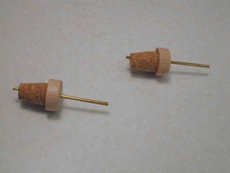

OK farmer approach. Take a cork that will fit the end of the elbow. Drill a 1/8 hole through it. Stuff in carb. flip till it pops remove cork and start. Adjust hole size utill you have prefect choke.

Hey Larry will those stoppers work on the 46 brillelli, my buddy or caller for the IMAC contest I emailed you about me flying the other day, he has the Brillelli 46 polished right pretty engine, he is going to have it on a ULTRA HOTS he is building, but he won't quite have it ready for the contest so he is going to help me but any way that is a good idea,,,

jongurley, I don't know any reason they wouldn't work on a 46cc. Originally, I was just plugging the carb throat but that flooded the engine. So I drilled through and stuck a brass tube through and it worked out.
aerobob, I'm not having a problem cranking my 25GT and the more I run it, the easier it is to crank. However, I must say that all engines don't act the same. I have two other gassers and from a cold start they will crank with fewer flips than the Brillelli. With the Brillelli from a cold start, I open the throttle full, stick in the "choke", turn on the ignition and flip maybe 8 or 10 times until it fires. Then, remove the choke, throttle down to maybe two clicks open, maybe 4 or 5 flips and it runs. I don't think that's too bad but it ain't perfect. I'm not complaining.
