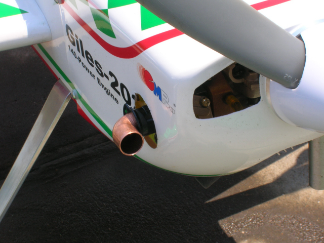

Thanks for the info aerobob. I was pretty sure it would change in the air and for the worst so I thought I'd set the high end just a little on the rich side but if you have already tried this then I may be wasting my time. I'll give it a shot and see what happens. Nothing else has worked so far.
#81
My Feedback: (10)
aerobob,
I pulled the plug and checked the color of the ceramic on the plug and its a tan color and black around the outer bottom surface of the plug. I'm really hoping this works so I can get some serious flying in
. I don't know why I'm the only one having trouble with air flow. Jstanton has the same plane with the 25cc and has no problems and plenty others were the velocity stack sticks outside the cowl. I'll just keep plugging away until I figure it out.

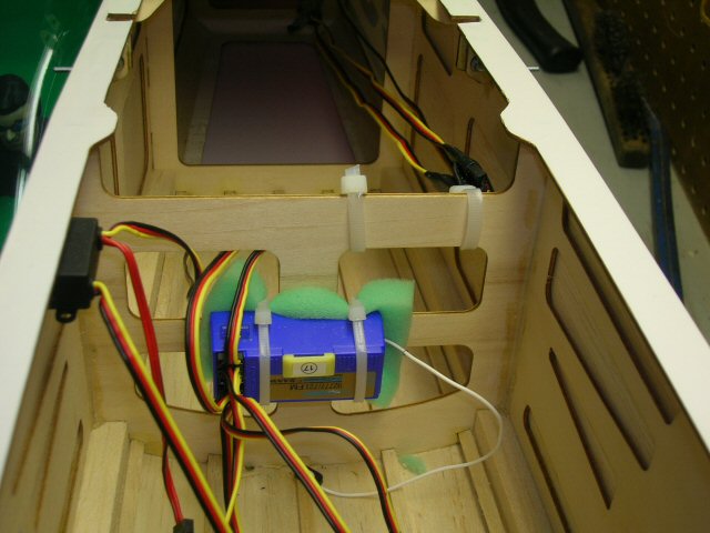

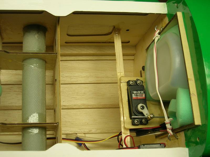

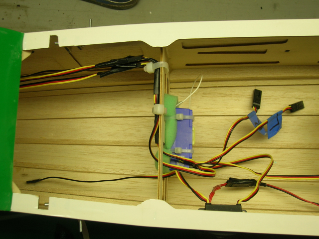

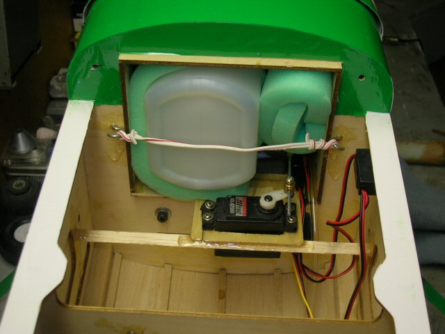

Zippi - can you post a pic of your setup inside the fuse? I'm wanting to get a good idea of where to mount everything for decent balance.

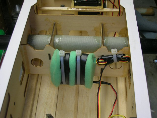

I took some pics of the inside my fuse adrenalnjunky but right now the server for RC Universe is not letting me upload any pics. I'll try later.

Zippi, you're not alone in having turbulence problems. My 25GT still goes rich in the air and I have already run a static line from the carb backplate into a "balsa box" so I know there is no turnbulence there. The only other place it can be is the velocity stack and I have left it on because I need to choke the engine to crank.
I think I will try turning it backwards to see if that will make a difference. Lately, the weather has kept me from doing much flying, maybe in a day or two I will try.
The copper elbow looks good, what is keeping it in the stack? Certainly some impressive numbers, rpm etc.

I used a dremel tool and sanded the copper elbow down just enough to have a real tight fit. With the plastic makeshift piece I used I tried turning it around on the velosity stack and it made the engine run worse. I'm going back out to the flying field this morning to do some experimenting and see what I can come up with.

The pics of inside my fuse are now posted about. RC Universe fixed their upload problem.

#93
ORIGINAL: adrenalnjunky
Is the green foam next to your fuel tank your Ignition battery, or the Ignition module?

adrenalnjunky,
The green foam next to the fuel tank is just green foam to hold the tank in place. My EI box and battery are in the engine box.

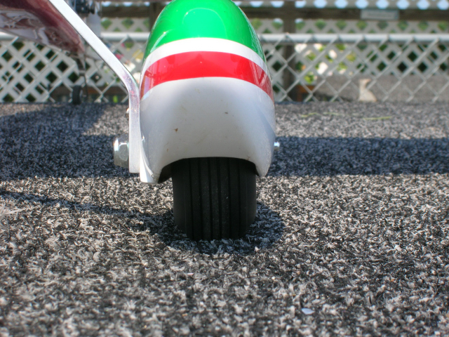

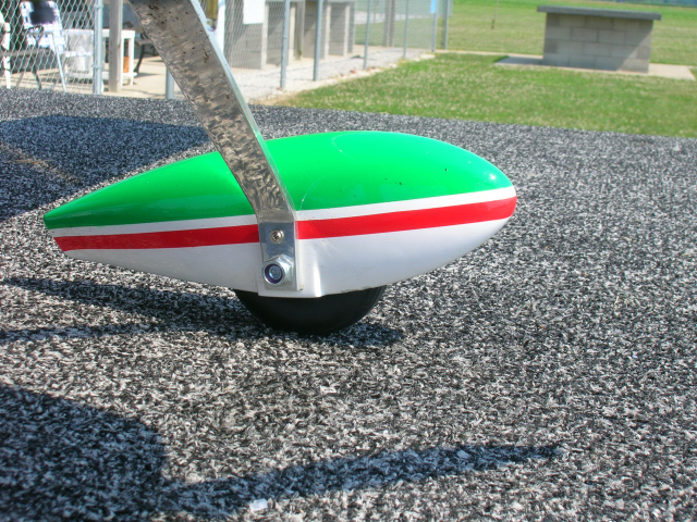

I have great news about the 90 degree copper elbow. When I got to the field this morning it was very windy and no one there but me and the runway. I left the settings where they were the night before when I was getting over 9000 rpm but it wouldn't run right so I tweaked on it a little and got 8800 on the top end and a nice idle at 2200 rpm so I thought that was good enough to try in the air. I taxied out to the runway and fired it up just to see how it would react. Everything looked and sounded good so I came back, got lined up, and poured the coal to it and was expecting it to go flat just after left off but it held the rpms and flew just great. Now, here was the test. I got lined up with the runway and cut the throttle to idle just to see if it would die and it held the idle fine so I did a touch and go and it climbed out with a lot of power. I flew 8 flights at around 7 min each and all were just as good as the first. Only one problem now, the choking method I had no longer works with the 90 degree elbow in place. Without being able to have my finger straight inside the stack where I can feel the fuel as I'm choking I don't know how many flips of the prop because it wont work by turning the prop over 4 - 6 times anymore. I was using my fuel tank to shoot fuel in the carb with the hand crank and flooded it a lot today and it took for ever to get it started. Thats ok....at least now when it does start its a screamer
. I had to change out the wheels that came with the plane because thay were all eat away on the inside and sloppy on the bolts so I bought new low bounce tires a little taller and wider and new 5/32 X 2 axles and now its nice and beefy.
