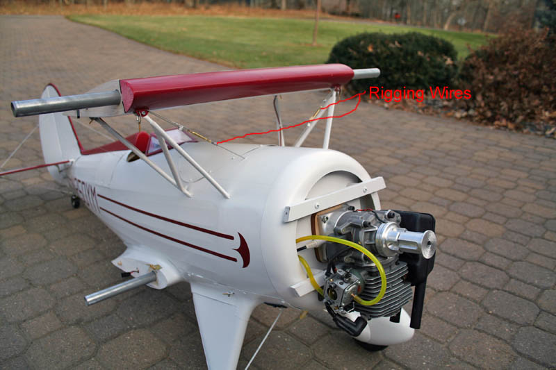

I started up the engine on my just finished quarter scale Waco today for the initial check before flying it for the first time. The plane range checked just fine with the engine off, but when we started the range check with the engine running, all the servos started to jump when the receiver was in front of the plane at 10-15'. The G62 has RCIGN's ignition conversion which never gave an oz of problem on the plane it came off of. I found by touching the rigging wires for the top center wing, the interference stopped, and would restart as soon as I let go. Any suggestions as where to start with trying to solve this issue would be greatly appreciated.
Notes:
The rigging wires do cross and touch in the fuselage.
Hitec 5645 with Futaba S3004 on the throttle
Futaba PPM receiver
Ignition battery 8-10" from receiver
Notes:
Futaba PPM receiver

You have already solved the problem. If touching the rigging wires makes it go away, moving the antenna most likely will not fix it because the RF still exists. On pull pull systems for Giant scale rudders I always place one wire inside a section of push rod tubing, that way the wires cannot rub on each other.
So I would take a piece of tubing and cover one wire right where they touch inside the fuselage.

Well, antenna location is the problem, I moved it out of the fuselage and the problem still exists. I'll try putting some space between the rigging wires tomorrow and see what happens.

Well, I'm not having much success, just lots of frustration. I epoxied the rigging wires on the top center section so they wouldn't rub and the interference is still there. It was 20 degrees out yesterday and prop wash on the hands was a killer, so testing was short. Removing the antenna from the fuselage didn't help either. The interference does increase with engine speed. I've done a little searching and found several comments regarding the rigging acting as an antenna creating interference on a biplane, and that a PCM receiver should be used. The supplier of the plane also said to use PCM. I've always tried to eliminate interference and fly a plane with PPM before switching to PCM, but it's starting to sound like that might not be possible. Does any one know much about flying wires causing interference on biplanes?
I've got a few more things to try yet as the process of elimination continues.

Switch out the conductive rigging wires for Kevlar rigging wires.
Running metal, or other conductive material, rigging wires is asking for trouble. The radio waves and the RFI from the engine will be reradiated by the wires.
Also, the original signal from your Tx will be reflected multiple times (multipath in radio jargon) and will confuse the decoder in your receiver.

I was at an IMAA fly in where a modeler had the same trouble with a 1/3 scale Sopwith Pup. He had changed to a PCM receiver and claimed he solved the problem.
On his first flight the receiver went into PCM hold and he lost the airplane.
If you want to fix the problem change to non conductive wires.

Yes PCM can help. The trouble is you never know if it will help enough. If it don't then you have a real problem. its better to eliminate the problem if you can. Then use PCM.
The problem with flying wires is not shielding or reflections or multipath usually. They can be a problem but very unlikely.
The problem is vibration on the wires cause buildup of static electricity on the wires. This is the same thing as rubbing your shoes on a carpet. This causes a difference in potential between the wire and other metal parts. If this wire and the other metal parts are in intermittent contact there will be sparking at the contact area. You will not see it but your receiver can hear it.
The cure is to isolate the parts with plastic connectors, or bond the wire securely to the other metal part, or use non conductive flying wires.
This problem can come and go depending on the humidity.

Well, my frustrations continue. The source of the interference is still eluding me and any more suggestions would be appreciated. Below is a list of what I have done to date none of which corrected the problem. Yesterday, I remove the engine and put it in a test stand. With the engine running, and the plane held a foot from the engine, there was no interference! This leads me to believe it is a vibration-induced problem in the remaining components of the plane, which there aren’t many.
Big Bird asked the question “Is the throttle push rod non metallic?” No it is metallic 6” long rod, but there is plastic clevis/ball socket on the throttle and a plastic control arm on the servo. Shouldn’t that be ok or could the metal rod by itself be a problem?
Chuck
By passed the switches for both the ignition and radio
Tried different batteries for both the receiver and ignition
Moved the ignition battery about 2’ from the receiver
Moved the receiver five feet away from the plane; this lessened the interference, but not much
Disconnected all the servos except the throttle
Disconnected all the servos except the rudder and manually adjusted the throttle
Switched receiver
Took off tail feathers metal bracing
Removed center upper wing section and rigging wires
Cursed
