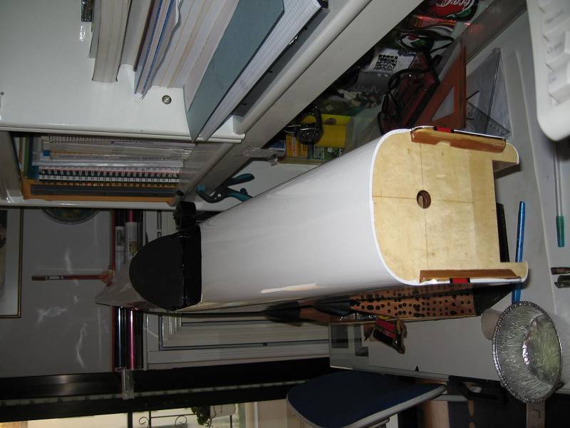

Hi Scott.
I sent you an e-mail regarding the 36cc,
but never (yet) had a reply.
Anyway,
now i wish you will answer my question.
I recently bought a Giant SuperSportster,
and i was looking for the 46GT.
But,
now that the 36cc came up,
i am thinking seriously for it!!!!![X(]
Question is how to mount the 36cc to my G-SS,
because the muffler is on the rear.
What standoffs should i use?
Do they come with the engine?
If you want to know the distance between firewall--->prop hub let me know.
Regards,
Kostas

Hi Kostas,
I did answer your last email. Not sure what happened. I think the 36 may be better for that plane because of the reduced weight. What is the distance needed on it? The 36 has its own mounts with it.
Scott

Scott he needs 7.25 from firewall to propwasher...
Plenty of room for the muffler behind the engine and still have space vetween it and the firewall...

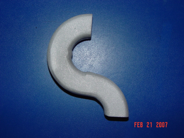

Mark,
It had responce that was faster than any engine I have ever ran. RPM was only a littl ehigher, but the header was way too short. I ran out of round tubing so I could not make it as long as it needed to be. I am going to remake it longer and cut to tune it. If I see a 300rpm gain I will be happy. That seems to be typical. But like I said, the responce was instant. Here is a pic of the header before the flange or round tube adapter is put on. It is 1" square 90deg angles I weld together.
