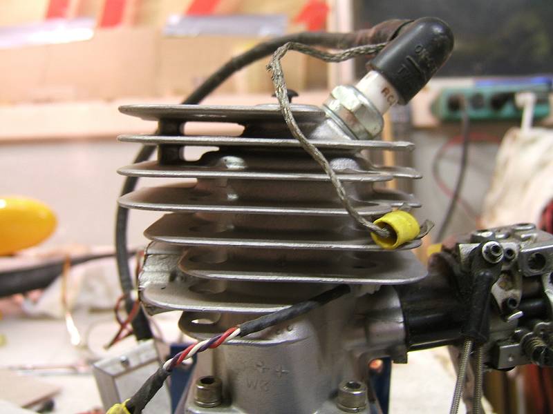

i need help,i have a Taurus 52 with a CH ignition both new,i can't get over ten feet away from plane while it's running with out everything going nut's,that is with a Hitec 8 channel PPM rx,and when i switch to a Futaba PCM rx all is good over a 100 ft. away before it goes into failsafe.i went through everthing i could think of,there is no metal to metal any where,throttle servo is 10" away from engine and nyrod between servo and throttle arm with nylon clevis both ends.
the ground for ignition came with a eyelet that is ground to engine base bolt,does it half to be clamp to spark plug?the ignition has the rubber boot type over spark plug. there is 12" between rx, switch,battery and any ignition componets. this is the first time i had any RFI problems.
all idea's are welcome,THANKS!

Inside the rubber boot that fits on your spark plug there is a metal cap the fits over the stem on the spark plug. Make sure that cap is a tight fit on the stem. Any slack there can produce a lot of RFI. If you have to squish it with the pliers but not so hard that you collapse it.
Also the stem has a button that screws on the stem. Make sure that is screwed down tight
Are you using a resistor spark plug? It should have an R in its number.
If the plug wire has a pigtail coming out of the plug wire next to the rubber cap, that should be clamped to the spark plug with a hose clamp
I'll go along with most of what Dirtybird related. The engine mounting lug may not be a good enough ground. In testing the wire polarities of the new ignition on a T-52 I noted that grounding at the engine flange bolt did not provide a good ground. That's prolly what's happening with yours. Grounding to the case directly did provide a good ground, but there is no means of attachment. You could also drill and tap a small hole in the top fin of the cylinder to attach the screw. Go slow.

Thanks for sharing that. I'm another that does not like clamping additional items to the plug. For those that have or had the older Brison engines using CH ignitions, you may reacll that the plug leads all had that same grounding lead with the wire lug on the end. You may also recall that the head of the engine was pre-drilled and tapped by Brsion for you to attach that grounding lead. It always worked. This is the reason I suggested doing the same with the newer engines that come with the old style CH systems.
Those that have their reservations about grounding leads, clamps, or drilling and tapping a head could contact CH and order one of the newer systems with the different cap, eliminating the ground strap.

Would posting a couple of pictures of the different caps, with and without ground wires help? I have several ignitions of each CH type but not all are mounted at the moment.
The first picture is a Taurus 3.2 with a CH ignition using the Bosch Cap. FYI, the engine does not come equipped this way, but with the rubber cap and ground wire.
The second picture is with an older Brison 3.2 and the originally equipped ignition. Rubber cap and ground strap. You can see where Brison manufactured the engine with the head drilled and tapped to accept the ground strap. If you have a head that you want to drill to affix the strap, DO NOT DRILL THIS LOCATION! It's directly over the combustion chamber and a depth mistake will be an expensive disaster!
The fourth picture shows an "X" with a pencil pointing to it. This would be one of the acceptable places to drill a hole since there is nothing under it to be a problem. The next picture provides a side view of the open space under the top fin.
The easiest way to do the job would be to drill a small hole the size needed, run a short #4 or #6 screw (depending on the size of the wire lug you use) from the top, and secure under the fin with a flat washer and flat hex nut. Use some blue Locktite on the hex nut, making sure that you do not get Locktite under the lug for the grounding strap, thereby maintaining a good ground contact. Take your time and things will go well.

Clamping the pigtail to the spark plug base may look crude, but from an RFI standpoint its the best way to do it. You want to get to the ground the shortest way possible. It won't come off if you clamp it down hard.
My Feedback: (198)
Posts: 6,707
From: El Reno, OK
Yep. I've clamped CH ground leads to plug thread faces for a long time. Very effective. I found I had to use a properly-narrow hose clamp; if too wide, it would interfere with the head, and not tighten properly. Yes, you *may* ask how I found that out......

well i am still having trouble,i clamp the ground wire to spark plug and it is a little better i get about 40 ft. away from it now before it starts to glich,i ran the antenna wire outside of plane just incase that was it,i will start to look at servos,only four in there now two for elavator,rudder,throttle.and i did switch rx also, still the same.and i am going to double check all nut's and screws for tight fit,i am glad for all the help you guy's are giving me!
