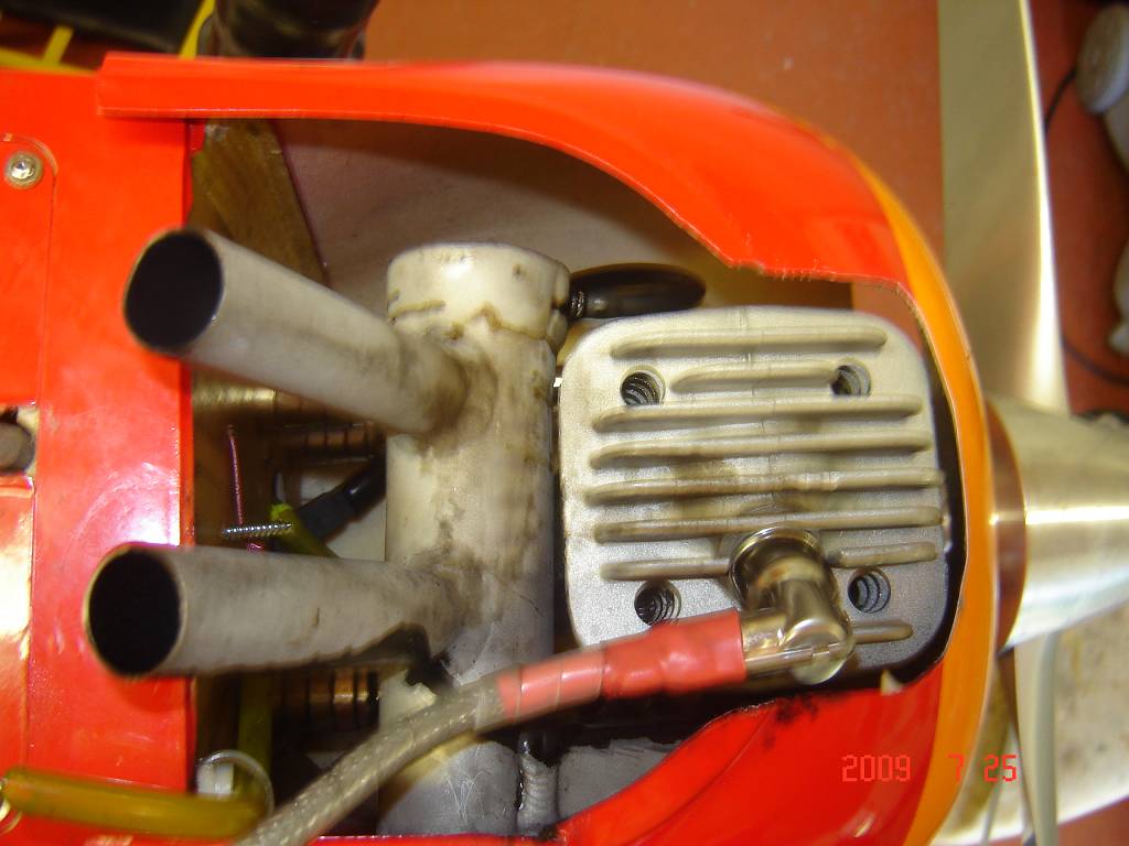

My DL-50 idles great and high end is smooth at full throttle. Fully broke in. It gurgles badly at above mid range and the plug is oily and has carbon on top the piston. The engine runs fine and has not stopped running because of fouling. It is pretty hard to start when hot. I figure the plug is fouling at starting. I am using Bel-Ray mc-1 full syn. at 50:1 ratio. I replaced the stock plug with the NGK-cm-6 but it got oily too so i put the stock plug back in after cleaning. Could someone give me a simple way to lean this thing out? Repeat. Please keep it simple. I don`t want to screw it up and ruin the engine too lean. Thanks guys.

Turn the low needle CW until it won't transition anymore. Then back it off CCW just until it will transition again (but a very fast transition). Your low needle will be perfect at this point.
Check your peak RPM. If it's holding a steady RPM for 5 seconds turn the high needle a little at a time CW and watch it gain RPM. Keep going CW until it won't gain anymore RPM. You should leave it the point of where it just starts to not gain any more RPM. Your high needle should be all set.
The high needle is furthest from the cylinder head. (Edited).
PS: As long as you don't run your engine wide open for more than 5 seconds or so you won't ruin it.

Valve floater, From looking at your picture is appears that your muffler is right up against the back of your engine and may be blocking the airflow on the backside of your engine. This could drastically effect the performance of your engine. I would seriously consider, if you have the room, to somehow move the muffler away from the cylinder head. If you have a hot spot on the backside of your cylinder it could distort the sleeve and burn up your engine. At the least it would make it hard to set your carb needles for full range operation. Just my personal observation.
