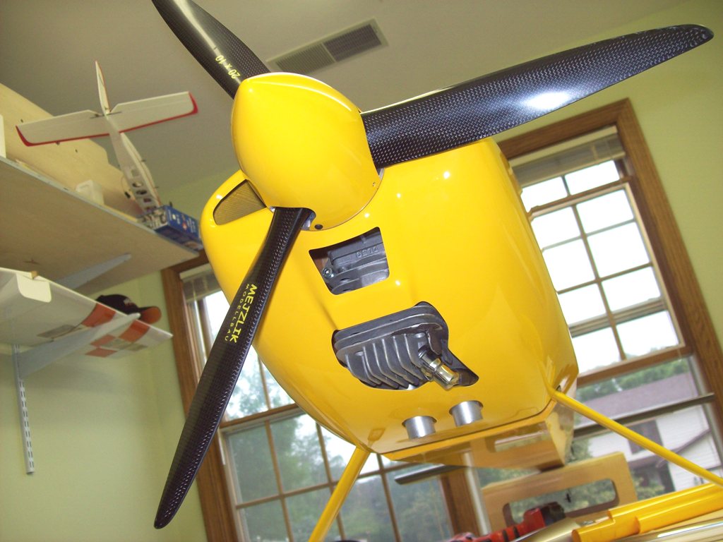

ORIGINAL: We3R/C
Hi, New DL-50 owner here! I have a question: What size are the threads on the Hub? I am looking for a Spinner, and can't seem to find the spec's. What Muffler do ya'll like over stock? (looking for Pitt's type) Thanks~Mike
I like the Slimline. The JTech is similar, but the part of the muffler where it bolts onto the engine is smaller on the Slimline than on the JTech, so it fits inside the cowl. Also, the Slimline is a much nicer piece. I don't want to badmouth the JTech because I'm sure many use them and they work well, but it looks like it was made in a guy's garage. Of course, the Slimline costs more than the JTech.
I also like to apply aluminum tape inside the cowl around the engine and exhaust tube openings.

krproton
I admire your clean set-up. Nice job. But there is one thing I noticed i would correct. I would put a piece of foam under the ignition box to prodect it from vibrations.

It may just be the angle. He had foam under it before.

Thanks thevirginian.
There is a thick film of RTV silicone rubber on the bottom of the ignition box and the plywood mount to absorb vibration. This has been working for last flying season and this season so far. Do you think this is sufficient?

Krproton,
Which spinner do you have on your plane? What rpm are you getting with that prop?

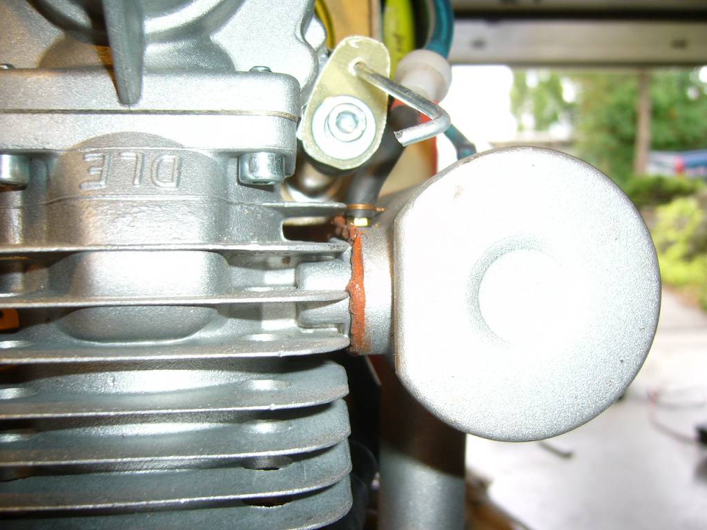

Here are some pix of the muffler install. The first shows the muffler before I pulled it off to check the exhaust port. the second shows the two mating surfaces. It looks to me like the film of sealant is so thin as to be almost transparent, except where it oozed out to make the "bead". I have used the Permatex Ultracopper but did not see much difference in the consisitency or result. I have gotten a lot out of this discussion, especially the idea of using so little of the sealant. Much less than I would have used before. I'm going to redo the muffler again, and use less sealant (Permatex Copper this time). Thanks to all.
Sam

You can wet sand the muffler mating surface on 400 grit and get that baby almost machine surface flat. Then it will take even less sealant. I like the Yamabond 6B. Great stuff made especially for exhaust app's.

Hi Krazee. It's a pre cut Mejslik carbon fiber spinner. I have the same one on my Edge too (only it's larger). It's a nice piece, but had I known the prop cutouts would be so large I would have done it my self (but it still looks good). Sorry, I don't know the RPM I'm getting. It's a 20 x 10. I'll be flying this weekend, so if I remember I'll try to get a reading for you and let you know later. The thing runs real swell though!
+1 on the Ultracopper RTV for me (I think it's even in the background of one of my previous photos!). I always "polish" the mating parts of the muffler and engine port with oil and 400-grit, then thoroughly clean with denatured alcohol. Just a fine film of RTV on both parts, then bolt it together.
