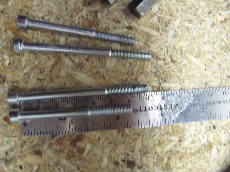

That velocity stack sure looks like the one from Horizon Hobby for the Zenoah 20 or 26. I don't think the bolts were long enough on my engine to go thru the stack mount. Can't remember. CRS is kicking in hard.

where do i get the velocity stack from ? what is it supposed to do? if i put that on, does it need to clear the firewall by 1"?

ORIGINAL: hillbillyexpress
where do i get the velocity stack from ? what is it supposed to do? if i put that on, does it need to clear the firewall by 1''?
Valley view, maybe Horizon
Help improve performance and fuel economy
Cut a hole in the firewall
JoeAirPort answered this same question for me two pages back .Due to my motor box being so wet all the time I will probably be giving Jodi a call next week to order one.
Joe Airport's answer:
Jody has them at ValleyviewRC.com. He can tell you how to mount it. It uses the same two bolts that hold on the carb and reed block. Mine kept changing mixture in knife edge and inverted. I put one on 50 and 55. Works great. The fuel getting all over the engine box was not the reason I installed my first one. Although having it go bone dry once the stack was on there was a great side benefit.

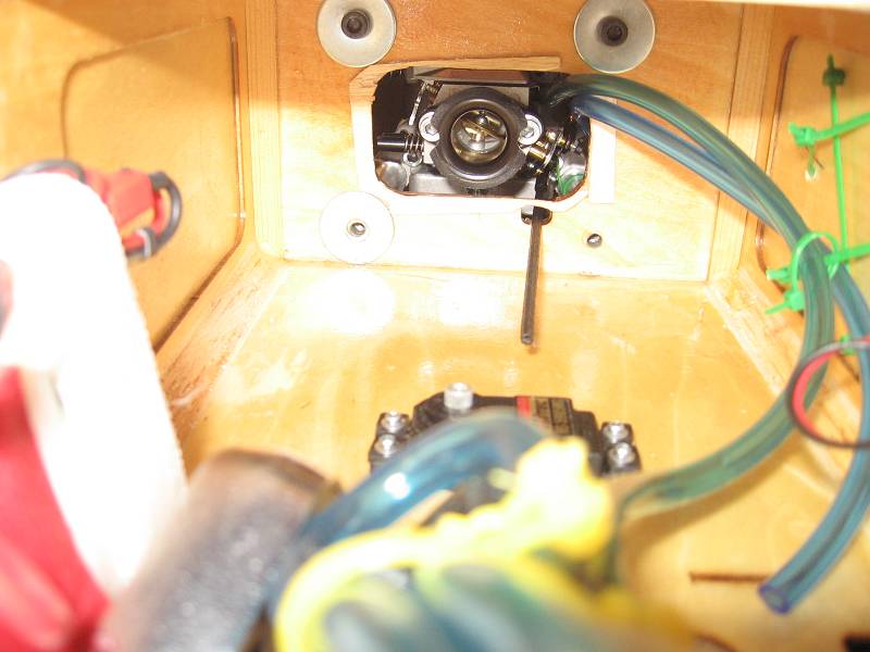

The stock bolts work but are a tiny bit short IMO. Be careful though, if you cut new ones and they are too long they hit the crank counter balance which is right where the bolt ends. Don't worry though, you'll know right away because the engine will be totally locked up. You only need a couple more mm than stock the bolts. The stack is about 5mm thick plus maybe a mm for a lock washer but the stack and washer will compress a mm or two. Use a little lock tite and the stock ones will be fine.
If your only issue is fuel/oil getting all over the inside of the engine box you can put a balsa sheet over the inside of your firewall with thin CA. It's super easy to do. Look at this picture and you can see where I had the balsa sheet. All you have to do is hold it in position with your left hand and start to apply thin CA with a dropper with your right hand (through the hole in the firewall) where it comes in contact with the inside firewall. Just make sure you have enough room behind the air inlet of the carb to keep good air flow. With the balsa sheet on the inside firewall it gives you some extra space.

So what you're saying is that the bolts need to be 5x65mm? Where did you get the longer bolts from? I recently ordered some stuff from RTL fasteners which has been shipped already so can't add to the order.
I need to place an order at Valley View so will include 2 stacks.

ORIGINAL: mstam1971
Martin I didn't actually measure them when I was done but I first cut them down from 70mm to 65mm. Then I had to trim them down a few more mm since it was bottoming on the crank counter balance. What you can do is just get them 5x65mm and trim them down with a dremmel. It's easy enough. I'd say more like 62-63mm.
I got mine from Fastenal.
These would work:
http://www.fastenal.com/web/products...0135910&ucst=t

How about buying the longer bolts and cutting them to the length of the original bolts plus thinkness of the velocity stack?

ORIGINAL: PlaneKrazee
My previous post discusses exactly that. Get 65mm and trim 'em down. The stocks are 60mm.

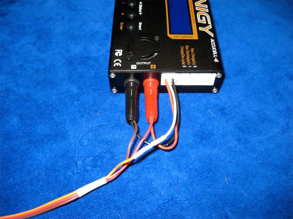

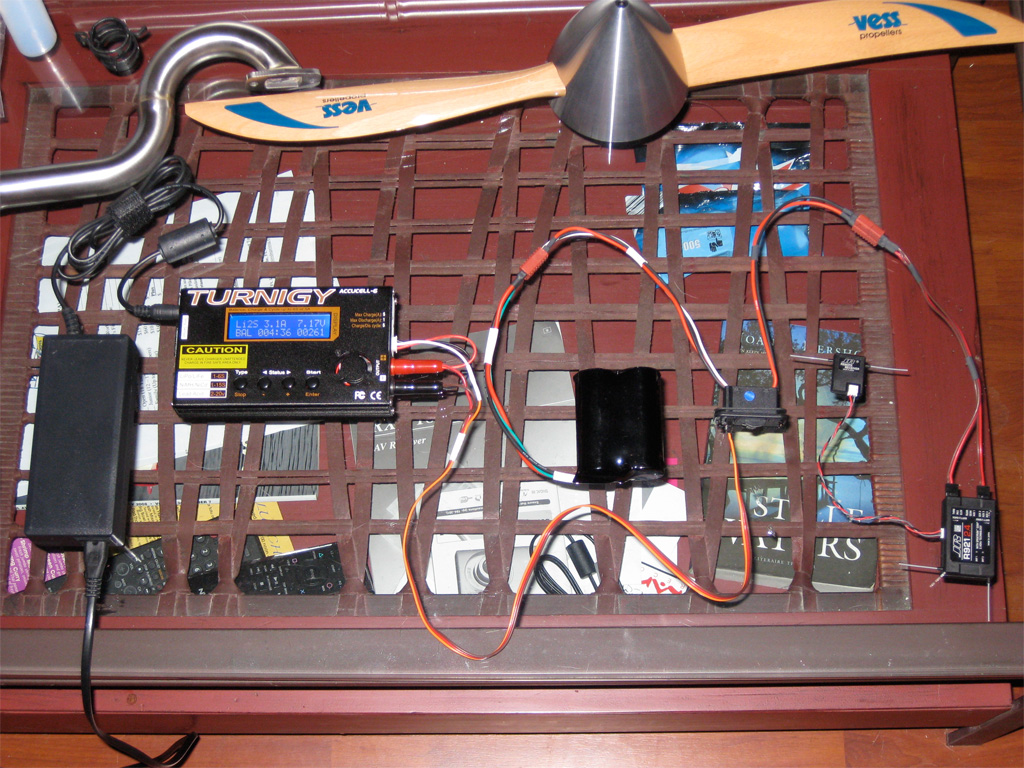

The images show the setup I'm using for my 30% EF Extra. One 2-cell 2300mah A123, good for 5 15 minute flights. I used the Ultra Switch II from Electrodynamics and I can balance charge through the receptacle. ED now sells batteries and switches that match, the ED-nano series. Nice company to deal with and their ignition cut-off is great too.
If you want more than 5 flights, consider 2 A123 batteries and the Fromeco Wolverine switch with 2x 16AWG in and one 16AWG out. Solder a Deans to 2 servo wires that go into the receiver, good for 8 A continues w/o voltage drop, much more peak.
Only for 35% and up you need a distribution system. Most receivers can deal with peaks of 30 A.

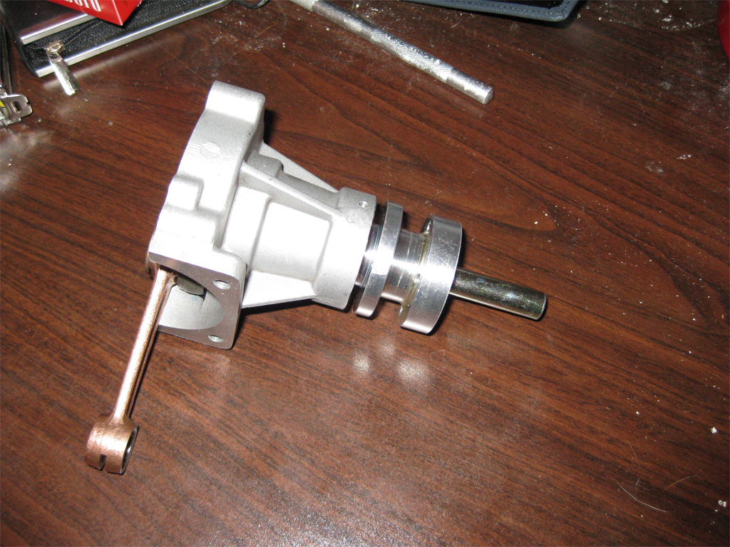

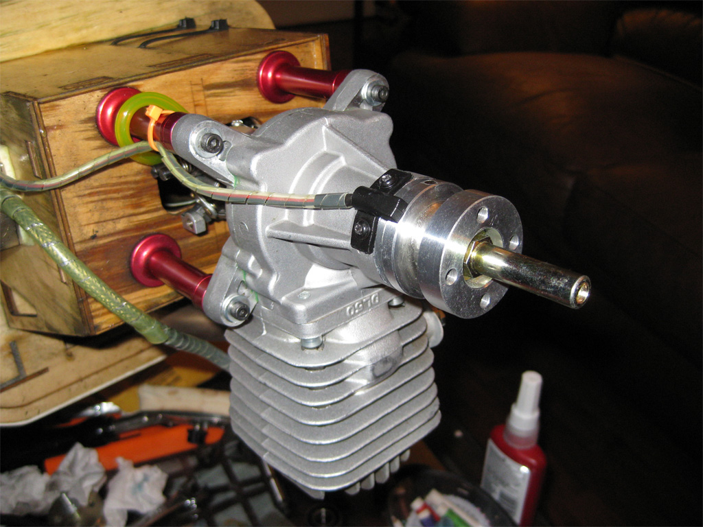

Way past bedtime but it's back in one piece so the crankcase sealer can dry overnight. Hopefully not too windy tomorrow.
The rear bearing and the prop hub were the toughest to put together.
Special thanks to Jody for shipping the parts out so fast.
