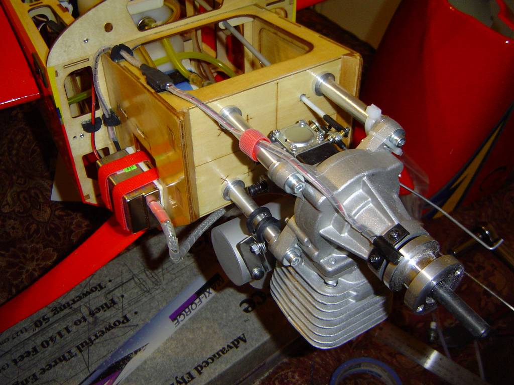

I'm wondering if some of you would be so kind as to post pics of your engine installation showing how the throttle and ventilation door controls are hooked up. I have a DL-50 that might be about 18 months old, and I am just now getting it installed in an Extra 330L that also is that old. This is my first gasser. I actually have seen a few pics on different posts, and in one I saw a guy hook up a manual pushrod for the ventilation door. On another pic, it looked that there was nothing hooked up to the ventilation door. That leads me to the question on whether it has to be hooked up at all. Seems it would vibrate any which way though, if not hooked up to something positive. Attached is a pic of my engine just in case there were different versions. Thanks guys! Jon

Here is the simple solution to your problem. use the new ZDZ carborator arms with the ball link attached to a nyrod. This is the easiest way to hook it up. The red nyrod runs even to the firewall and then the yellow inner rod comes out. All you have to do is use a 4/40 threaded stud from sullivan and thread in in the ball link and then in the yellow nyrod.
If you have a 4-40 tap you can start the treading process in the yellow rod with that. The link will show you the two size arms. the small is for the choke and the larger one for the trottle.
STILL hopin some of you can post some pics of your linkages to the engine to help me along on my first gasser. I want to see how you route the throttle linkage to a servo, and what you have to do on the manual ventilation arm. Thanks! Jon

Do you mean the throttle arm and the choke arm.
For the throttle arm, just remove the arm on there now and use one of the blue Hitec servo arms turn it 180 dergress and your good to go.
The choke depends on wether your going to use a servo our manual

Thanks n57tc! Those pics are worth thousands of words, really. I started from page one of this super long thread and gave up after 20 pages of looking. I bought two small metal gear servos for my throttle and kill. I just need to set up servo locations and control rod linkages to the throttle and choke arms on the engine. I'd still like to see someone's setup for those servos if anyone has pics!!! Thanks. Jon
PS: OK, I found more pics in this thread way back when. One thing I notice is that folks have only set the choke up for manual operation. Does that mean nobody uses it for killing the engine? Is everyone going with an electronic kill, if that is the right term. Jon

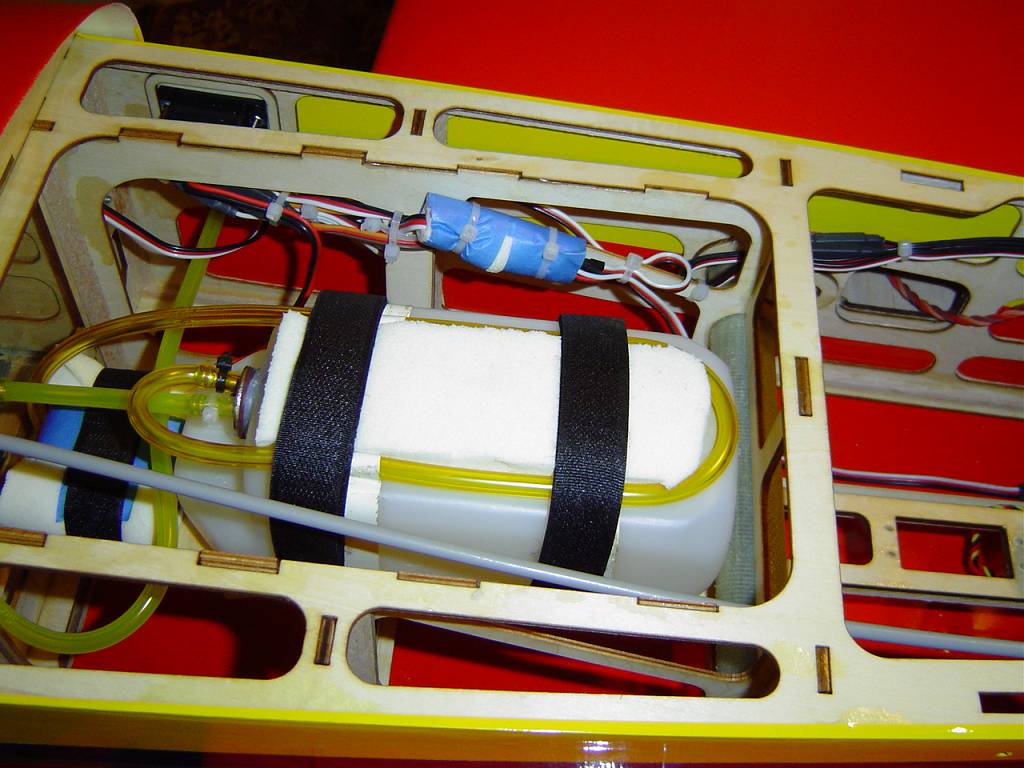

Jon I use an electronic kill on my engines unless for some reason I cannot use a manual choke. Then and only then will I use a servo on the choke and leave out the electronic kill. Here are a couple of pics for you.
